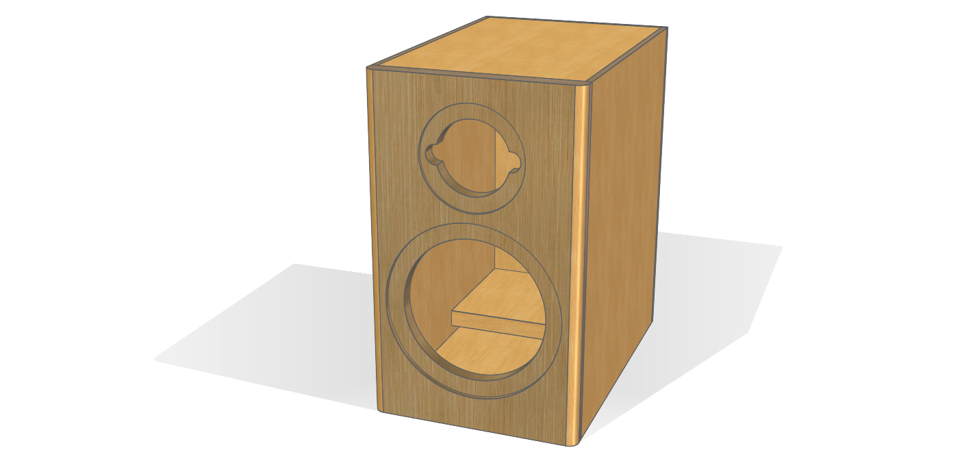

Just copy the placement I linked for the core 2-way, 3" from top for tweeter and 9" down for the woofer both centered. Baffle should be 8-1/2" wide x 14-15" tall and then as deep as you need to make 0.50/ft3, probably 12" give or take. I know you use MM but you can convert easy enough I hope.
What's MM exactly? I have a box calculated already so don't worry about that. As long as the spacing between the tweeter and woofer is exact, the sound shouldn't differ. I've already gotten into production with my box so no hell hole way I'm re-bothering that person.
Separate post for le render!

Box looks good, you want as little space as possible or reasonable between the Tweet and Woof. Also not the same distance from side to side and top on the tweeter. Looks like you have all that covered. MM was supposed to mean mm (metric) oops.
I just used 3" and 9" like the Core2 haha. The core 2 trades the extra bass for a lesser midrange response.
