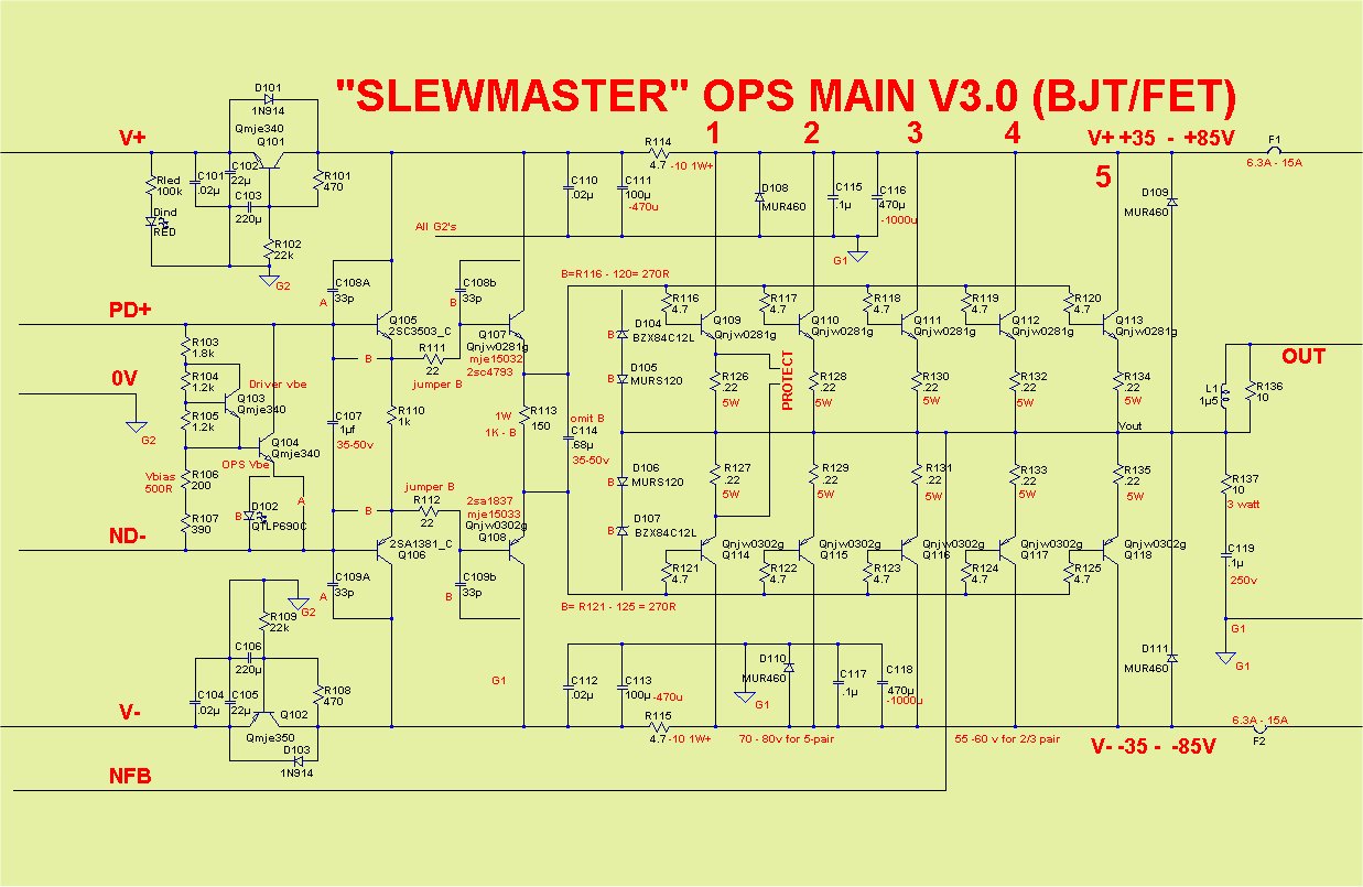

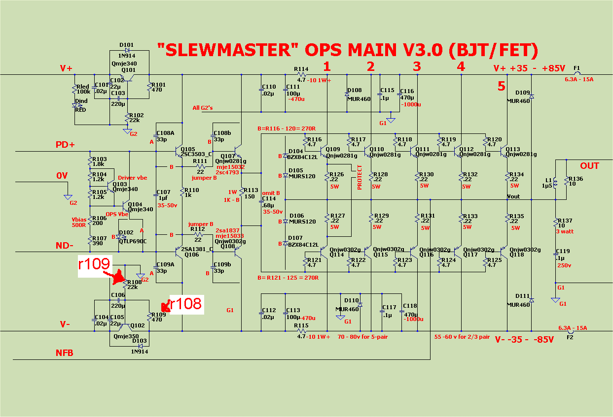

excuse the rough drawing...does this make the schematic jive with the board?
and thank you Terry..
Hi Pete,
Thanks for the corrected Schematic. If it's OK I will post that in the build thread too.
Blessings, Terry

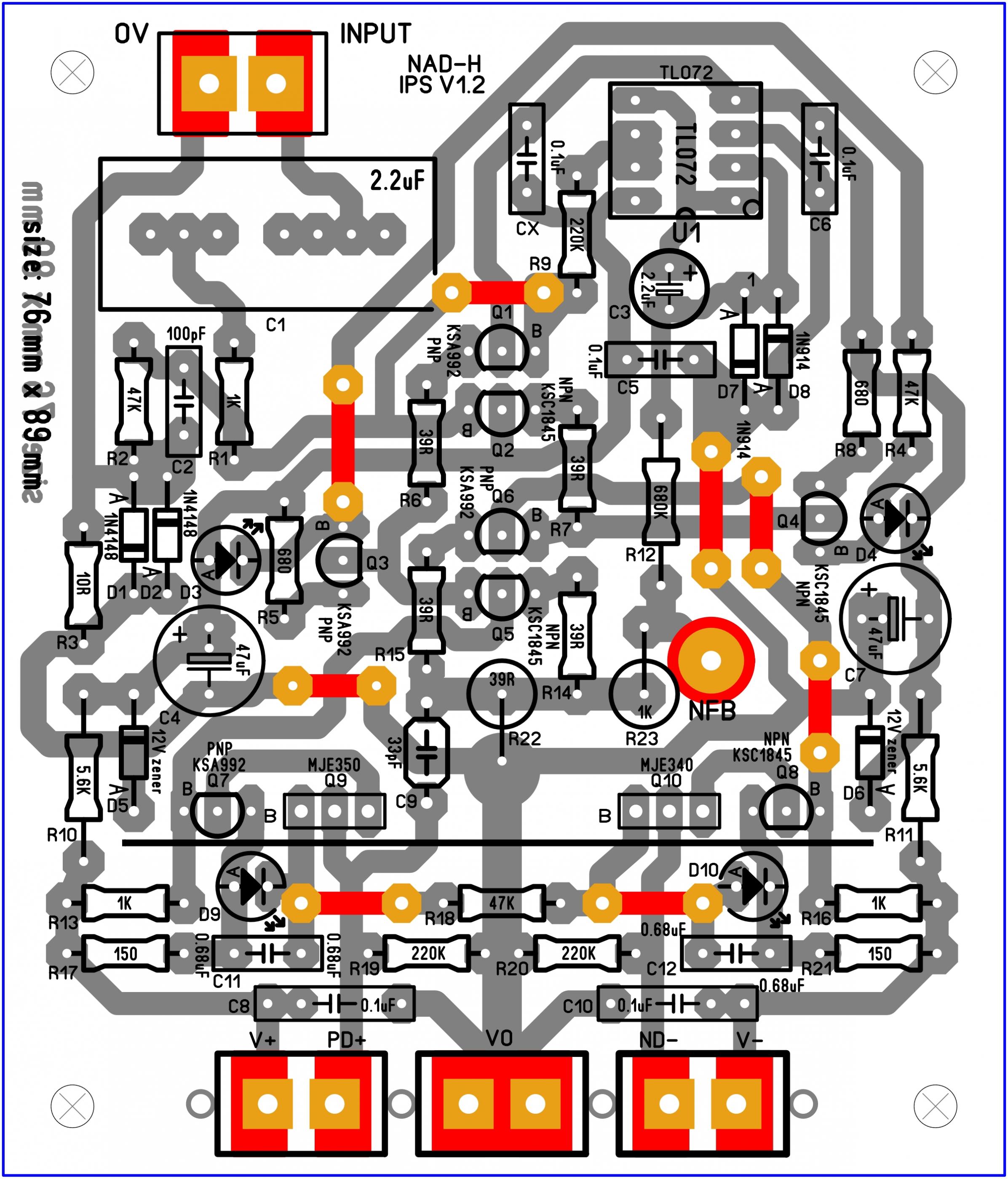

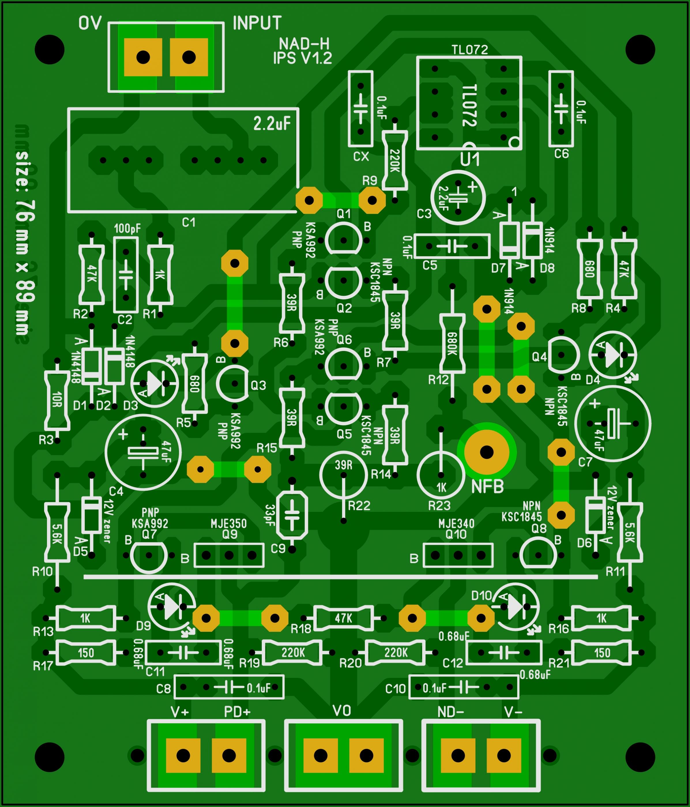

I have one of the original NAD-H that OS design and I have the idea about the jumper having them as "through pad" so if the PCB is order it will have solder both sides where jumpers are and just a little spot of solder to them so it will flow both side making a strong connection I just have it the idea to share here "I just thought about it today"
