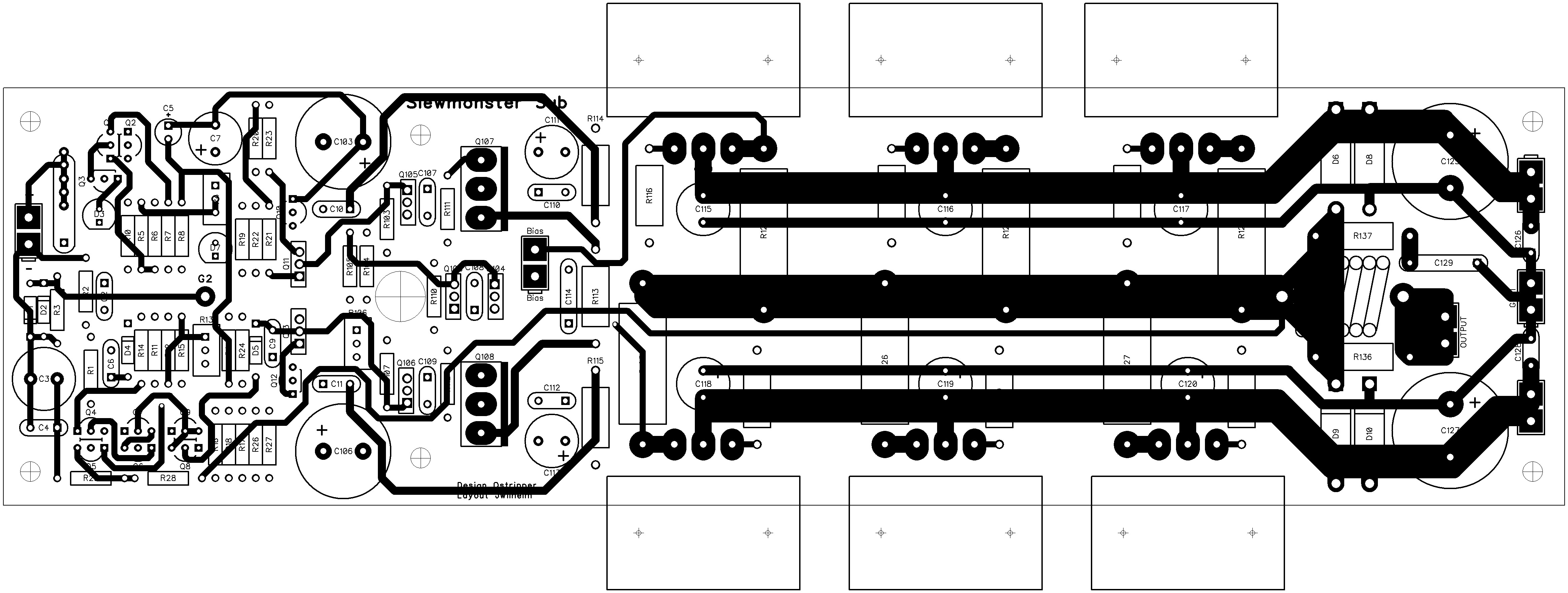

I wouldn't mind etching it. While I love to work with pro boards, I also like etching in the morning and testing that evening.![]()
SMD will test you etching skills. You should use 1/2oz copper. The traces are narrow and squeeze through some very narrow areas but I've had good success with it. Liquid tin is a good idea. Solder bridging is more of an issue with home etched boards though.

I still need to pick out some transistors for this one. All my stock is for 12V circuits. I'm loaded up on BC846/856 and MDJ340/350 but would like to go with something better. The footprints are all the same with SMD so designing is easier.
My only concern on these is the 1W resistors. I'm paralleling 2512 1W resistors for all of them. R12/13 and R16/17 might see some 3W peaks with high rail voltage so not a huge problem but I don't want R14/15 browning the boards.
I don't know what composition is acceptable for film caps either. Is Polyphenylene Sulfide (PPS) a good replacement for Polypropylene?
Electrolytics are smaller footprint and cheaper in through hole and don't get knocked off the board as easily so that's a no brainer, but need to be on the opposite side of the board for single side etching.

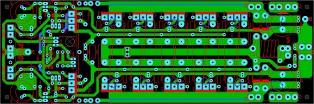

Here's something that has been bothering me about these output boards since I first saw them. I think the cap connections in the purple circles are wrong. Current is entering the cap, then needing to reverse direction and exit the same way it entered. This doubles the amount of current flow on that trace. I know the trace is extremely oversized for what it is carrying but my thinking is these traces will be producing EMF at double the frequency the output devices are outputting. 2 sets of 5 cap traces plus the two big cap traces emitting noise just seems like unnecessary trouble. I read a couple of Randy Slone's books years ago and he mentioned this. It's something that I've paid attention to ever since.

The bigger caps could likely be omitted completely, but the smaller ones perform decoupling at the transistor collectors and are almost certainly necessary for stability.
If I were looking to make a change I would consider forgoing the higher value at the power inlet and go with larger ones at the individual output transistor collectors. Done that way I would make a beefier ground return for those large decouplers.
Wether the existing arrangement is actually an issue or not is debatable, but my gut says it probably isn't an issue. What I would consider is making the MOSFET 'option' official and make provisions for the gate protection and bias modification on the board with the SMD pads for easy jumpering of optional components. Just my own thoughts on it.

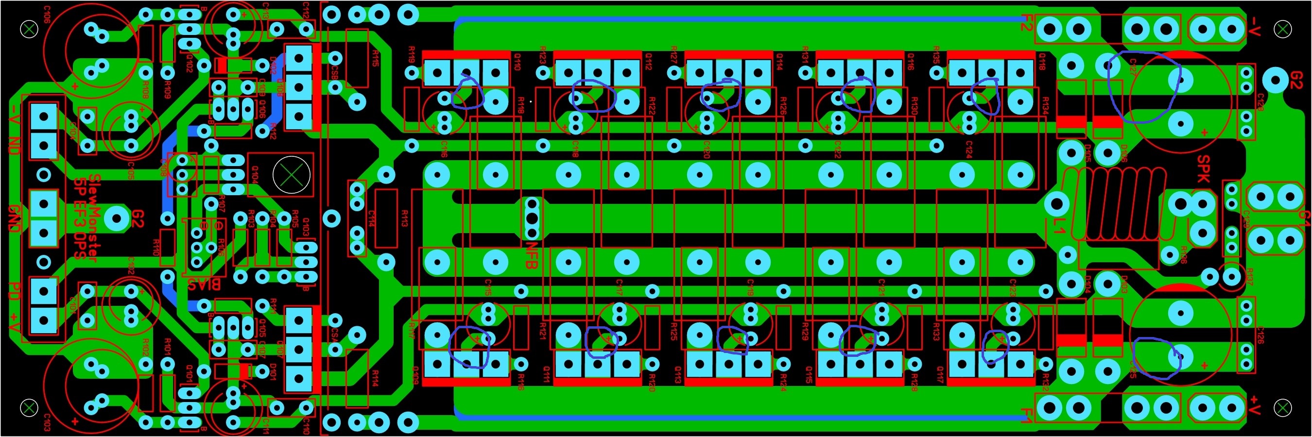

I changed the layout a bit when I did my sub amp boards. I don't have two options for the RE resistors but I moved the rails inboard of the output devices and did install larger decoupling caps at the outputs. I was debating installing 10000mF snap ins at the inlets but they would have been too tall.
I was discussing output inductors with AndrewT yesterday. He recommended getting the output inductor off the output board too. He suggests putting it midway of the speaker output wire away from everything. I was debating putting it on my speaker relay boards at the binding posts.

If you could make it so you can just edit the number of output devices that would work out great. I can see how small it would look with one or three output pairs and the only thing that changes is that center section. Now everything and the input section on one board with variable output pair's is the ticket.
On the output coil what distance is really good, how little does it really have to move away to have an effect?
I think the coil position is going the depend on the application. It's going to emit noise 13 or 14 (or how ever many turns it is) that the speaker wire does so I think the key is to keep it away from signal. AndrewT's other point was to keep it away from a metal chassis so as not to induce noise into the chassis ground.jwilhelm,
