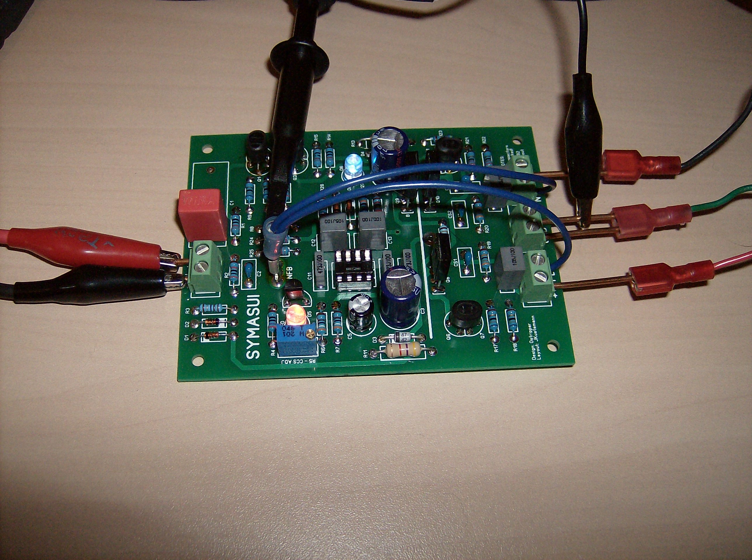

Beautiful work ,congratulations!Got a Symasui board stuffed today for QC check. Looks good so far, just need to get an appropriate op-amp for the servo tomorrow.
Regards.
Thimios.

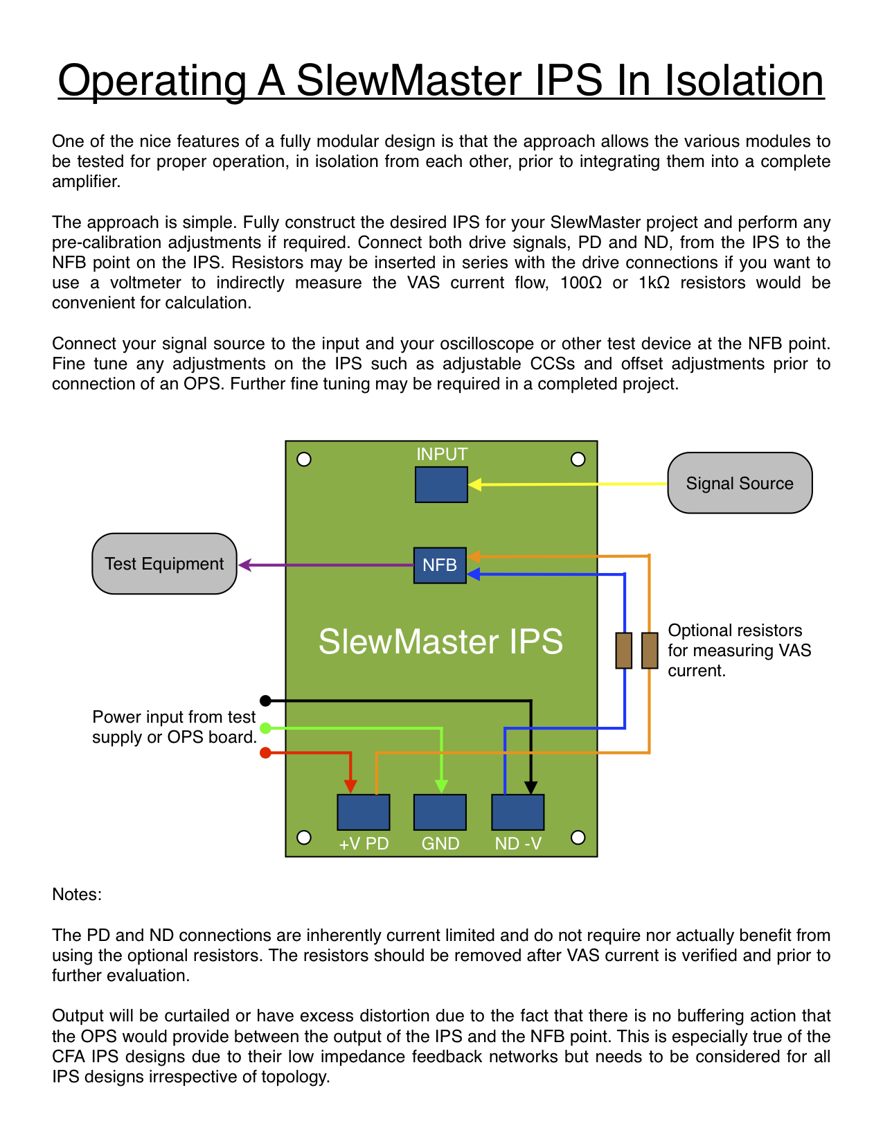

Hi Carl,
No, unfortunately. The IPS works stand alone, but when hooked up to the ops it goes crazy. Valery is working on a solution.
Thanks Jason.
The Low TIM hybrid IPS works using those rules. However it goes nuts once it is attached to the OPS. It is possible that I have done something wrong but I have checked pretty closely. Not sure why it works with Valery's ops and not the Slewmaster but there is something going on.
Sounds like some kind if instability going on between the IPS and OPS. I haven't looked too closely at Valery's IPS but I'll have a peek and see if just a compensation change might bring it into line. Of course, Valery's knows his IPS better than I so any suggestion he had supersedes mine.
@Valery - If you could benefit from a SlewMaster OPS board please PM me.

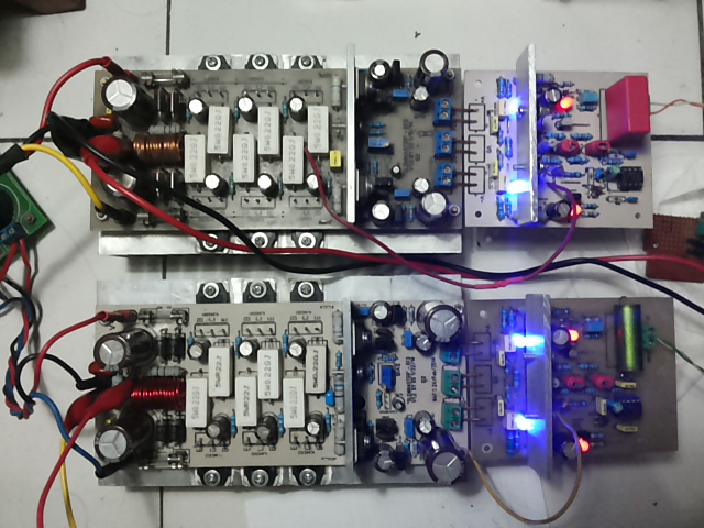

My stereo build of Slewmaster
Thanks uncle Os.. it'st rock
Beautiful!
