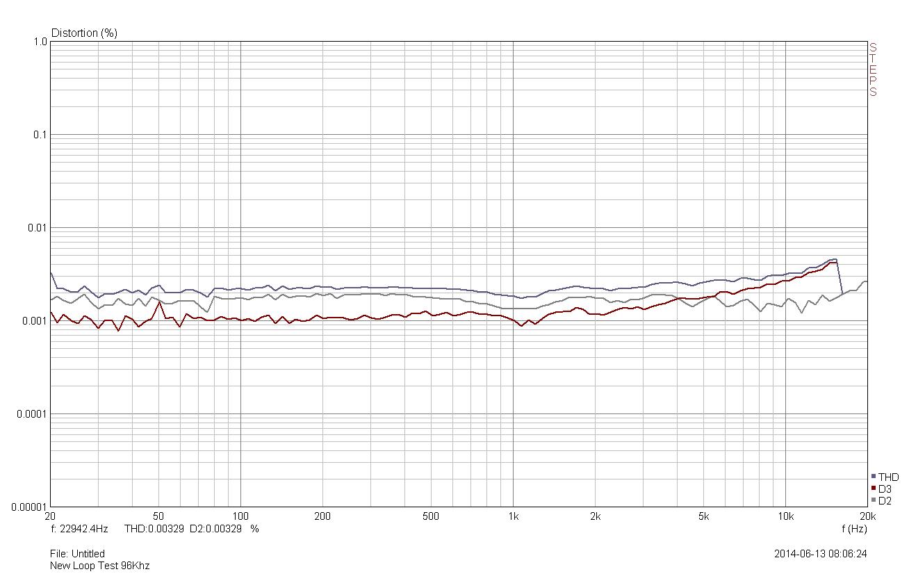

loop test 96Khz as required
Okay thimios, this gets both HD2 and HD3 about the same in level (what you'd more expect imo) and gives a good baseline for doing more measurements.
What BV was meaning is that the sound cards distortion is so 'high' that when measuring the amplifiers it should look pretty much exactly the same as the amplifiers are capable of much lower distortion.
If you get wildly different results then this is either due to bad amplifier implementation, or a problem with the measurement setup.
Thanks for all this effort.Okay thimios, this gets both HD2 and HD3 about the same in level (what you'd more expect imo) and gives a good baseline for doing more measurements.

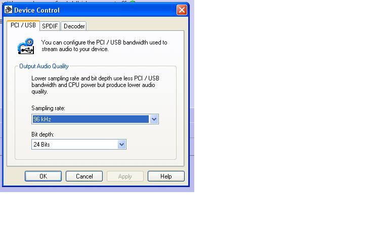

Can you post the recommended configuration diagram when ARTA software used?
Nothing special.. Loopback, signal from card output to amp, signal from amp output to card line input , via voltage divider at low impedance. Normal shielded cables, shield always connected at both sides.Can you post the recommended configuration diagram when ARTA software used?
It is good to find optimal level for card input / output for minimal distortion, and than keep signal near this level, if possible.
