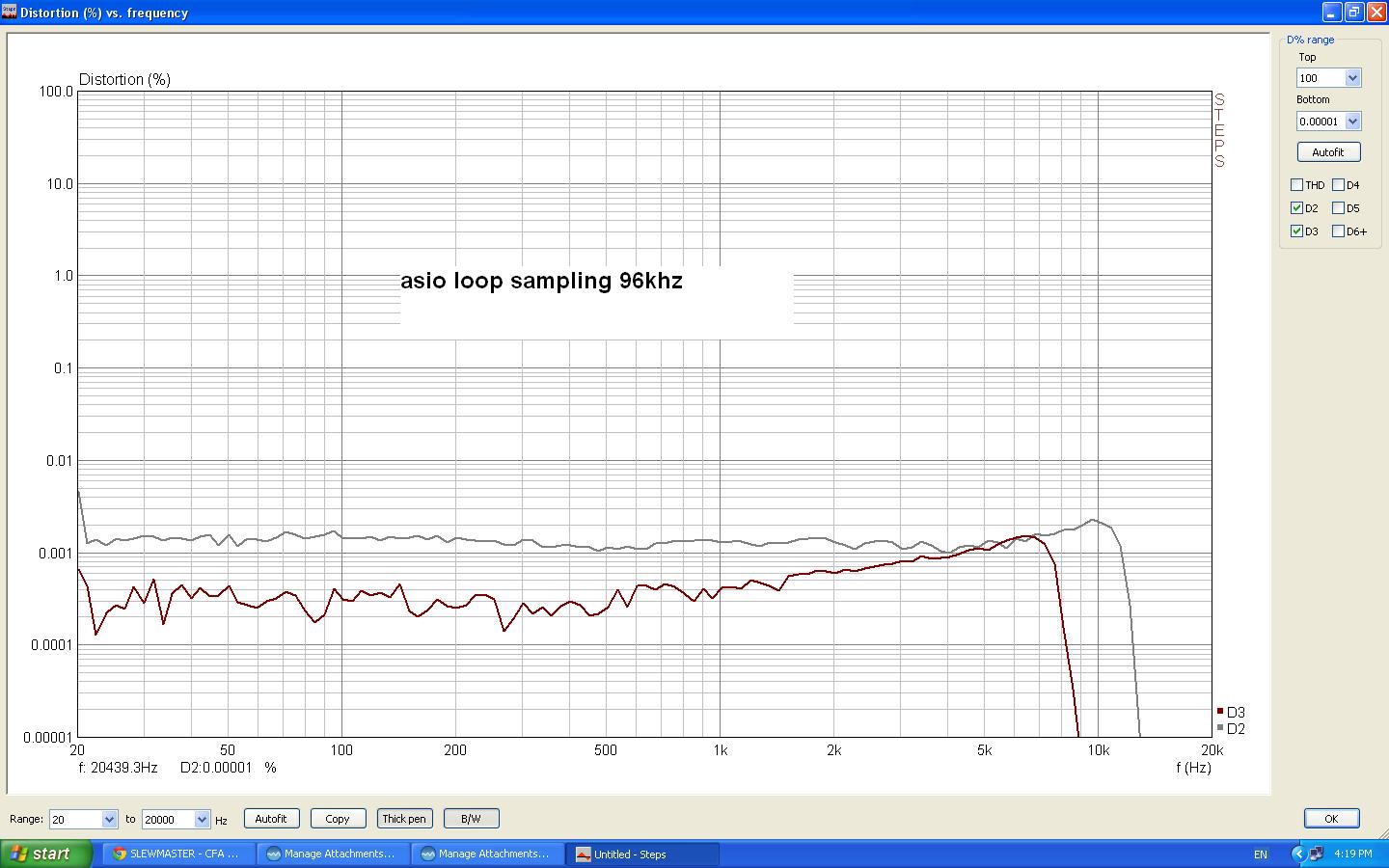

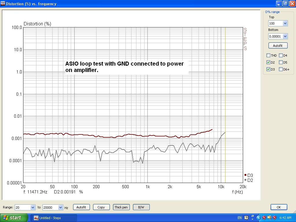

Here it isthimios
Try a loop test, as in #3092, but with connected loop shielding to amp GND..
Measure with Fs=192kHz , so you can see distortion artefacts to 90kHz and do swwep 20Hz-20kHz.
So try at least 96kHz.. Can you make spectra, 1kHz?

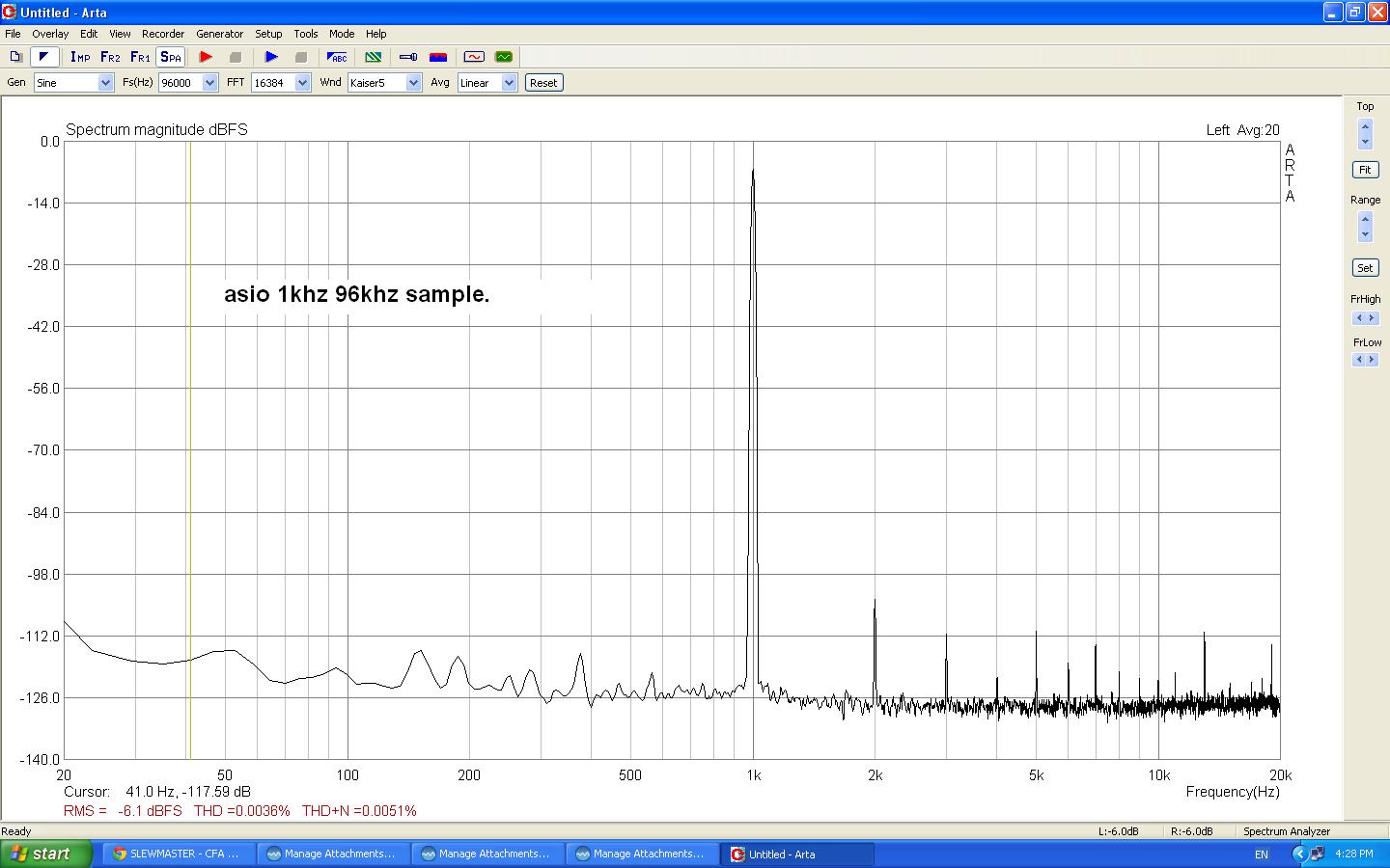

here: spectra 1Khz /96khz sample, loop test(asio driver used)

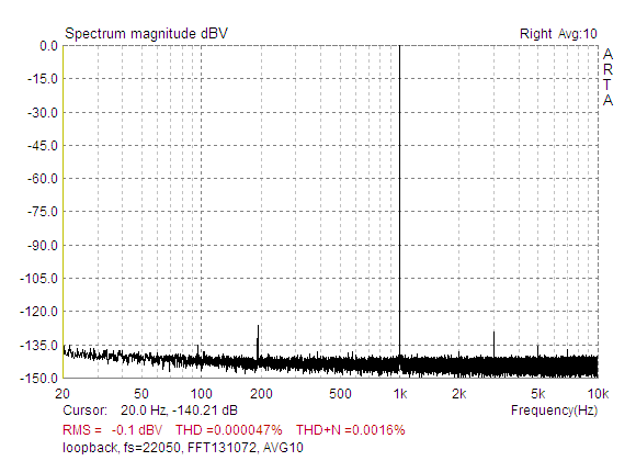

This card (too old type) is unsuitable for measurement purposes..If you want to make it serious, try to obtain e.g. ESI Julia, ,or XONAR ST..Not too expensive, but very good results. Card should be order of magnitude better, than measured device. Loopback should be something like attached picture.

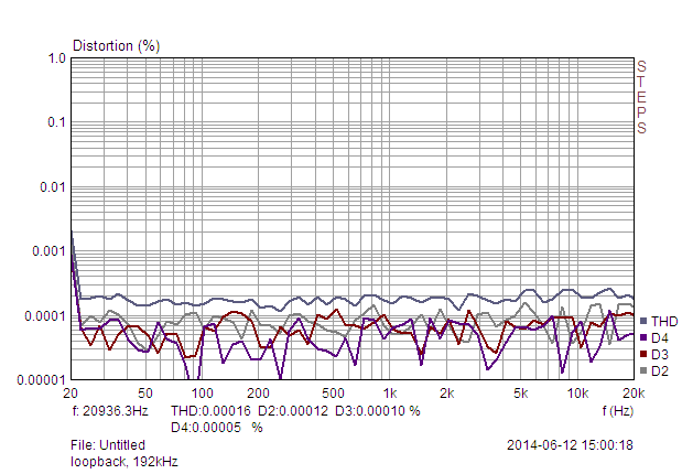

Here it is
Here's the thing ASIO for all is decent, but it's not as complete as a proper ASIO driver for the sound card. ASIO for all wont hard force different sampling frequencies within the hardware. If I use ASIO for all with my Xonar ST I can still manually control the sampling frequency elsewhere. If I use the proper Xonar ST ASIO drivers then the drivers force the sampling frequency to be correct.
In your 192kHz graph it's clear that the software is working at 192, but the hardware is not. This does not automatically mean that the hardware isn't capable, it could simply mean that you need to mess about with a few settings.
First of all you need to go into the windows sound set up. You should have two main panels here, one called 'playback' and one called 'recording'. What you need to do is go to the primary playback device click on properties then go to advanced and make sure that the sampling frequency and bit depth are set to 192/24. Then you must do the same for the primary recording device.
After these two are set, you need to make sure that any Creative software is also set in a similar way. My Xonar card comes with its own control panel. If you've got something similar for the Create card load it up. Have a look through the settings and see if there is one for sampling frequency. If there is one, make sure that it is also set to 192kHz, then you should be good to go.
To recap, when using ASIO for all, to make measurements at 192k what I have to do is this.
1) Set the sampling frequency in ARTA to 192k.
2) Set the playback devices sampling frequency to 192k in the windows control panel.
3) Set the recording devices sampling frequency to 192k in the windows control panel.
4) Set the sampling frequency to 192k in the Xonar control panel.
Only when I've done that does it work correctly.
