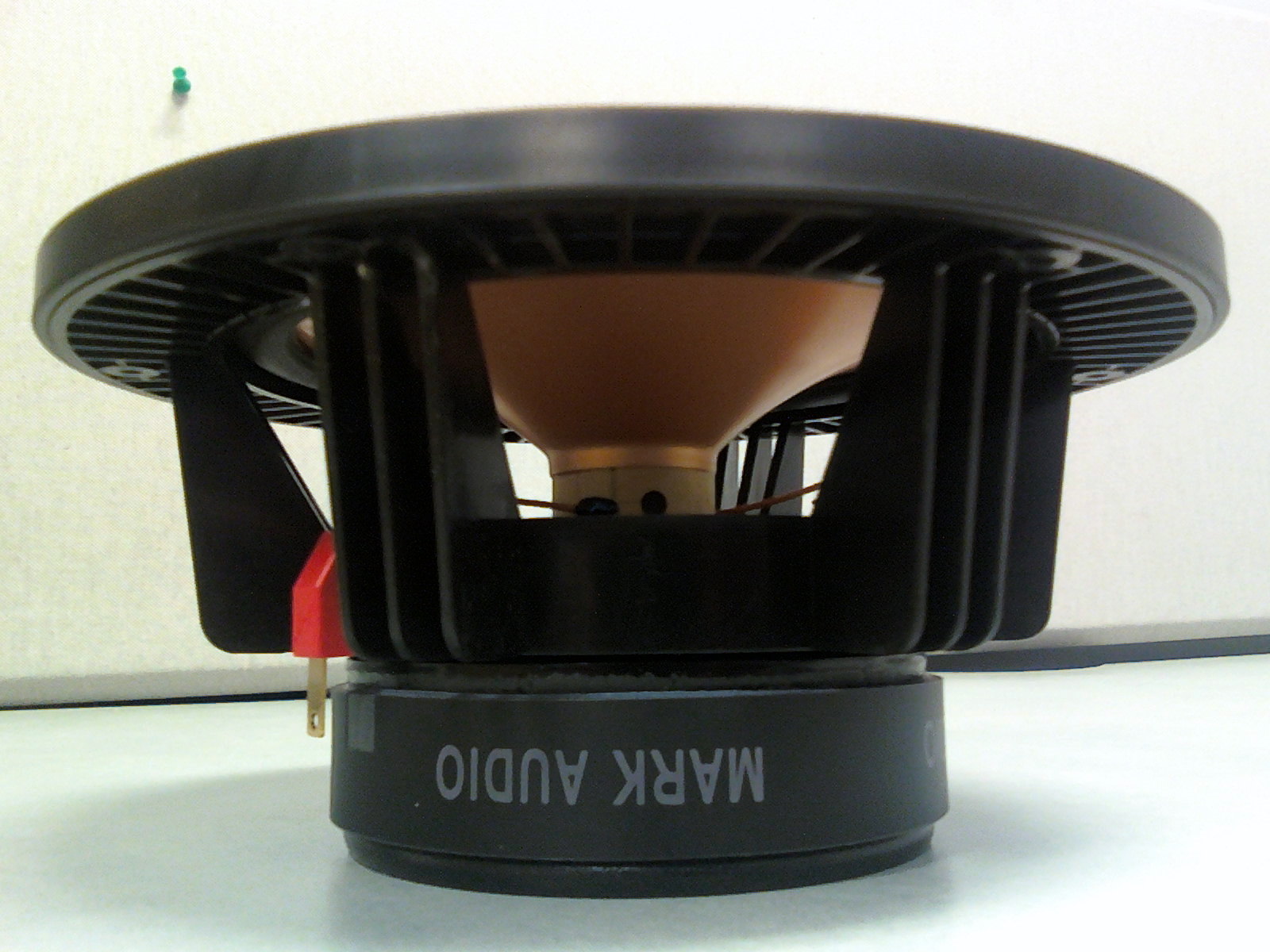

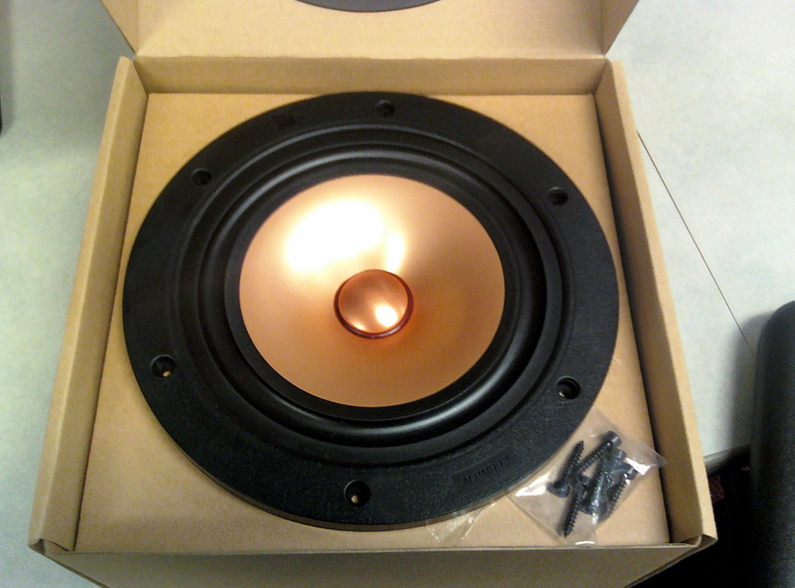

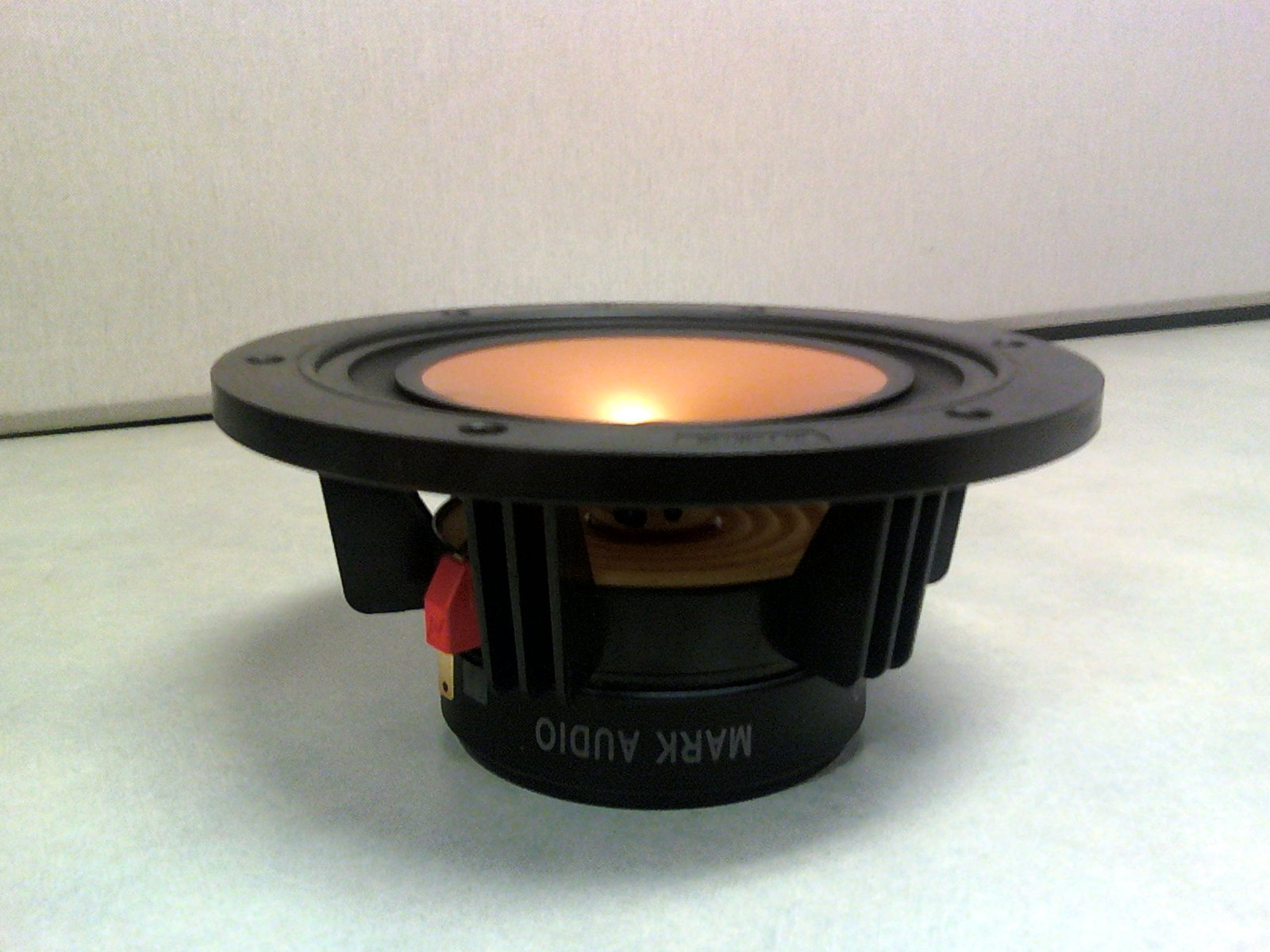

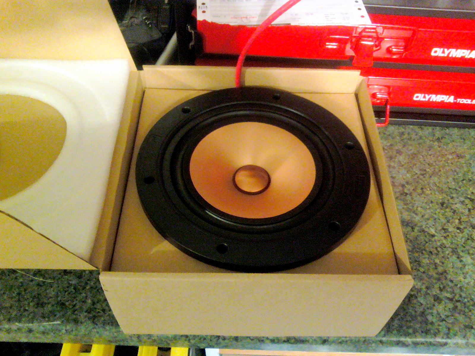

Well, my Alpair 12's in gold arrived today. Beautiful drivers! Everyone here at my office is impressed, and NONE of them know what they're looking at :) LOL!
I'm going to be building a set of SuperPensil12's and I'll document it all here. This is my first speaker build period which is obviously my first single driver foray as well. I've never even heard a single driver speaker so I'm really taking a chance here. We'll see how it turns out!
Here are a couple pics of the driver that I just took with my cell phone so I apologize for the poor quality.
I'm thinking of doing the speakers in a Satin White with a Satin Black base. What do you all think?
Anyway, just wanted to get this started. I'm going to start break-in on the drivers when I get home and hopefully start construction on the cabinets this weekend. I'll keep you all appraised. Thank you very much for the awesome community here, you've been a big help in this decision :D

I think your phone takes a pretty decent picture

Thanks :) I used Picasa to make them look a little bit better :D

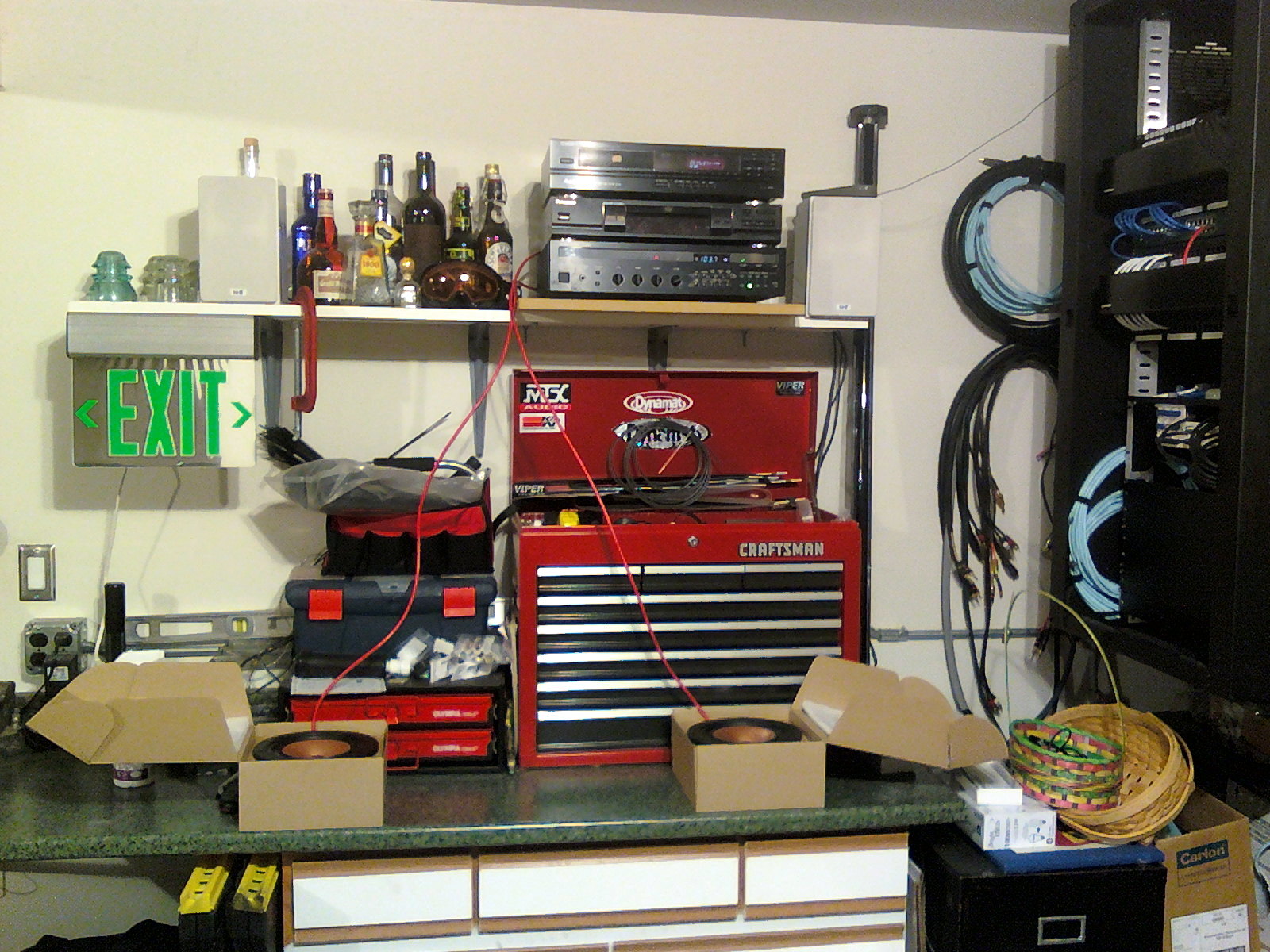

I've got them now set up in a set of super fancy custom boxes to break them in :rolleyes: I hooked them up to my garage amp with some Cat6 cables. They're now breaking in softly to some Acoustic Alchemy. Volume is low and cones are not even moving. Can't wait to get these broken in, cabinets made and start listening :D

Break in is going well, have about 20 hours on them so far and they're definitely opening up. When I first hooked them up my wife says, wow, those sound bad. Yesterday I had her running the stereo for me (pausing and unpausing every 4 hours) while I was at work and she said its really starting to sound good. Hoping I can start building the cabinets this weekend!
Over 100 hours now of break in and they are really astonishing how good they are sounding in the little cardboard boxes. I'm tempted to build a little OB platform and putting them into my system to listen to at low volumes until I get the cabinets built.

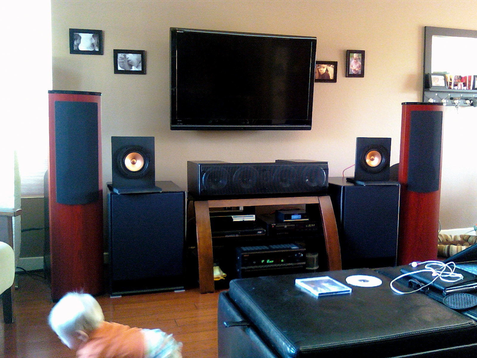

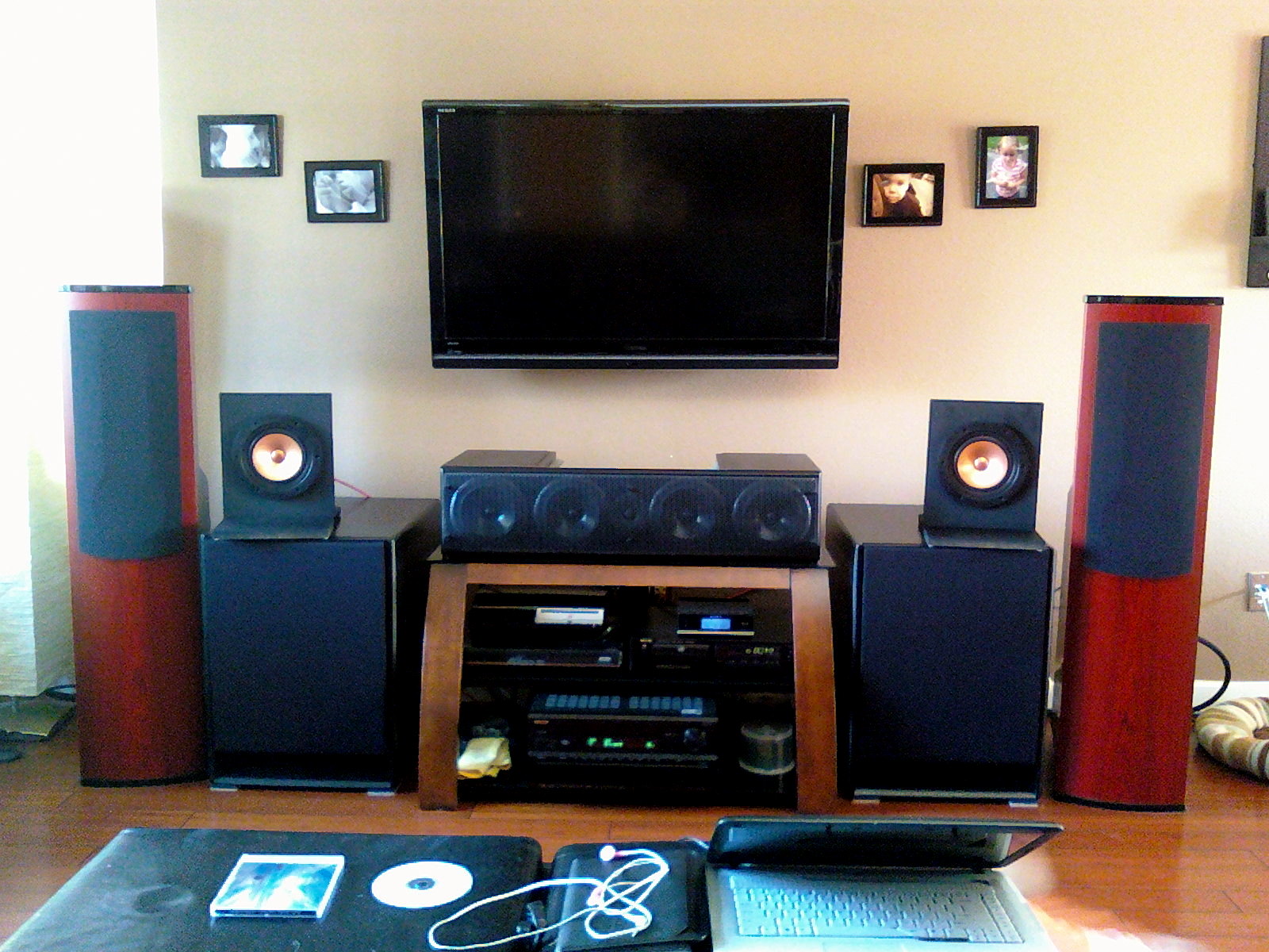

Built some temporary OB housings for the 12's just so I could get them in the living room and hear them in a little better environment :) I know, impatience! These things image REALLY well! There is absolutely no bass but that is to be expected. The highs are incredibly clear. Everyone has said these are revealing speakers and I definitely hear that. These really show everything! Can't wait to get the ACTUAL cabinets built ...
Scott

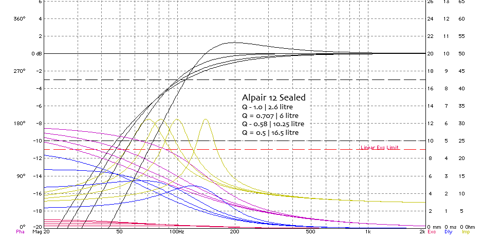

So what options are there for an Alpair12 center channel? I've seen THIS one but don't know any of the specs of the 12 in this box. I'd really like a -3db of around 80hz for crossover to my sub and prefer a large center channel (my current is 36"W x 8.5"T x 16"D). Does anyone know or has seen the modeled response for the center channel I linked to? What about other larger options?
Thanks!
