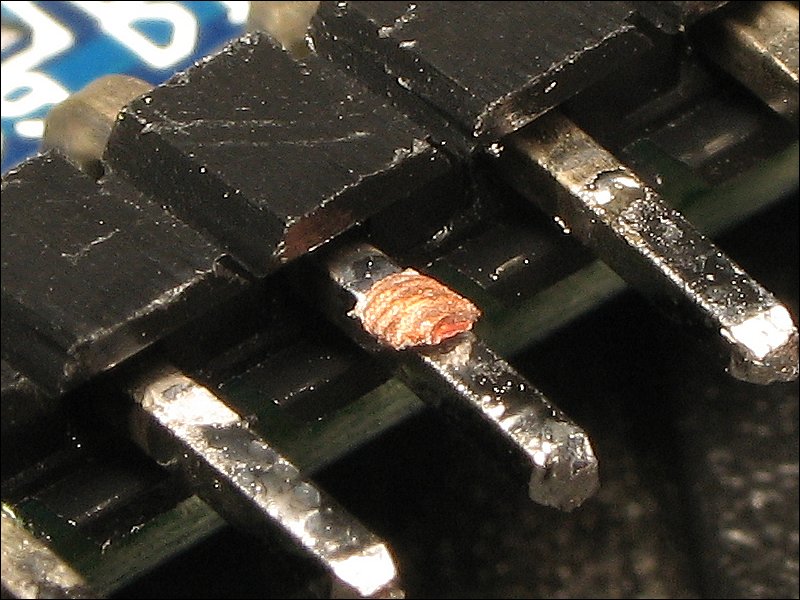

Is it possible that you pulled a via in the circuit board when replacing the capacitors? If that happened, the effective capacitance would be 1/2 of what it should be and that could cause problems in the output filter (the inductor is part of the output filter).
The vias are the copper cylindrical conductors that connect one side of the board to the other. If the solder isn't 100% removed around the component lead so that it requires significant force to remove the component, the vias are ripped out of the board. It's not always obvious that it has happened. The attached photo shows one example where part of a via was damaged (small piece of copper on the pin of the board).
Hello Perry
Ok i understand now
so no i haven't pulled a via when i've replaced condensators.

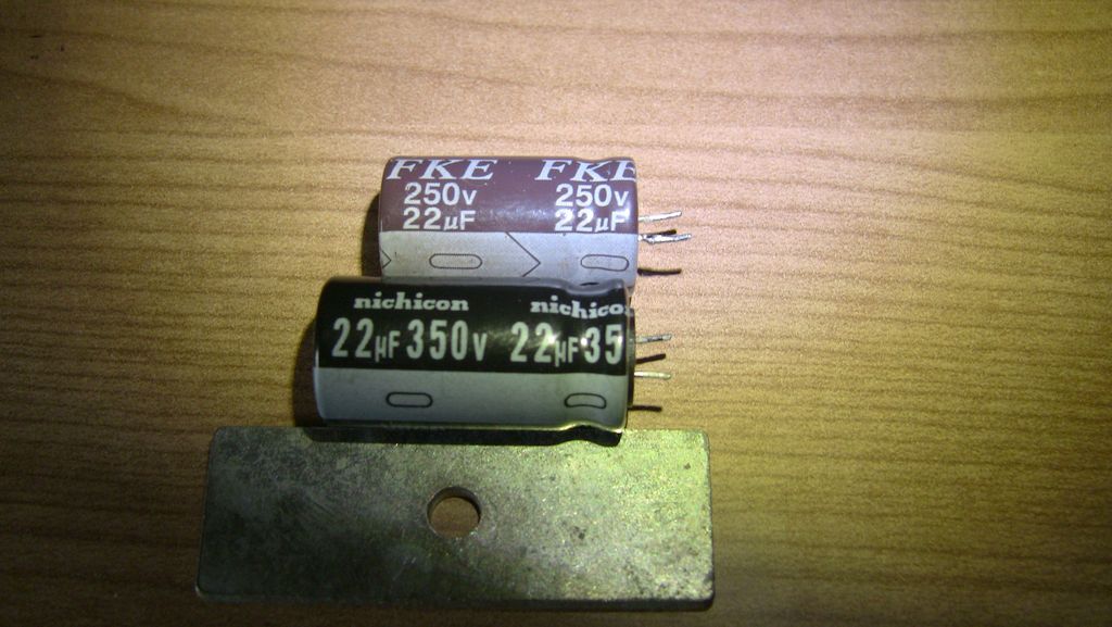

The fourth new condensators are: nichicon 22µF 350V serie VR(M)
The fourth old condensators are: FKE 22µF 250V
i attached a photo to show you new and old condensators.
do you think new condensateurs may warm up the coil? for me there is no reason but i'm not really sure now....

I know of no reason why those capacitors would cause the problem. When you measured the temperature of the output inductor before replacing the capacitors, are you sure the ambient temperature was the same and that you allowed precisely the same time from start-up to the time when you measured the temperature?
