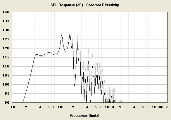

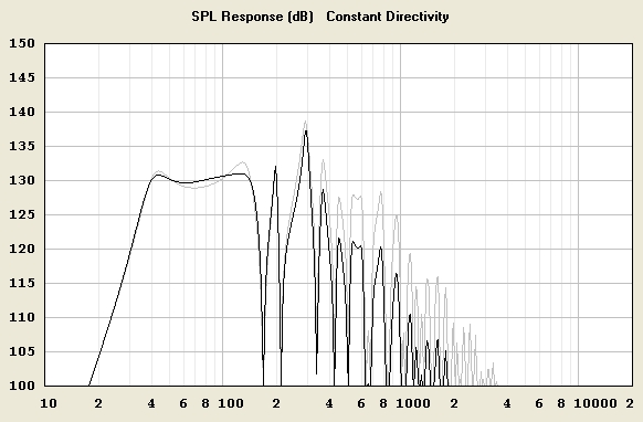

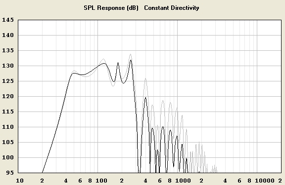

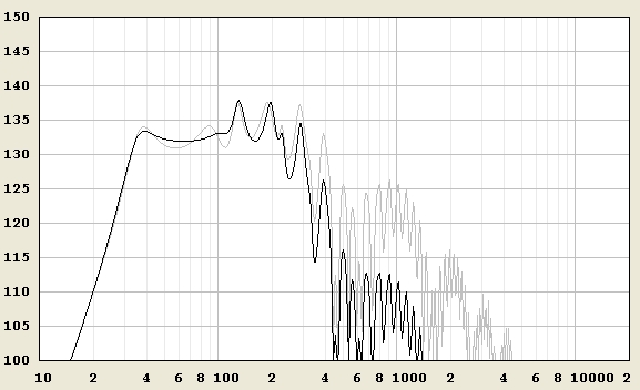

For Epa , and David and folks who are following,
I have thrown together a few of my own simulated examples of smoothing due to increased LE ..... Some examples use 2x LE , and some use more like 3x or 4x the driver's LE ....
Its a few compact compact TH cabinets (ss15 with 15tbx100 and small TH with dual 8" mcm 55-2421s) , and also for fun i included a tapped pipe (transflex) type design ...... The smoother response in these examples is accomplished with the raised LE in the simulation but if built and measured the real world results can often be just as smooth with less series inductance added, or in some cases none at all when the "saddle" dip and peaks in hornresponse are mild to begin with.....
I assume some of the more extreme cases of ripple and dips would still require some amount of added LE to smooth them out just as Mr Danley does with some of his boxes by adding inductors in series with some of his drivers..
