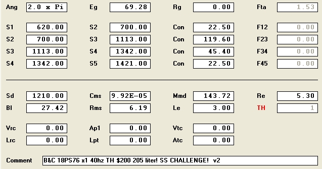

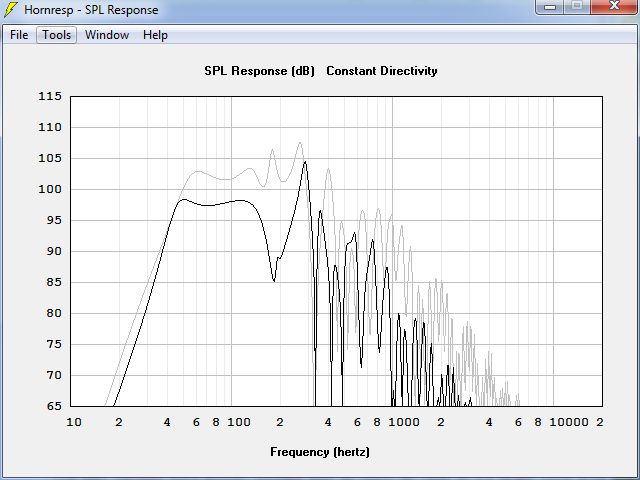

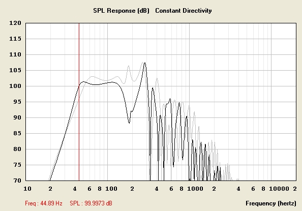

209 liter "SS-18PS76" contender!
Ok, I think i might have come up with a competitive design for JBELL's single sheet challenge! This box may be a good alternative for those who wanted something that has a little more bass extension ..... It has an internal airspace of 209 liters just like Jbell's amazing SS15 but the throat to mouth ratio is much less, allowing me to have a path length which is also less yet still meets the target tuning ... You can squeeze a B&C 18PS76 into this box and with this design's low compression ratio there is little risk of shredding the large diameter cone ...
*The 18PS76 has a low VAS and a low QTS which makes it function well in such a small TH, and with some added series inductance (3 or 4mh total in hornresponse which includes the driver inductance) you can get a pretty smooth response, but the inductor may not actually be necessary in real life with this box ...
*The B&C handles more power, sweeps just as much air (due to it's larger cone area) and retails for less than the 3015LF....
*The bass response "knee" (point at which response falls off like a rock) is more than 10hz lower in frequency compared to an SS15+3015lf which is pretty significant!...
*At the same power level this PS76 design is 4db more sensitive at 40hz and also 2.5db louder at 50hz but sacrifices a little bit of sensitivity to the SS15 around 60-80hz.....
*At 40hz with 600 watts (the rms rating of the PS76) , this box is 5db louder than the SS15 ....
*Overall this PS76 box is flatter according to simulation and has more bass extension ....
*If you want even more extension you can add a Brian Steele styled "DFD" constriction which should flatten the little response bump at 50hz and shift the fundamental resonance down by roughly 5 hertz, fill in the dip at 185hz , and give you a small amount of gain at 80hz and above based on Brian's charts... In theory it should work since this box is basically a scaled up version of Brian's POC#2 (with a slightly shorter path and a tuning/impedance minimum that is identical to the ss15 combined with a throat-to-mouth ratio and compression ratio that matches Brian's POC#2), but of course we wont know for sure if it works until someone builds one .. I am hoping to have access to a cabinet shop here again in the near future and i think i might give it a whirl :)
BY THE WAY , for a higher powered version you can drop in an 18LW2400 , or an 18TBX100 but they seem to need a little more series inductance ...

do you have a plan or is this just a sim?
He has already told you it is not built !
Hey there Epa,
Just a sim so far, and it was a sim to sim comparison that i was making.. I know that actual measured results can be different ...
I think i will try to draw up some plans but i haven't yet developed the keen folding and sketching skills that many more seasoned folks on here possess, so it will probably be simple .... Just a single fold version to start..
Neo Dan ,
Keep in mind that the 18PS76 and 3015LF both have an RE of 5.3 ohms ... At 2.83 volts the comparison looks like the screen shot i took of hornresponse which is attached to this message ... You can see the increased output at 40 & 50 hertz .... I wish it had more output at 60 but you always have to compromise somewhere right?
Brian Steele's "DFD" style constriction should improve the extension further and fill in the big dip at 180 hertz but i don't imagine it will give me any gains at 60..
