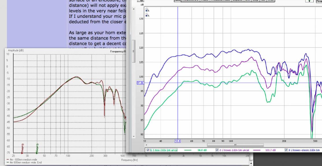

Something really looks a bit off there. Did you do an impedance response test on your SS15 to see if it was a good match for the HornResp model?
Brian,
Indoor room modes often dominate low frequency measurements. Move the microphone or the speaker around and the response will change.
The indoor warehouse response simply reflects the "boom boom room" effect, their previous outdoor tests match the "normal" SS15 response pretty closely, as can be seen in the two screen shots of the same speakers below.
Left is in the warehouse, right is outdoors.
  • Indoor:outdoor.jpg
Hi
I`ll have to ask Mr Rich ( R23d) about the hornresp modelling, he plugged in most of the data and we only made some small changes to match the RCF drivers.
As for the difference between indoors and outdoors I`ll have to go back to my statement of Holm Impulse giving us some very strange readings. It seems to fill in the gaps until it gets stable enough to plot properly. The REW measurements are very good and reflect what my ears think the boxes are doing. We tried running full range sweeps with Holm on the Unities and Subs combined outdoors. It just couldn`t give us an accurate reading with all the passband gains set at relative volume, it would seem to latch onto the highs and ignore the subs / mids.
NOW I must confess I hardly know the program and was intrigued to try it out. Again if I had the time to sit down with it and work out why we getting these results I`d love to! BUT time meant we moved to REW and now have two sets of results on two different measurement programs......not ideal or helpful!!
The warehouse we measured in was VERY big but full of clutter. Also we measured from 3-4m away on initial runs. So even with the mic pointing at the floor from < 1cm we might have got some room modes.The very first measurement runs were made with temp barn doors on one box at about 2am....not too scientific!
I personally am very happy with the result the doors give. We knew the subs were never going to reach 35hz or be 6db louder with them but they have added a simple, cheap way of getting nearer to that!
