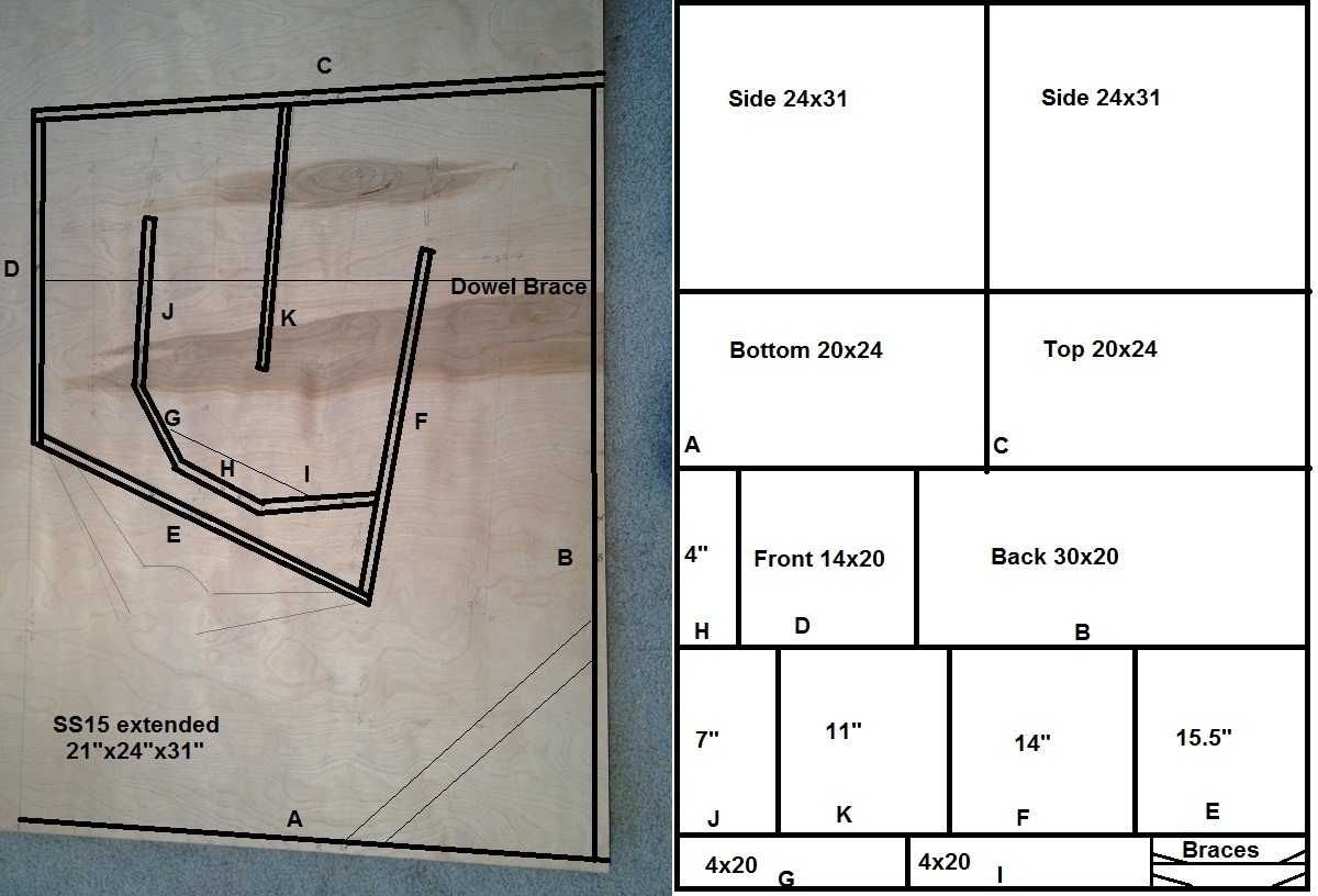

nah... still 5 ply 1/2"... But with the 'broom pole' brace... aka 1/2" dowel front to back.
By the time a metal grill goes on the front, you aren't giving up enough spl to vibration to justify going from 40lbs to 72lbs worth of ply. Especially if you are going to hang a heavy 4015lf in it... the lighter ply is worth it's (lack of) weight. Weight was the primary reason I invoked the 'single sheet' demand on this design in the first place.
Keep in mind (everyone) the SS15 design is not a multi-kilowatt design, and is not meant to tackle the 'big boys.' It's a cheap, lightweight, easy to build, very efficient sub ideal for bar bands, dj's, installs, etc.. The fact that in multiples like flipc uses... it's downright scary... well that's a bonus.
Anyone who wants to armor up... may make the outside case with 3/4" without affecting any of the internals. It kinda goes against the spirit of 'single sheet' but oh well.....
The 1/2" dowel is probably quite good in compression and thus "braces" against the panels "sucking in" when negative pressure exists inside the box.
What "braces" against positive pressure inside the box? Can the dowel work (provide stiff non extension) in tension relative to the forces and pressures acting?
Lol, there is only one to blame for the limitation set out for this challenge!
Of course everybody should build within his needs or preferences. But for those who are seriously considering an SS15 for high SPL’s, going 12mm (even for internals) is really not enough and braces are needed. However, braces can be reduced to half thickness of the panels without a problem (since forces on both sides of the braces are equal).
Indeed the “broom stick” method is very useful and its function can be improved by putting it in rings that are glued on the (inside) walls. This will enlarge the attachment surface and increases damping of the wall. I know it’s pretty old school, looks cheap, but it really works.
DJIM:
yea I hear ya.... However any serious design that's all about the max spl should probably never have a single sheet limitation in the first place... should be CNC cut, and use best in class drivers only... and yea, it's my fault that this whole topic of 'single sheet' has taken up over 1500 posts at this point.
However... since it's your fault I was up past 1:00am rejiggering panel dimensions to stay within a single sheet, while increasing real 40hz output AND incorporating the S2-fix you've been working on...
what do you think of this attempt?

Hey jbell, I'm glad to see that the modification for cone volume compensation has made it from the other two bigger/lower PA TH threads over here to the SS15. Flat to 40 is something I'm also after, and if you say this gets it there, it sounds promising to me. Are you ready to post HR plots (or even inputs) comparing the two designs yet? Definitely looking forward to some measurements after you've made sawdust.
And Djim, what does the RCF L15P200AK cost in .nl/.be? Because over here in .de it's about 300€, which doesn't seem like such a good deal, considering you can get the original 3015LF for 250 or the Kappa Pro for 150.

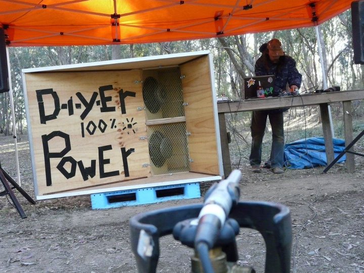

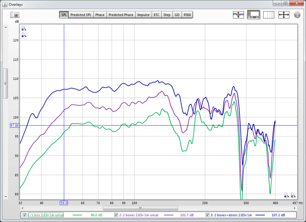

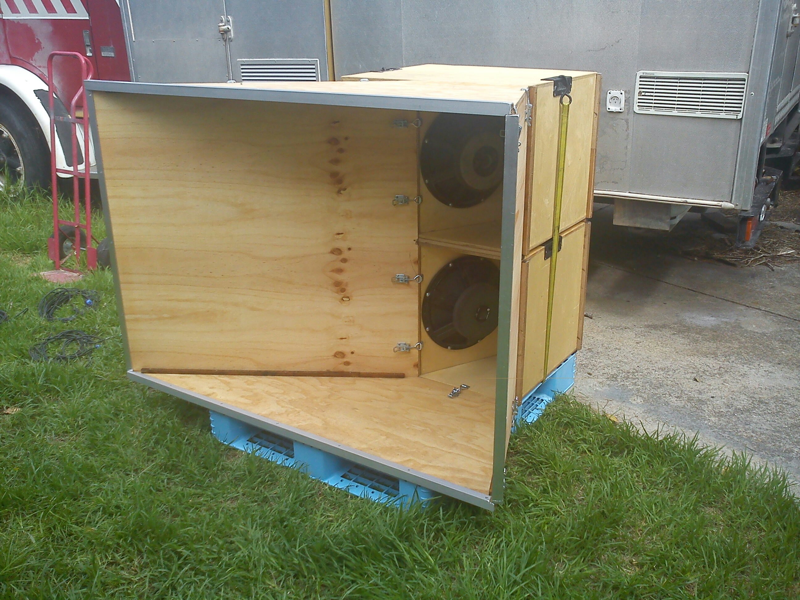

I made 4 of the original SS15's with my friends Phil and Marc and we have been playing with detachable "barn doors" to see what kind of extra performance gains are possible. Phil works with large touring rigs and has been keen to make a smallish tapped horn with collapsible extensions for a while and it really does work well.
We used 3 more sheets to make extensions for the 2x2 stacks, but for 4-8 db gain (curves for 1 box, 2 boxes and 2+extensions are attached), an extra 3/4 of a sheet per pox makes for a good sound to material ratio :)
They also unclip and pack flat...
It allows a pair of ss15s to hit a 45Hz corner, bumping up 40-45hz response by about 7-8db over a pair of subs with no extensions.
We came to the shape after a lot of experimentation with bits of ply and measurement mics, plus deciding on 600mm maximum extension from the front.
I can post sketches/plans if anyone else is keen, or just experiment yourself!
