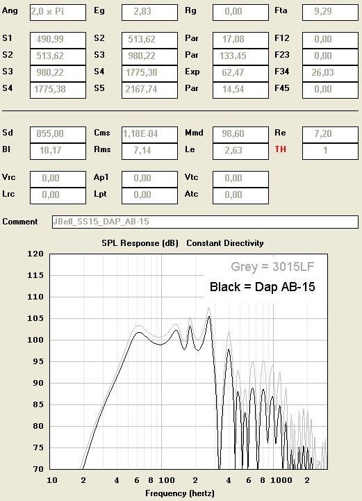

Cheap 80 Euro alternative for Eminence 3015lf
For the European DIY builders on a very tight budget there is a cheap alternative driver for the SS15, the DAP AB-15 that you can find for about 80 Euro's.
Although factory specs suggest it is rated as 400W continue and 800W max, I wouldn't go beyond 500Watts that much. Still, for the price for one 3015lf you can have 2 Dap's.

Fiction or truth?
Jbell, a while ago you asked why the LF output looks different from predictions, especially below 1/3WL. I’m working on a possible answer that I want to show.
Think of flutes, remember? 1/6th extension outside the cab, (1/3 WL) 50Hz – 1/6th = 50 – 8,3 = 41,7Hz (ring any Jbells yet, try the harmonic tests with same Voltage from 40 to 44Hz by 1/2Hz steps)
Now the big question, what if the main system works as a Tapped Horn but the driver also sees an Offset Horn in the same construction. Now let’s see what HornResp says:
You can clearly see where the two designs cross each other 41,7Hz (coincidence?). You can also see the LF extension below this point. Also look carefully to the +60Hz knee in the response of the offset horn. Now think how these two graphs can influence and integrate with each other (and what would the possible outcome be if you add both).
Compare those findings, to what you have measured with your Smaart and see if you find any resemblances (Ps did you make measurements without Low-cuts yet)?
