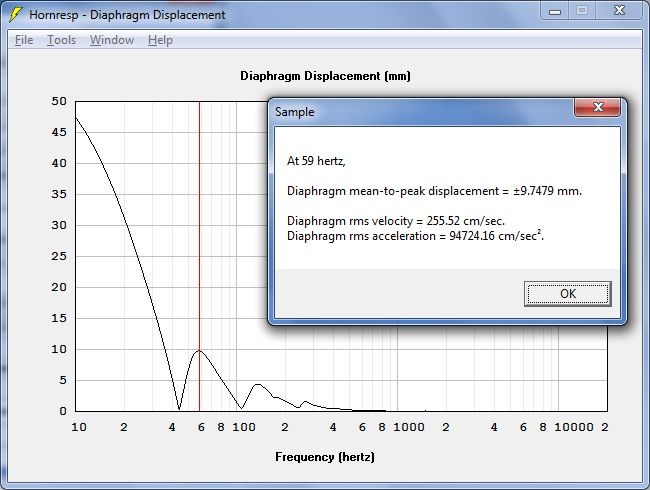

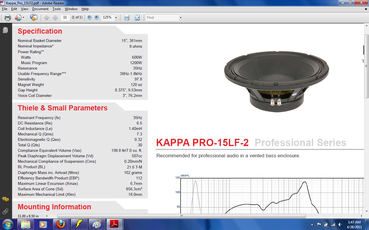

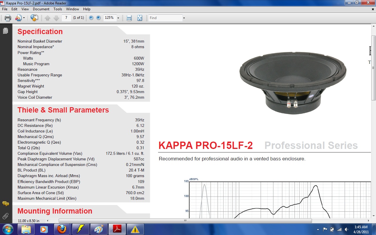

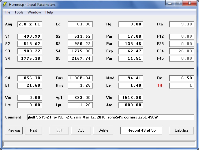

Sooo, turns out I had a different spec sheet for the Kappa Pro 15LF-2 than the one I just dwnloaded...
BUT, I show xmax (6.7mm) being exceeded at 59Hz when using 63v (9.74mm)... Do I have my enclosure specs off or am I missing something else?...

You seem to use the old specs of the driver that show better Thiele-Small parameters.
The Kappa Pro-15LF-2 at 53 volt has a theoretical HornResp excursion of 10,5mm. The reality is this drivers suffers from at least 3dB pwr/dyn compression at Xmax. This means you will need twice the power to reach Xmax in reality.
Xmax theoretical = 40V at 6,12Ohm = 265Watt
Xmax theoretical -3dB pwr/dyn compression = 530Watt
Like I said at LEAST 3dB so powering this driver to its 600 watts continues power rating is absolutely NO problem!
That's why I said people are way to much concentrating on theoretical Xmax while they don't seem (or want?) to understand the impact of power/dynamic compression. Although I never work with Eminence the 3dB seems to be the (lowest) value I get from other users.
