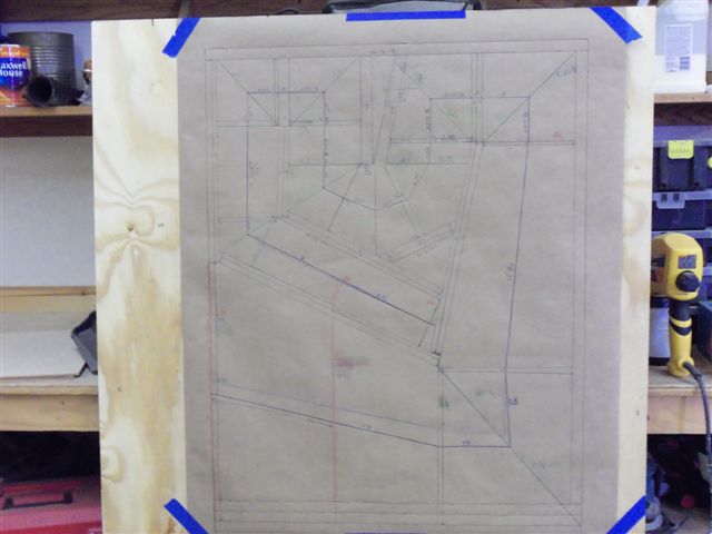

I added some dimensions to sheet 2 to approximate the hornresp input.
Width is 533 so multiply the height dims by 5.33 for the areas.
The horn length to S3 is entirely a guess as the actual shape is curved.
There are 2 dimensions at S4 & S5 that I overlapped, S4 being 344mm (1833.52 cm sq) which includes an allowance for the driver of 18mm and s5 is 410mm (2185.3 cm sq)
Does anyone have ideas how these might be simulated?

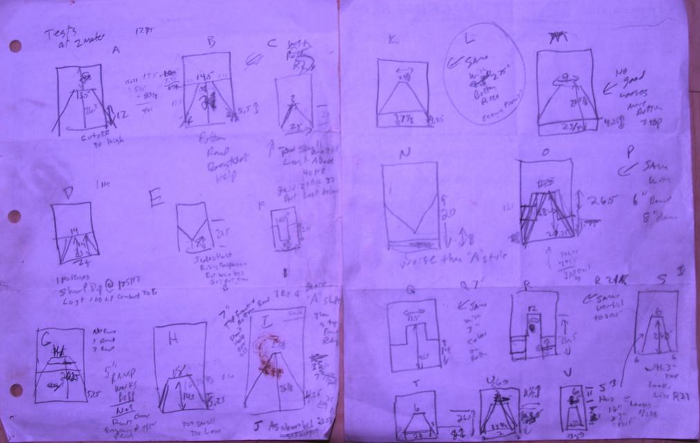

DJK,
Hornresp is based on a circular horn cross section, various shapes are not possible to model. Changing the circular cross section to high aspect ratio rectangular real world construction opens up many opportunities for the real cabinet response to vary quite a bit from a model.
I don’t know if other programs allow for different shape cross sections and mouths, but even if they did, they would probably exhibit higher “Q” results than the actual cabinet does, as the simulations I have seen presently do.
For a simulation program to be accurate, it has to follow real world results, not the other way around.
Hornresp predicting a lower LF corner for multiple TH is another example of a program not following real world results.

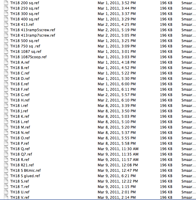

As I knew that it would not be possible to simulate different mouth shapes, once I was happy with the simulated frequency response and output level for the basic horn plan of what became the Keystone, I experimented first with basic rectangular exit areas, full width of the horn, then with various shapes.
Various corner ramps were added and discarded during the tests after they proved to have inconsequential effects within an octave of the upper pass band with this particular fold pattern.
The basic rectangular exits are not on the "A-V" test descriptive pictures, since they could easily be recorded as simple areas from 200 square inches to 1087 square inches, which was no front panel at all.
As well as the tests saved, many interim tests were performed, the tests listed are probably only 25% of the actual tests done.
Tests “I” and “U” were fairly close to the Karlson shape. At the low frequency pass band of a sub, the curved aperture of the Karlson shape would test little different than straight lines approximating the shape, after those shapes proved less effective than the Keystone shape, having less upper and lower response with more peaks (pretty much what one would expect from the Karlson shape L.O.L) I found no reason to try any further homage to Karlson.
Real tests made outdoors, away from buildings, with decent test gear trump simulations. Note that I did not stop at test “S”, pretty much the Keystone mouth exit as built, many other shapes and sizes tested before and after were tried.
Back to the SS15, by closing the front panel, and putting the exit on the panel opposite from the speaker, the same tests could be conducted on it.
I think it possible the SS15 in such a configuration, using a Keystone exit, might load a bit lower and still retain, or even better, the upper response.
