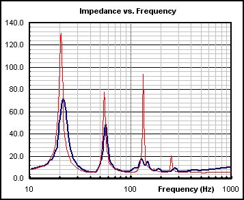

If you look at the designs posted at that point, and go check out the threads, what was built and measured was not what was in the HR graphs posted here.
If you have a sub built, and then design a HR sim from it, and it turns out different then your sim is wrong. If you design a sim and then build a real sub around it, if the sub measures different from the sim you didn't build the simed horn. There is nothing else to it.
If you go back though these threads you can find many examples of this. Anytime there is a design that varies when built and measured from the HR sim, if you take the time to create a new HR sim from the blueprints you will find the error, and if done correctly the sim will match up to the measured response.
That said the amplitudes may vary a little (due to realities HR doesn't handle,) but the peaks and dips will match-up Hertz for Hertz on the FR and Impedance graphs.
Why measuring impedance is important...
It might not be an exact match, but it should be very close :).
The impedance graphs will also indicate if there are other problems with your build.
For example:

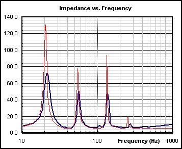

Image 1 shows the impedance response of the TH I built a few days ago. Note that while the first two impedance peaks look like fairly close matches, some things stick out: (1) the actual impedance peaks are slightly higher in frequency than the predicted ones, suggesting that the path length may be slightly shorter (I predicted the possibility of it being off by around 3%~4%). This could also possibly be due to other things, like difference between HornResp's value for c and actual c in my location. However, more important though are the greatly reduced third peak and some ripples above 100 Hz, and the difference between predicted and actual impedance between 20 and 40 Hz is a bit higher than it appears to be elsewhere in the response graph. This suggests that the enclosure is not sufficiently braced and the panels are not properly damped.
Image 2 shows the same TH, this time with a bit of bracing added to the first segment. The upper impedance peak is easier to distinguish, but it's not very high, and there are still a few ripples in the response that are not predicted by HornResp.
Image 3 shows the same TH, this time with a lot more bracing added to the first segment (basically an additional layer of plywood was glued and screwed to the external panel at that point). Some bracing was also added to the third segment of the horn (found at the bottom of the box). The upper peak is now higher and very clearly defined and the ripple @200 Hz has disappeared.

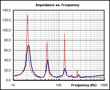

Image 4 shows the same TH, this time with more bracing added to the third segment of the horn (two 5" x 20" strips of ply added to the bottom of the box). A small brace was also added internally to the second segment of the horn. Not much has changed, but it looks like there's now closer correlation between the predicted and actual impedance between 20 and 40 Hz. Further bracing is likely not going to make any significant difference, unless I manage to find what panel resonance is causing the little blip @ 100 Hz. I might spend some time on that later today.
Image 5 shows the same TH, with 185 Lbs of weight added to the enclosure (basically me sitting on top, LOL). All panel resonances are now sufficiently damped to the point of having little or no visible impact on the impedance curve.

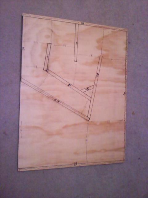

I did a full size layout, just to make sure my cartoon drawing was going to work... I think it does. I brought S1 down to 450cm (3 1/2" x 21) but other than that, the full size drawing is almost identical to my scratch paper drawings.

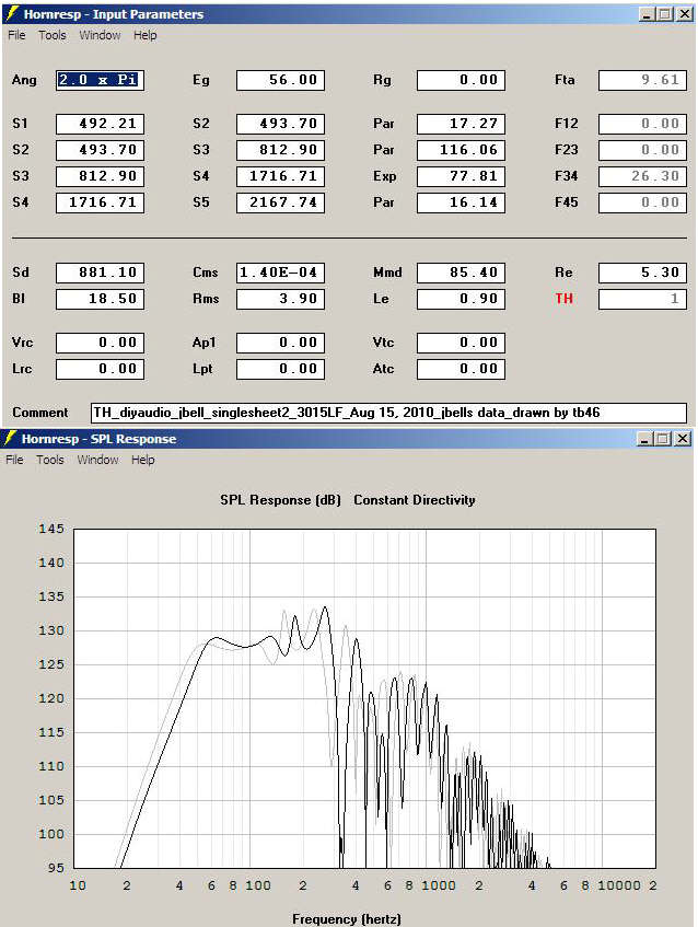

Accurate simulation of singlesheet_2
Hi again,
After trying to reconcile the Hornresp Input w/ the drawing, and trying to draw what was there I'm at a bit of a loss. To get to a better simulation of what is actually being build I will need much better data, otherwise it's back to horseshoes and handgranates. :)

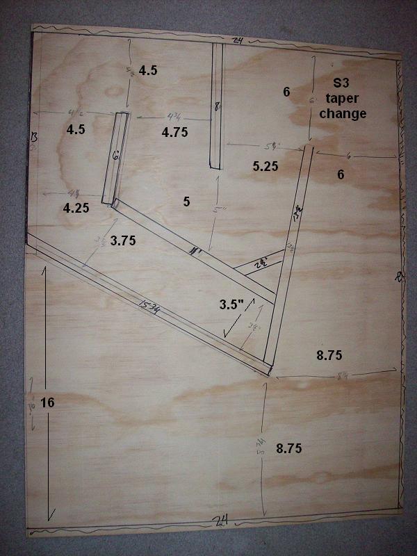

Oliver:
I have issues translating what I draw to hornresp as well, it only makes sense that others have the same issue.... ;)
However the goal in this case was a dual taper TH with the main taper change at the upper back. My cell phone took a lousy pic the other day, so here is my layout with some additional dimensions called out.

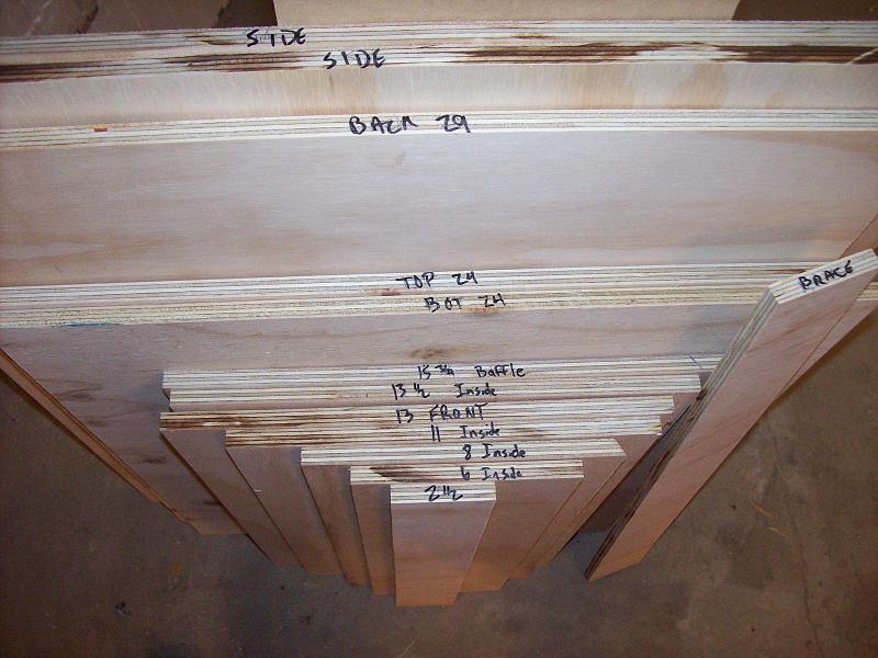

re:jbell 1 sheet layout layout = kool ! - I luv 1-sheet speaker projects
yep, so do I... And this one has the side benefit of having great looks. I'm thinking a PE square metal grill will complete the look.

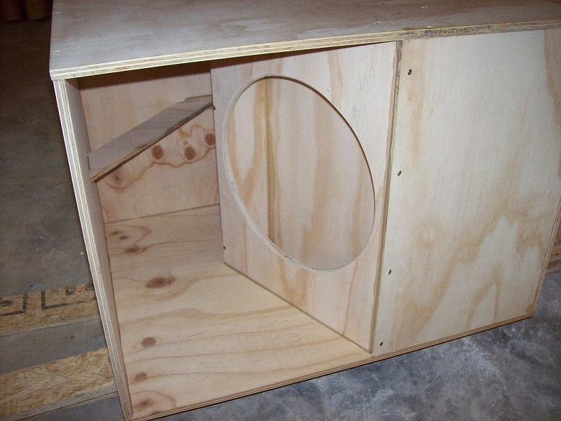

Have to wait till the glue dries to know for sure what it sounds like. I glued up the 2nd side, so no tuning on this one, it is what it is. (gutsy or stupid -- don't know.)

Thanks oliver:
It'd be nice to be able to accurately sim this, as my initial 2.83v readings are AWESOME !!!!! I won't do any 28v readings until the glue has time to set for 24hours, so take this with a HUGE grain of salt, but still...... flat 105db from 50-120... no nasty dip at 160, smooth up through 200hz, and still 99db at 40hz.
I am in love.
If anyone wonders why I post readings this way -- it's so I'm consistent back to my first measurements. This way I always have an exact reference to what I've done before. I may not be 100% accurate in my measurements, but they are consistent from one sub measurement to the next.
I use sine waves, every 1hz, over grass outdoors, and then plot out the every 5hz increments. (no one really wants to see the readings for every 1 hz.) While I have smaart and other apps, I always come back to the same spl meter, volt meter, and sine waves.
There is a sharp narrow dip from 150-152hz down to about 100db, but other than that, everything is nice and smooth.
2 Boxes or more minimum to bring up the 40hz, and it's a party.
Anyone considering building cubes forget it.. this trounces the cube. Anyone considering building the big box, unless you REALLY need sub 40hz, forget it -- build this.
