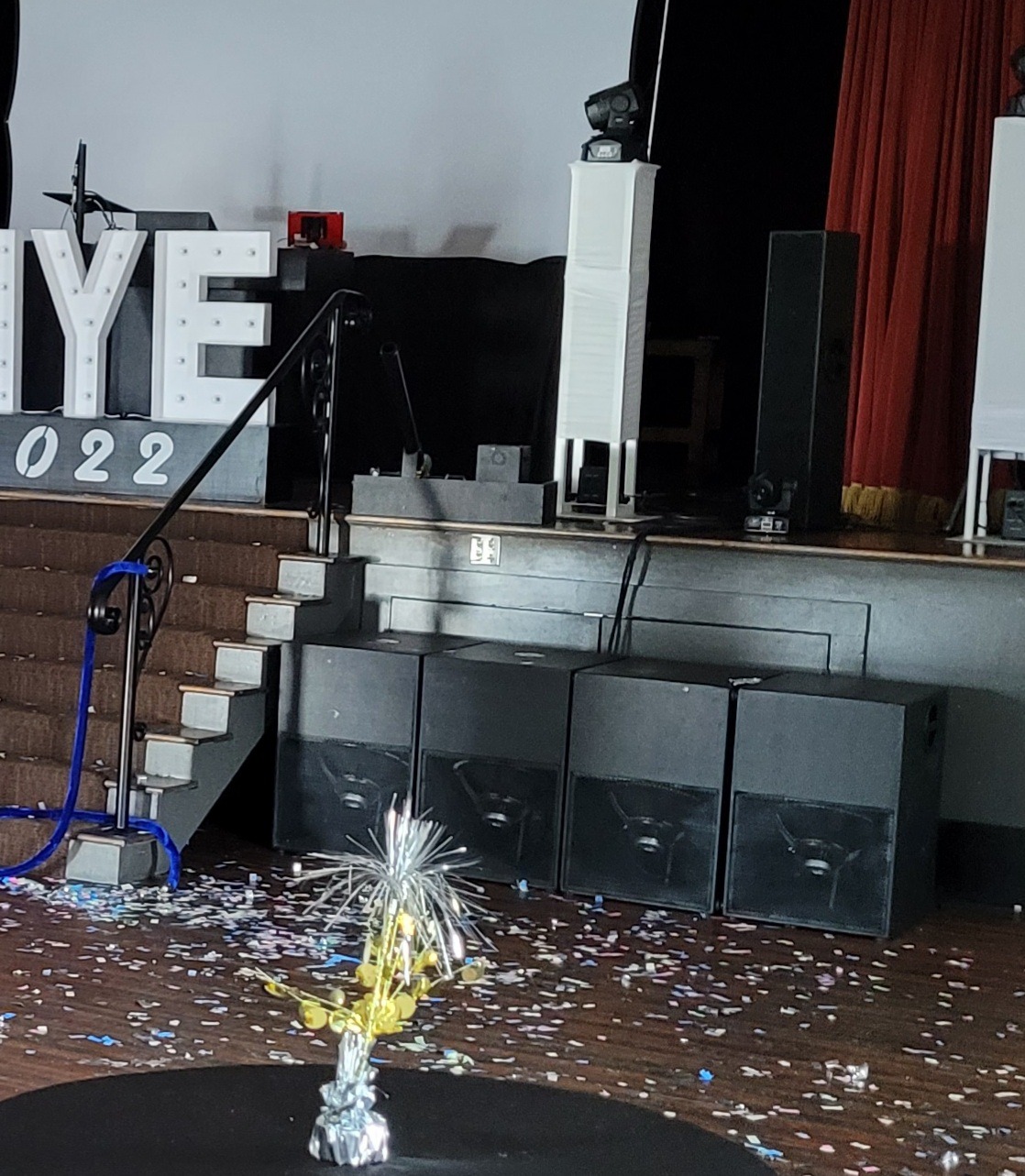

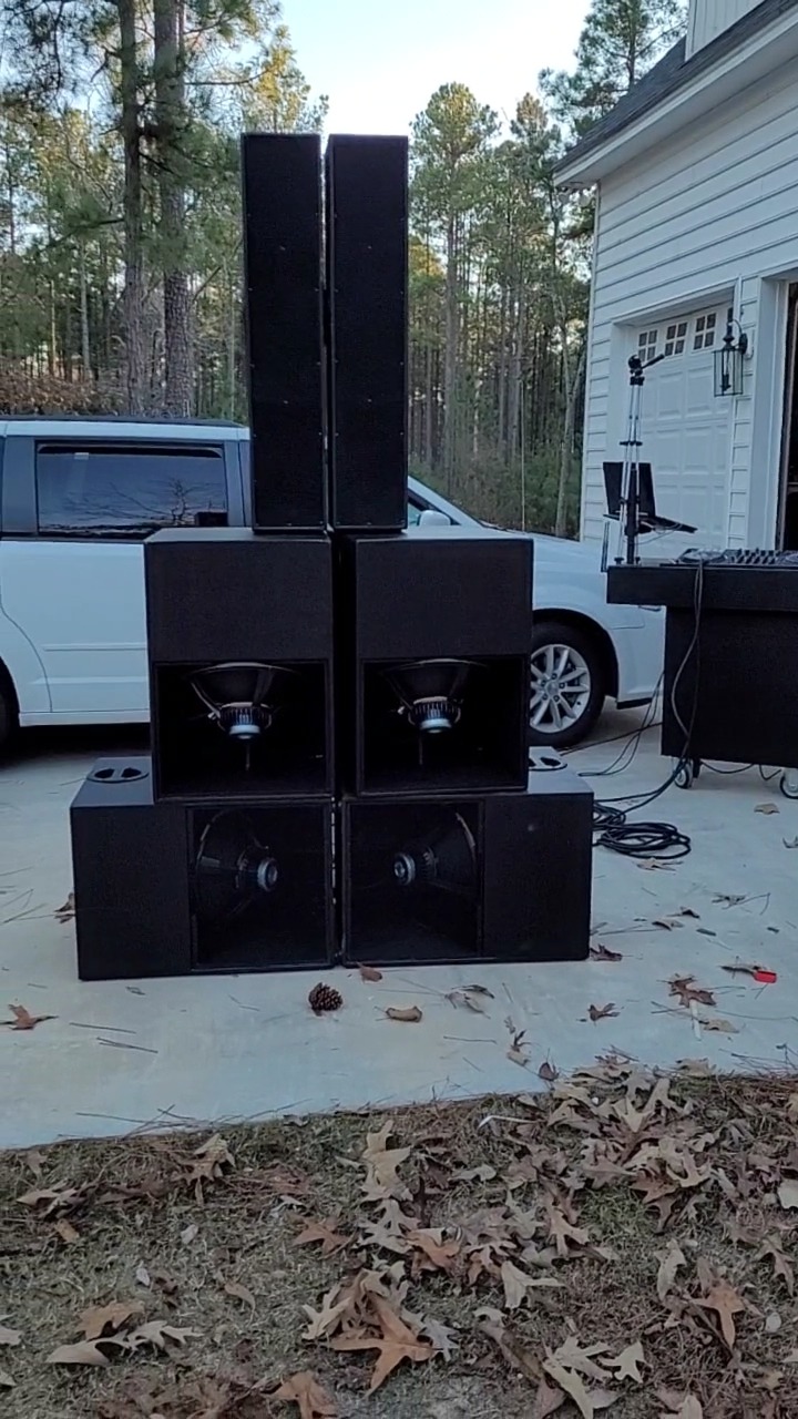

UPDATE - So i finally got to use my 4x = 3015lf loaded SS15s and all i can say is wow!!! The room I was in I am very familiar with and have DJed in almost 100 times over the last 15 years. I have never experienced bass like this, I have used 4 x 18"bass reflex numerous times in this room and never "felt" it like this!!!!
Crossed @ 40hz to 130hz
Played mostly Top 40 and Pop EDM remixes. I could feel the bass in my chest up on the stage which I never felt before using bass reflex. Out on the dancefloor it was like a Miami nightclub.
Here are a few pics of the system.
Tops are 4x6" RCF NX-L24 copies I made
I would like to thank JBELL and the other contributors on this forum for a great design.
**** On a side note - the elevator was broken at this facility so we had to carry up 2 flights of stairs...the lightweight of these subs made that slightly less painful!!! (glad I didn't swap to 4015s like I asked in a recent post)

. Crossed at 80hz.

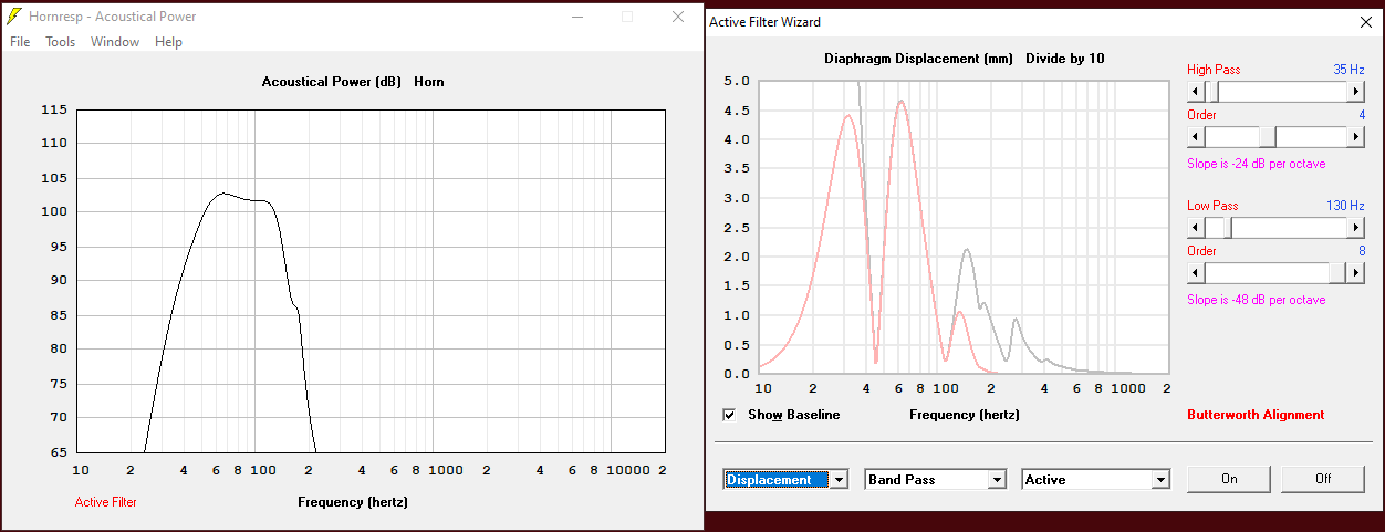

It is hard to explain how effortless these tapped horns sound. They may lack the very lowest frequencies but they can be used with minimal limiting and keep up with the rest of the system- which with gives an very dynamic sound.:cool:
BTW I would investigate if you can maybe use a lower High Pass. I would of thought that 35Hz 4th order butterworth would be adequate, and give just a bit more,

BTW I would investigate if you can maybe use a lower High Pass. I would of thought that 35Hz 4th order butterworth would be adequate, and give just a bit more, View attachment 1011817
I have ran two of these crossed at 35hz before but not near their limits. I knew I would be approaching limit since it was NYE and I thought I had read on here that 40hz was a good safe point for the 3015s so I adjusted it to 40hz before the party just to be safe.
I may try them at 35hz next time. Thanks for the comment.

funny thing HP filters.... sometimes lower is better. I've come to the thought that it needs to be low enough to get sufficient excursion to cool the motor without exceeding. I use 35.
