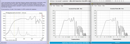

We can exlude the EAW and the EV TX from the comparison. The EAW is a hybrid design. The EV TX uses a chassis with a terribly weak motor, combined with (too) low tuning, which leads to a pronounced drop-off in the lower end.
The Fulcrum is a somewhat decent comparison, and does >100 dB SPL 1w / 1m / 2pi from 50 Hz on - on average 103 dB in the bass area, very similar to the EV Xsub.
The JBL has an even more similar FR to the Xsub; sadly the datasheet lacks the information if the sensitivity value is 2pi or 4pi.
Ahh, the good old "mouth bubble" myth. "1m is near field! - you have to measure a sub at least in 3, 4 m distance"; "at 1m distance the port is much too loud!" It has taken me years to defeat this nonsense in the German forums.

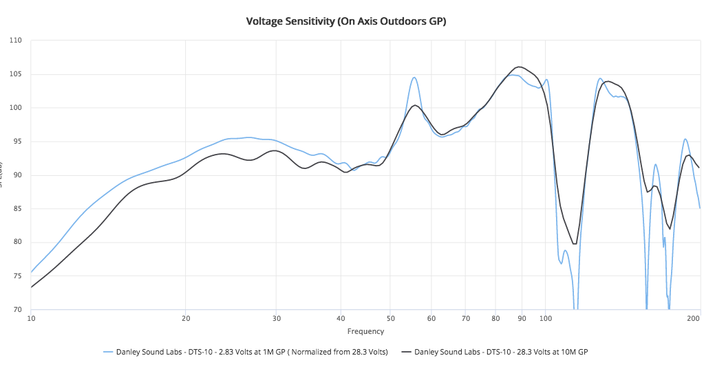

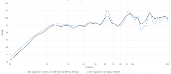

Here's a FR measurement of a large ported sub in 1m vs. 10m distance (source):
Basic response of single subs is the same from 1m onwards. There are at least three challenges with greater distances however:
1. reflections. The distance of the measurement setup to the next hard object has to be a high multiple of the distance from the speaker to the mic. At 10m measurement distance, a suitable location is very hard to find.
The 10m measurement shown above already displays some influence of reflections, indicated by waviness - an addition and substraction of reflections to / from the direct sound of the speaker, alternating with frequency / wavelength.

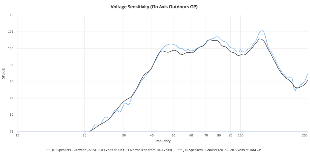

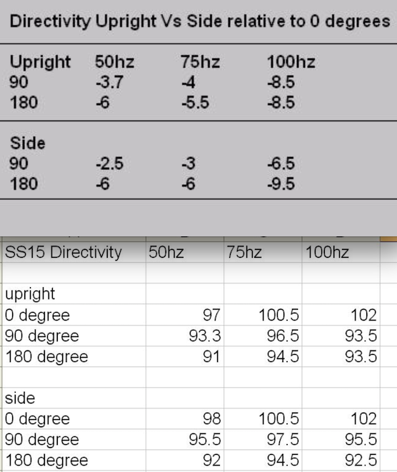

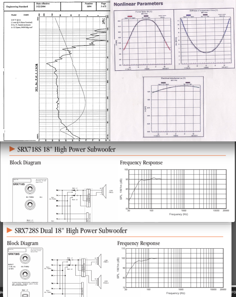

I'm fairly sure the JBL SRX measurements are half space, having measured the cabinet myself and compared it to my various subs, simulations, other's "sub shootouts" going back well over ten years.
JBL used to measure their subs on top of the 8400 building, see the 3/22/2004 2268 in 8 cubic foot sealed response and the SRX718 &728 responses.

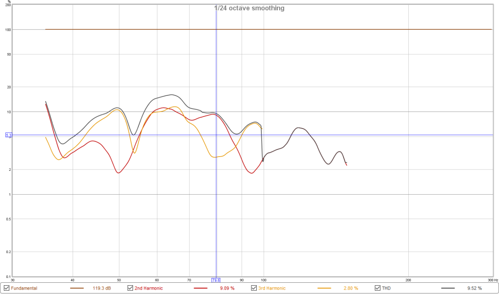

I'd love to see what the THD curve for that build looks like.

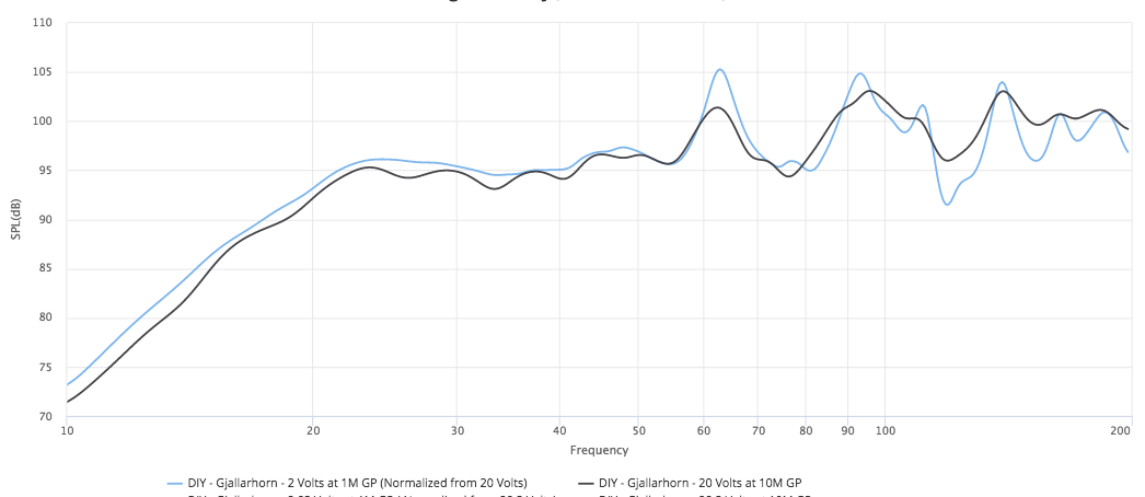

Art: the slight difference in the responses of the 1m vs the 10m measurements of the Gjallarhorn and the Danley, which are in the low bass area about 1 dB for the former, and 2 dB for the latter, can be perfectly attributed to problem #3 with large distance measurements I described in my last post.
The measurements at Data-Bass are done at 2V / 4ohm and 2,83V / 8 ohm = 1 watt for 1m distance. They are done at 20V / 4 ohm and 28,3V / 8 ohm = 100 watts for 10m distance. It is perfectly normal and expected for such a design to show some port compression at 100 watts, which would show itself by a sensitivity drop at the lower end of the frequency range. I have done extensive personal comparative measurements on that very subject, and there are also AES papers covering it.
It is in principle not possible for subwoofers of similar design to show differing near vs far field behavior. Only possible explanation would be a drastic difference in baffle size, in the area of metres, which is not the case here (only ever is with large stacks of subs).

Brian: if you mean the SS15 w. 15LB075, a Max. SPL @ 10% THD (a commonly used yardstick) chart can be found at my linked report @ HiFi-Forum.de.

Again though, some of his subs measured at 1 vs 10m distance, like the Ridge Audio GUJ18V1 build I linked, show no drop in SPL at 10m. Some do.
Physics do not allow for such a difference between boxes of inconsequental baffle size differences at those frequencies. So we would need detailed information on his whole measurement setup to diagnose where the differences stem from.
Also, as mentioned, I have my own data on this. I will share one measurement series, of a single 18" BR sub. The environment is my garden, with the next hard obstacle being a small garden hut 10, 15 metres away; then at least another 20 metres of nothing, except grass and small trees.
Gold represents 0,5m, red 1m, blue 2m, green 4m distance from speaker to mic. SPL at the mic was maintained equal by increasing the input to the sub.
As we can see, no difference in bass response between 0,5 and 2m. 4m gets choppier, because of reflections, but is on average equal to the other distances in the bass area.

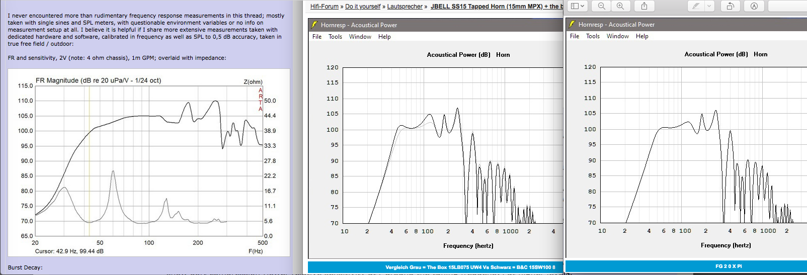

Hornresp simulations (within Xmax) for most well-built cabinets agree quite closely with their 2 pi/ground plane measurements, Josh Ricci’s DataBass has many examples we both have referenced.
Your measurements show a sensitivity around +8dB at 40 Hz , +4 dB at 100Hz greater than it’s Hornresp simulation, which is quite unusual.
Since you have ruled out measurement calibration issues, do you have any explanation for the large sensitivity/simulation variance?
A simple simulation, like Hornresp, bbox, BoxSIM, WinISD and the like, is a rough approximation of a speaker's response. It is a guideline that helps us build prototypes that aren't that far off the final result. It would be pure coincidence if it perfectly equated to an acoustic measurement however.
For more accurate results, one will have to use professional CAD-like software like ABEC, Comsol, ...
No they don't. That's just another of your convoluted off-base claims that maybe would fly if noone bothered checking.
One quick example: the Othorn. Simulations can be found here, measurements here.
Simulated f3 is about 29 Hz; measured f3 is about 32 Hz
Simulated 1w / 1m / 2pi sensitivity is on average below 100 Hz 97 dB; measured sensitivity is 100 dB

As for the need of the mic to be tilted in GPMs, see the measurement in my post #2247. Neither mic nor speaker were tilted to each other in this comparison; both were lying flush on the floor.
We can see that from base tones (around a couple hundred Hz) upwards, differences begin to appear between the various distances (= angles), which get to be pronounced in midrange frequencies. This is because of the increased directivity of the large 18" speakers at higher frequencies.
Bass (generally defined as up to 200 Hz) response is unaffected, as it should and must be, because of its omnidirectional nature. So no, for bass GPMs, mic and speaker do not need to be angled to each other.
As for GPMs being useful until high frequencies: from what I gather, GPMs have established themselves as standard even for fullrange speakers with various test magazines. The requirement for that is a perfectly flat floor, and perfect angling of mic to speaker. At wavelengths of centimeters at high frequencies, even half a cm placement error can cause a significant deviation in the measurement.
Okay, now things are getting clearer. Based on what's presented in the linked paper, I assume your definition of "2pi measurement" is "speaker flush in the ground, pointing upwards, mic suspended in the air pointing downwards"?
The difference to my understanding of 2pi as both mic as well as speaker placed on the ground, horizontally instead of vertically, should be negligible at low frequencies. The ground would act as a mirror source in both scenarios. There might be a slight phase difference between sources to the mic in both scenarios, but with wave lenghts in the area of metres, it should be inconsequential.
What best represents "real life" between the two, as you alluded to in post #2237, good question. In real life situations, the speaker, or stacks of speakers, are placed not flush with the ground, but on the ground, in heights of usually ~0,5 to 2m. The measurement instrument, our ears , are approximately at 1,5 to 2m height. I suppose both methods should provide a close enough representation of real life situations.
You understand 2Pi correctly.
And that is what almost every program that simulates loudspeakers creates in sim land.
The tilting the loudspeaker. Not the mic is a recommended practice. It does make a difference in some conditions so if you want to avoid problems use the little trick.
It very well could be that your differences ion measurement between Hornresp as a simulation are related to this discrepancy. I have used HOrnresp for about 20 years. And I can tell you that if you are much different than a few db you have either really buggered the simulation or you have buggered up your enclosure. 99% of the time it is a difference in the enclosure versus the simulated enclosure. Hornresp is very accurate.
Last point. Hornresp simulates Power response. Not SPL. You have to take that into consideration to.
I take it from a few of your comments that you have live sound experience. Power response is what you are after in that business, as much as in home stereo. It what you get in the real world. Inside is generally 1Pi unless you are in a concrete block room like in Europe. Or a basement in North America. Or an apartment building I guess. Standard wood stud wall construction in North America is almost invisible a little below 30 hertz. It's the mass not wanting to move around to much that keeps the sound inside the venue. Or not!

Our tests conclusively confirm the on-axis sensitivity advantage of the TH over BR.
Tapped Horn Vs. Bass Reflex Case Study
Some of the sensitivity advantage seems to be due to the TH having a higher DI (directivity index) over it’s usable pass-band. JBell’s directivity tests appear to indicate the SS15 has a higher DI to a lower frequency than my larger, longer path length Keystone TH. My directivity tests were not accurate due to proximity to surrounding buildings.
Tapped Horn Directivity
Though JBell’s directivity tests linked in the OP may have been distant from surroundings, they are rather limited in data points, and have no comparative results.
Cardioid sub arrays have become increasingly popular in the last decade, the ability of a TH to exhibit some degree of that behavior is another of it’s compelling features.
Subjective accounts of TH attenuated rear response are many, but measurements are few.

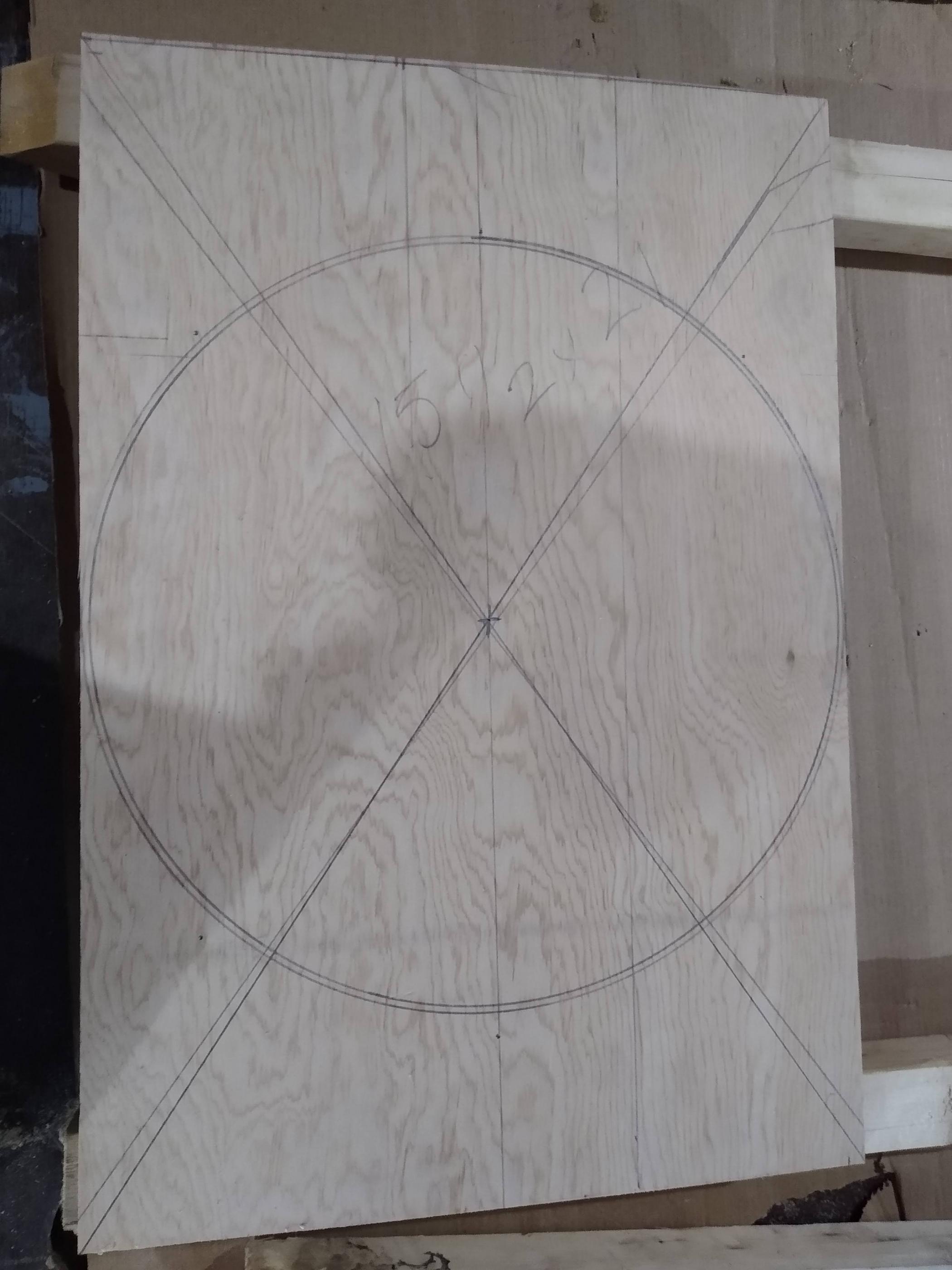

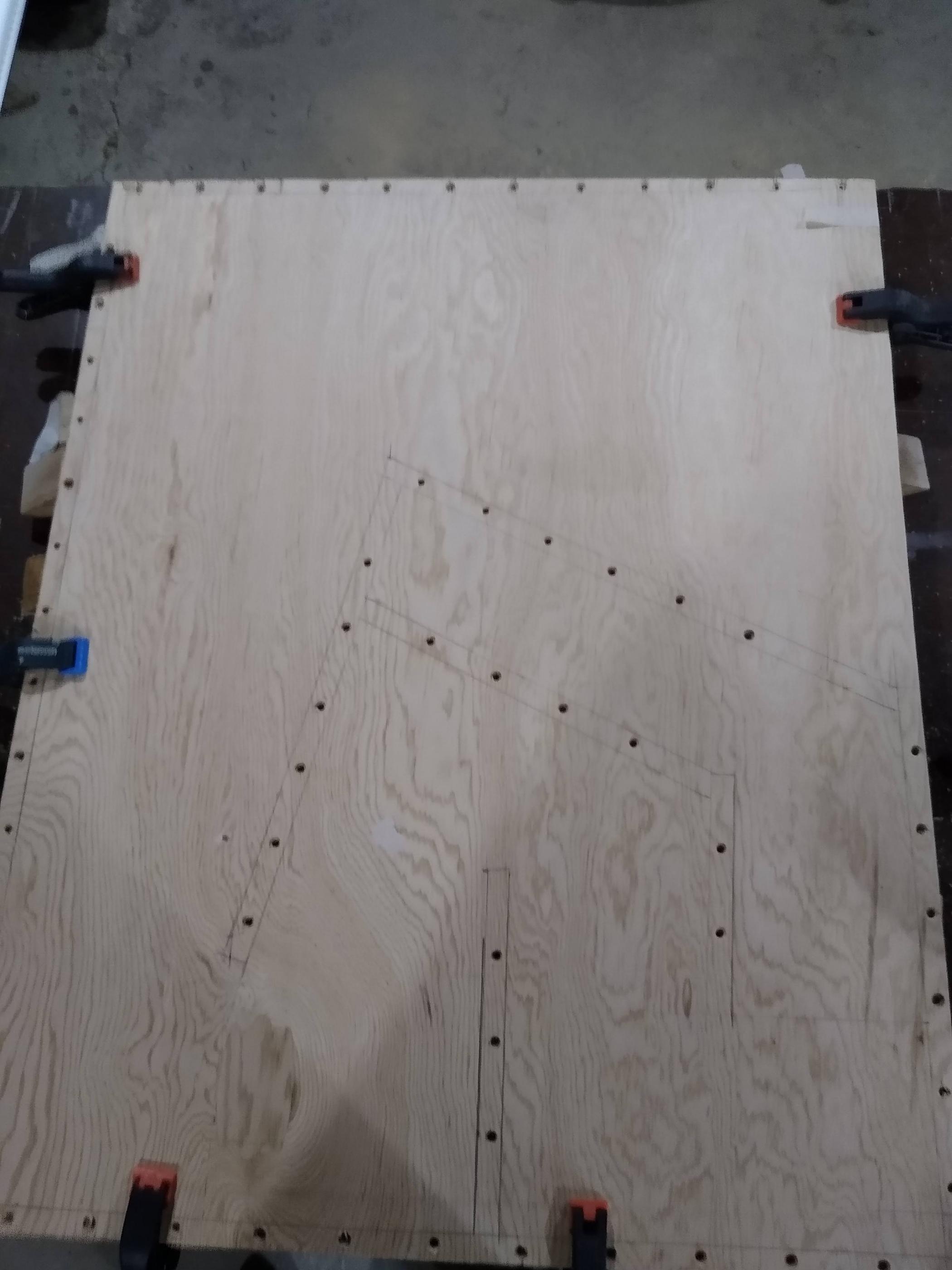

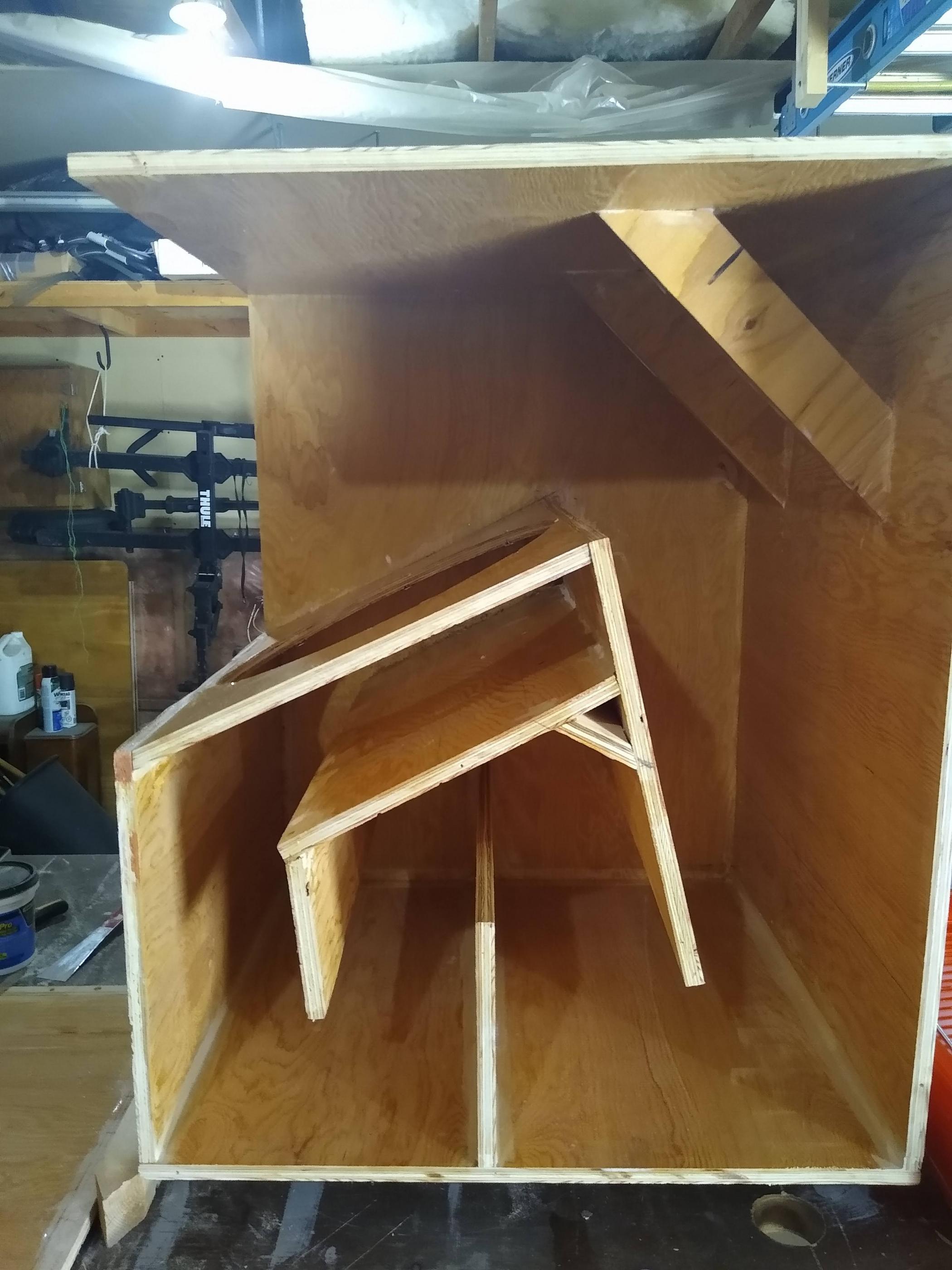

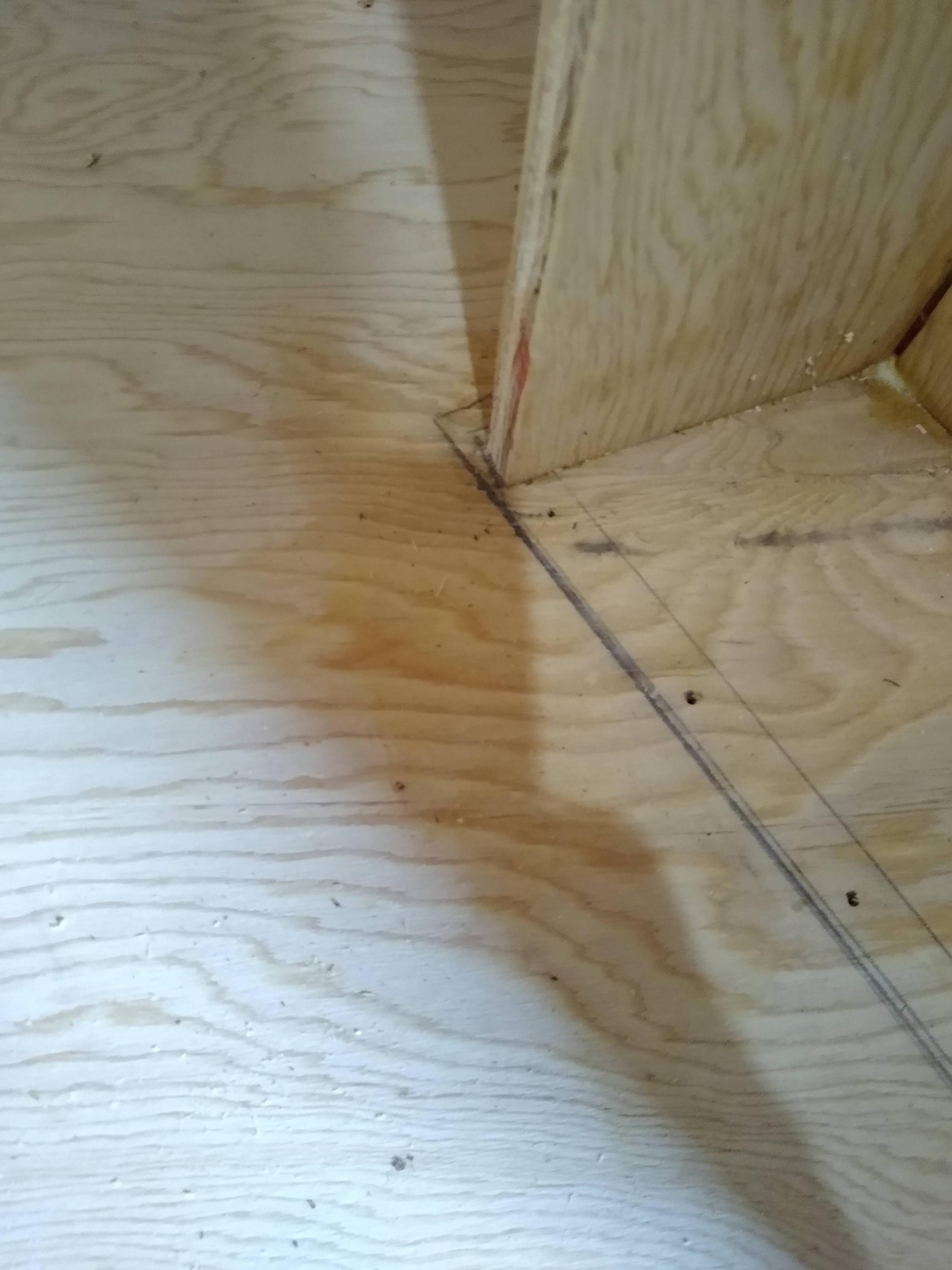

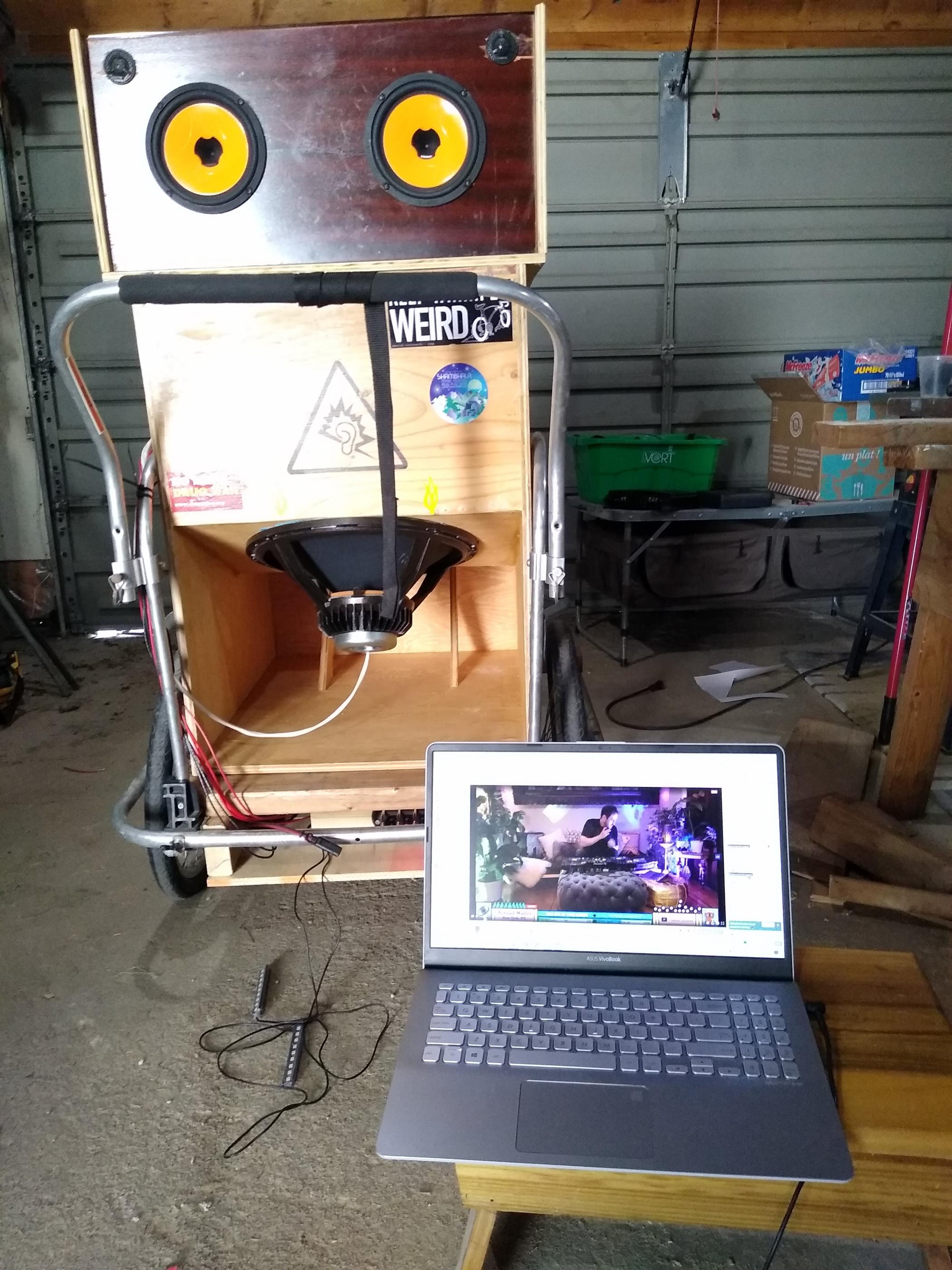

This was a really fun project, I built it up with a kappalite 3015lf (4ohms) to put on my bike trailer, I had 22 inches of space on the trailer so it was a snug fit. This is my first scratch built speaker and I made a few mistakes, I think the speaker baffle should have extended passed the backboard so I had to use the driver to keep the board together for gluing, and the holes on the second side did not line up so I ended up patching and re-drilling. Currently running it off a GM-DX874 (300 watts RMS x 2 bridged at 4 ohms) and it's very loud. The tops need be redone next. I can give it a few burps with my Umik-1 if anyone is interested.
