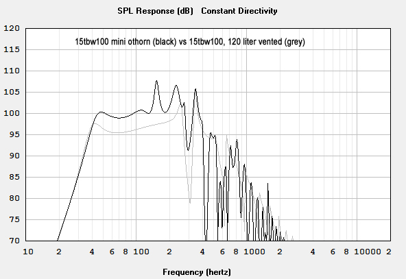

I was working on simulating a compact TH for the B&C 15sw115 (way too expensive for this thread, at over 500€ price tag), when I noticed that the 2.5m² of wood required was well within the spirit of the single sheet challenge (one 4x8 sheet is 3m²). So I looked around a bit for other drivers, and stumbled across the newish 15tbw100 from B&C, which looked promising.
As a starting disclaimer, this driver is not available for under 200 bucks, it costs 300€ here in Europe (so I'd imagine around 300$ in USA). However the original 3015LF is no longer under 200 bucks either, I believe last time I checked it was 240€ here. So with that in mind, I feel you might as well pay 60€ more for the beefy magnet, 4" VC and extra xmax and power handling. As such, I have decided to submit this design to this thread anyway. It may interest those with a slightly flexible budget who want something small.
The external dimensions of this sub are 64cm * 64cm * 53cm (25" * 25" * 21"). It is as such a full cubic foot (30l) smaller than the SS15, although it does take the same amount of wood to build.
Despite this small size, my simulations show it beating the SS15 by about 4dB in max output, and playing a 1/3 of an octave lower. Here is my hornresp data (grey curve is SS15 at xmax) :
xmax as you can see is reached at at about 840W with no power compression, obviously more than that in the real world. As the driver is rated for 1500W/3000W, I think there should be enough thermal headroom to reach xmax. Compression ratio at about 3.33:1 is a bit high, but also manageable for a quality 15" I think.

I very much like this!. it seems halfway decent with the 15tbw100 as well!!!! Plus it could give me decent practice on building an othorn lol!
EDIT
sorry, thought yoru graph was with the 15sw115. I notice its with the tbw100. Why is your bl rating lower than spec?
it does a good job of handily spanking a vented box of around 115 liters by about 4 db at xmax, although the vented box will do a bit better between 40 and 45 (in reference to itself)
I had HornResp calculate it using the spec values for Re,Vas,Sd,Fs and Qes.
Plus or minus a few percent won't really make a big difference in the results, drivers tend to vary that much among a series anyway.

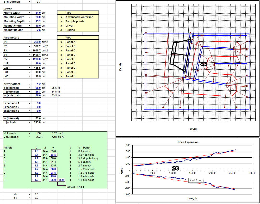

Here is an example of the spreadsheet, with S3 set as option 1 given above. The spreadsheet is not quite finished yet, but it's good enough to use to "tweak" the panel dimensions via computer before committing a design to wood.
...and here's an example of a folding that's closer to the SS15's scheme. Mapping out the expansion suggests S3 occurs at the base of the vertical panel as I indicated. (Ignore the numbers for S3, L23 and L34 to the right - the spreadsheet is still under development, so they are incorrect).
I should be finished with the spreadsheet in a few days, just in case anyone's interested.

I'm still interested.
Pretty sure David McBean will be interested to!
No mean feat to develop a folding aid like you are showing.
It will eventually be finished, once I stop thinking of tweaks to add to it, LOL.

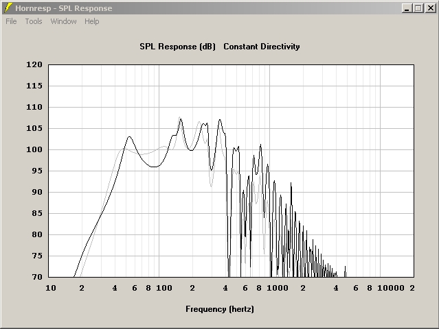

The B&C 15TBW100 seems to sim exceptionally well in a small tapped horn.
For instance substituting the Eminence 3015LF in jwmbro's sim in post 1981 results in a very poor frequency response with a big dip at 90Hz.
The optimal balance of LF extension, max SPL, and size is up to the user!
Sim attached showing the B&C 15TBW100 and the Eminence 3015LF in comparison in jwmbro's sim.
Regards Xoc1

I have not seen a better design for the 15tbw100 yet. granted it doesnt go super low.
FWIW, the 15tbw100 also sims fairly well in the 'cone volume correction' style SS15 (here's a photo of the one I built, I think there are plans somewhere in this thread too) that has been discussed here, which is in my humble opinion probably the optimal version of SS15 (I think Djim came up with it? not sure). The regular SS15 will most likely perform almost as well, I just didn't have the HornResp entry data handy.
Here's a sim of it at xmax, hyperlinked in order to not clog up the page with images, as you can see it's a bit peakier than my design, due to the relatively lower compression ratio, but it plays a bit louder (hoffman's iron law at work - the box is a cubic foot larger).
A matter of preference I think. The SS15 may be easier to saw, since I havent worked on a cutsheet for the other design yet.
EDIT: And of course both of them only play down to 40Hz, this is not the sub for you if you want lower content than that, I imagine the 15tbw100 would do well in the 15" Keystone sub, or several of the other designs aimed at lower response that can be found in this forum. Try em yourself, I'd look at the C/E/X horn, the Keystone, maybe the PAL-12 and probably a few more I can't think of right now.

Here's what the latest version looks like. I think I've worked out all the bugs (including a major one that basically indicates that my POC3 design is a lot longer than I planned, groan).
If you'd like to give it a spin, let me know. I'll likely add it to the "spreadsheet" thread in a week or two anyway, once I've completed POC3 and had a chance to compare predictions to actual results.

Brian, is that design still a single sheet? If so, it looks really nice!

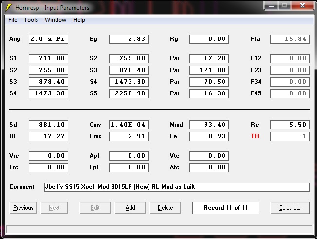

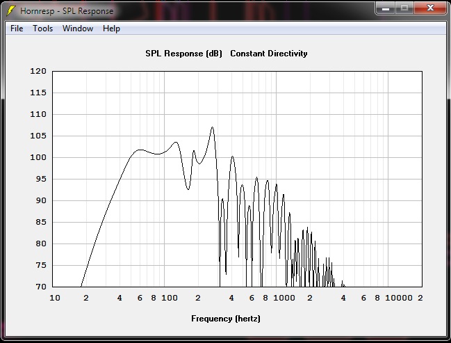

I built two SS15s a while ago, but they are not completly finished yet, so havent really tested them.
I used Xoc1´s extended version as a baseline, and then I tweaked it to better suit the new version of the Kappalite 3015LF´s that I have, I also tweaked it so all the panels actually fitted on a 12x1220x2440mm sheet, with sawblade margins ;)
I simulated a couple of different versions with more cone correction, but they actually gave a slightly worse result than what I ended up building.
If any one wants more drawings or such for this version, ask me and I can send autocad drawings with all measurements.
But beware, I went a bit of the single sheet thinking here, all the 12mm panels fit one sheet, with not much more than dust left, but all the bracing and reinforcements for the handles are made from 9mm, I used about a half sheet of 9mm for two cabs. So, they arent really SS15´s :p
All the braces are double, I used them as moulds during the build, they were all routered with cnc-cut aluminium molds, fancy, I know ;)

Would be interesting to simulate "my" version of the SS15 with the 15tbw100 or some other nice 15", I´ll do that some day :p
But for now I think I´ll be using the 3015s that I have, I have 2 more sitting in T48s also that probably will get SS15 cabs if the first two works out good.
