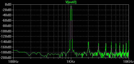

Single darlington line preamp.
Here is the FFT:
I can see a similarity to the VAS stage of a three stage (Linn topology) power amp.
Could this modified darlington be used as a VAS?
I'm thinking R1=100r, R2=68r, R3=390r, R4=3k6, running off +-50Vdc rails. R3 is way below the resistor gain ratio recommended.
Are the improvements in distortion available when used this way?
Can someone sym this? and optimise the resistor values?
What if R4 was replaced with a current source?

This circuit could be used as a part of extremely linear VAS. As Mikhail has mentioned the out2 point is this circuit is linear independent of the load impedance and could be connected to a low-impedance point, i.e. a common base/gate cascode stage. In the article I've mentioned Mikhail does provide some practical VAS applications of his idea, including a fully symmetrical VAS with no overall feedback and excellent linearity. I suspect you'll need to ask him to post these here if he would agree to it.

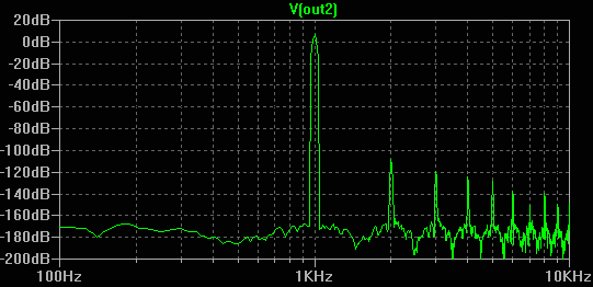

Its my opinion that this distortion canceling circuit is cool, but after investigation, its not very interesting.
A simple follower with a current source load shows better performance, no third harmonic, vs being down by only 110dB in the darlington per the post in the same simulation with a realistic 5k input impedance and 10k AC coupled load. I biased the follower at 3mA.
Besides this, the follower has power supply rejection capability. The follower does however require one more supply rail, but again, with decent PSSR.

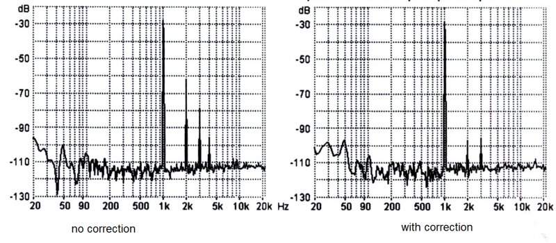

to Portlandmike
Figure of measured harmonics from paper illustrate what will be for "simple follower" or simple inverter without correction (left) and with correction (right) for the modulation depth of about 30% which is discussed.
A measutrement show THD of 0.15-0.2% and wide set of harmonics without correction.
Mikhail__K said:
to Portlandmike

My experience is that the current source loaded follower has much better performance than you show, both measured (beyond the limits of an Audio Precision system one or ATS-2) even when driving big loads, but big loads is relitive. Simulations are very good. I'd bias them to 10x of the max current required.
I simulated the proposed circuit (the 24V one) and a follower with +/-24V supplies. Ran the follower CS at 3mA and it smoked the darlington on distortion by 20dB or more.
Correction though, I didn't use a 0 ohm source, but a 5k source.
The distortion was present at the input, thus the main source is the input impedance. Perhaps you should use a buffer in front of it to deliver 0dB gain :)
Sorry, I'm sure I'm missing some point here, I just don't see its benifit. Is it that it has much higher drive? What is the target load? 50 ohms? Is it for a power amp stage? That might be useful then so you don't need to run it hard class A.
I'd be curious how you got your follower data to be so poor?
What was the current source? (or was it just a resistor :dead: )
Gotta make the CS good, low gain, wide band, and reasonable compliance.
I did a simulation with the circuit I've favored and the results lay over the distortion of the input, and those are down >140dB as I recall (its on my other computer at work now.) Your circuit had good results, but still much much more 3rd harmonic. Down 90dB as I recall, but 3rd, not second. I think 2nd is free to most listeners, especially below a percent.
