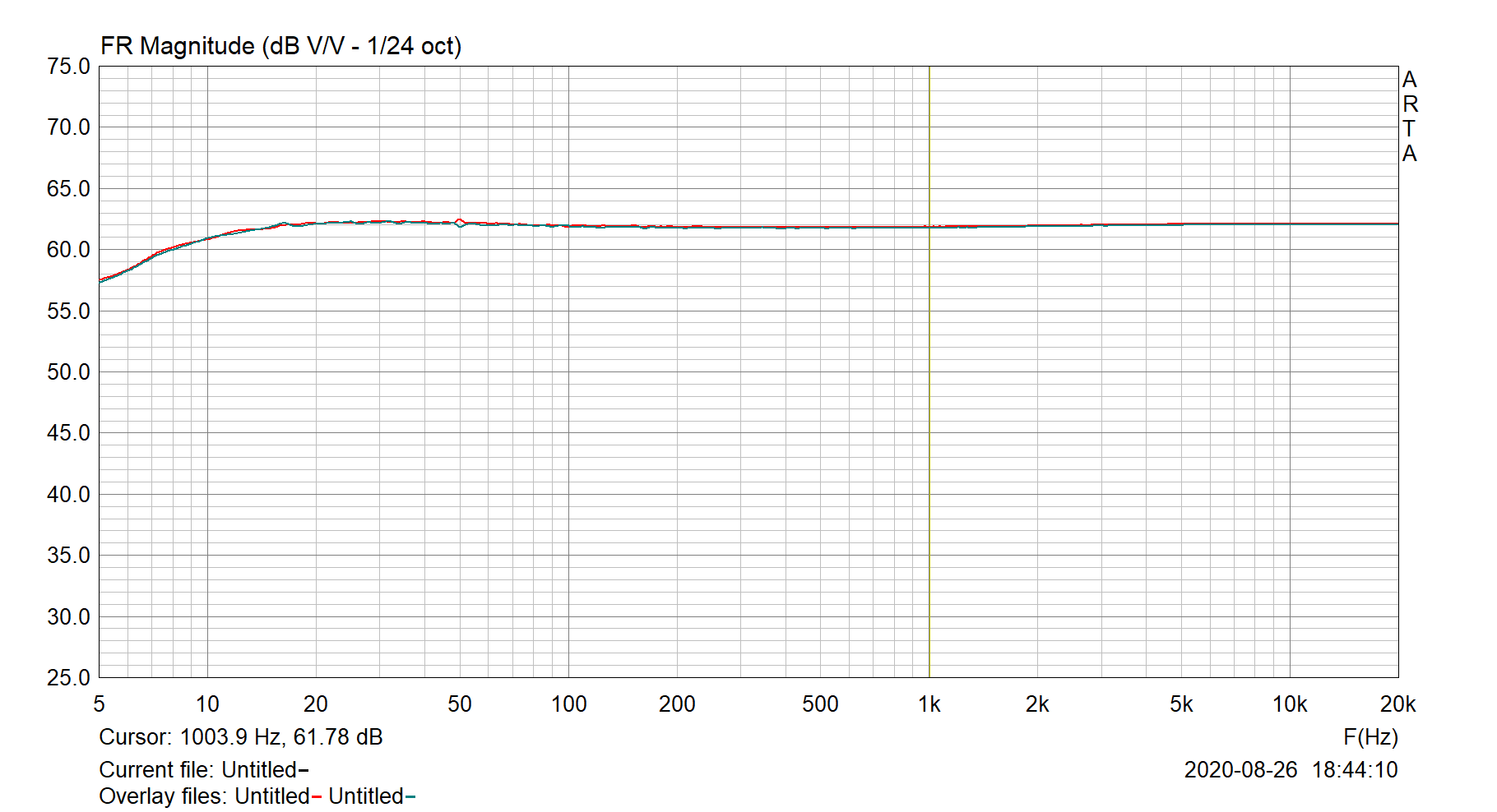

Salas thanks, I will try later with 300pF
Here is with your walues:
I will investegate the "rolloff". My ears are not able to hear the difference anyway. I think channel balance is more important.

If the voltage divider on the gen output sees many pF from test cabling it may weaken its signal level at HF on 220R load. Its a heavy load. Measure on 47K load too.
Salas Hi,
Connected up once more and it was clearly a measurement error. I might have increased the generator signal a little this time, but the cables where the same. Input load was still 220R:
