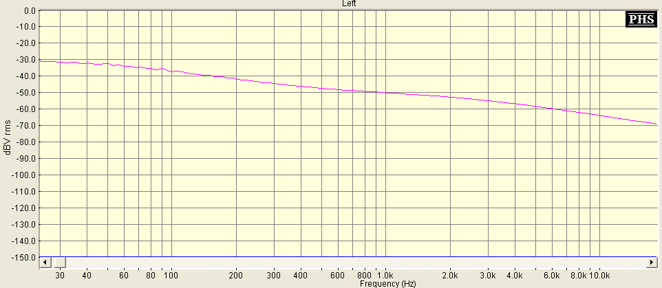

Hi Salas,
Have you plotted the accuracy of your RIAA network? Do any of the components need to be tuned for different layouts. Sorry if this has been covered before.
This has been a great thread now about a pre-amp using the same topology same regulator, of course.
Jam
Jam
Yes, I did. It is slightly tailored and sounds best for Steve Bench tube cascode and my ''Valve Itch'' Mu follower too, after many subjective tests with many TTs and MC carts in different systems. Of course this proves that the curve is good for different layouts, since it is good for different phono pre amps as well. Each version or different preamp has other values for some critical components in conjunction with the input and output impedance seen in each case. But they are all measured to conform with my ''reference'' curve. ''Lost Neumman time constant'' has been tested in all preamps, but it always sounded rather harsh BTW. Hence dropped.
You can see my Riaa curve measured in the attachment.

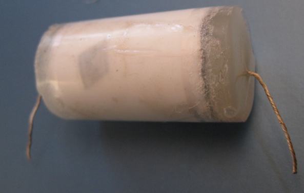

From jon L audiocircle
I was able to test the "nude" K72 that has been de-cased and de-posted (courtesy of Josh K), and I must say this version loses most of the hardness and etch of the stock unit. After a long break-in, the sound is almost creamy-smooth in the low-treble and upper-midrange while the detail and dynamics remain.
What I have always liked about the Russian teflons, including K72 and FT3, was that while they don't quite have the air and refinement of the VCaps or Auricap Teflon, they actually had a bolder and more robust presentation that projected more forward with arguably a more involving mien. Now with the nude mod adding smoothness, K72 must certainly be *the* giant-killer, right?
Well, almost. The nude mod ended up sounding a little too creamy and smooth up top. There was terrific detailing right up to the midrange, but the triangles, cymbals, and violin's upper harmonics did not ring clear in sparkling fashion. Wait! I have heard a very similar sound previously... It was the Audiocap Theta, and adding a small FT-1 teflon bypass capacitor was the sweet answer then, so I tried the same with the nude K72.
Holy Batman, now things were really cooking. Since FT-1 is basically the same internally as K72, adding the bypass did not result in any appreciable incoherence or distontinuity, just adding that last breath of air, upper harmonics, and sparkle. The resulting sound was at once robust, dense, detailed, and airy, while being as smooth as baby's behind. I really liked the results, and if you have some K72's, I highly encourage you to crack open the case and add the FT-1 teflon bypass.

FT3 sounds like a naked K72 or better without the stripping. If you cut both, you will see that the K72 has thinner Teflon. The difference in the highs is because of K72's sturdy steel (magnetic) can with glass sealed ends. It has some ceramic spacer stuff between the foil and the can also. The FT3 has thin aluminum can and eyelets. FT3 is bigger for same nF and has awkward flat legs.
While the differences are small as a percentage, there is a different flavor between the two capacitors. I like the K72 for being smaller and well packaged, having excellent speed and clarity. FT3 is just more fleshy and natural in the highs. Both are very serious capacitors, and undercut the brand name ones in a BIG WAY when considering value for money. Alas, they don't come in uF range. Using the FT-1 bypass discussed in the posted review over an FT-3 would be a hassle free experiment I guess.
I fully agree with these statements. (I have been using both kinds as bypass on the output caps of the CDP and FT3 sounds bigger, more extended and much more fluid... K72 is very incisive and good for guitar riffs )Salas said:FT3 sounds like a naked K72 or better without the stripping.
