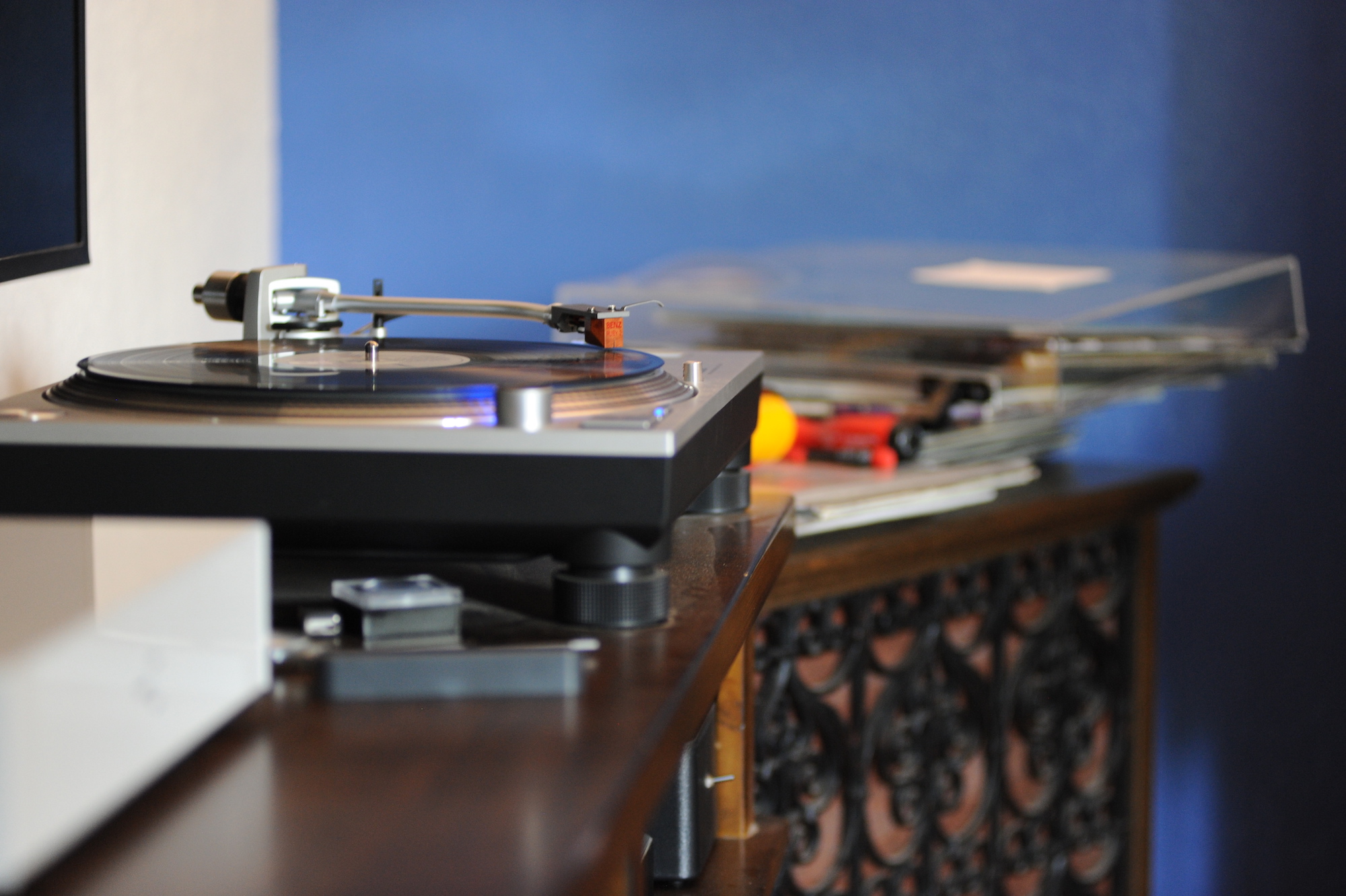

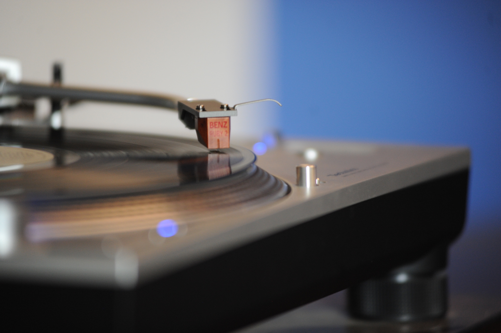

I was able to get the Ruby 2 for <$800 with generous return policy. The UFSP is amazing and I don't think I'm anywhere near pushing it's sonic limits yet and it is completely quiet at 62dB gain. Again, thank you Salas for such a great phono preamp.

Its a 45 Ohm cart if I am not wrong, so 470 Ohm to 560 Ohm load range test remains an option to be explored too. Keeping a compelling sound was the goal with those vintage Altec horn speakers. Some MC cart with exaggerated last octave response on even a mildly noisy phono would have been an epic fail on those.

It will get even better as you get to learn the cart for spot on set up details and loading. Did you use a weighting scale, protractor & test record, for geometry, VTF, anti-skating, resonance frequency check etc. or you simply trusted the Technics overhang gauge and the arm's dials?
I used the overhang method (52mm) with calipers since the Jelco has two pins and the Technics gauge only works with single pin headshells. I have a digital stylus scale and set the VTF at 1.8g. I added the auxilary weight to the pivot end on the tonearm. For VTA I used a index card with lines and hold it vertically on top of an LP with the needle down and leveled up the tonearm tube, it's a little finicky with the S-shaped arm but seems to work ok. I haven't tried a test record yet, I have a Shure TTR102 so I'll give it a try and get some more definitive results. For resonance I'll record some tracks with Audacity and do FFT on them to see the resonace peak, it seems to work well. Right now I'm just enjoying the music :).
diyAudio Chief Moderator
Joined 2002
You did things in detail and it tracks well. Congrats. Mainly the alternative loading test and possibly bit of C2Y curiosity when with that loading remains. The fast and easy stuff in other words.
About anti-skating, which can be controversial for method, LR signals must be equally loud on speakers is the goal. Vocals center well while the dynamics are free and imaging is wide and you are usually there. High frequency distortion on test record purpose tracks should spread the same between channels when done right.
Those Canadians are always charging more :D. I think I've entered the tail wagging the dog realm with the SL-1200GR. I really wouldn't have thought about a second hand cartridge previously but there has to be lots of good ones (and I guess bad ones too) just sitting in drawers, boxes and showcases.
I played with the anti-skate some more and I actually think setting it at VTF is pretty reasonable. I re-checked the alignment with a protractor, it was correct so I think the overhang method is also reasonable. I'm reluctant to mess with azimuth but the Jelco headshell does allow for it and included an Allen key.
