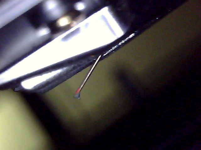

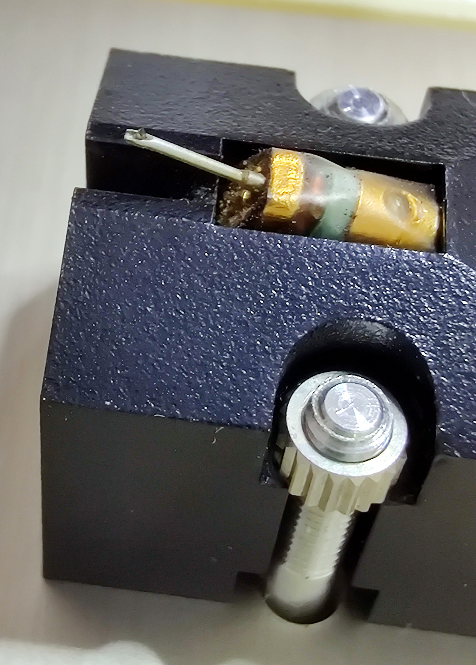

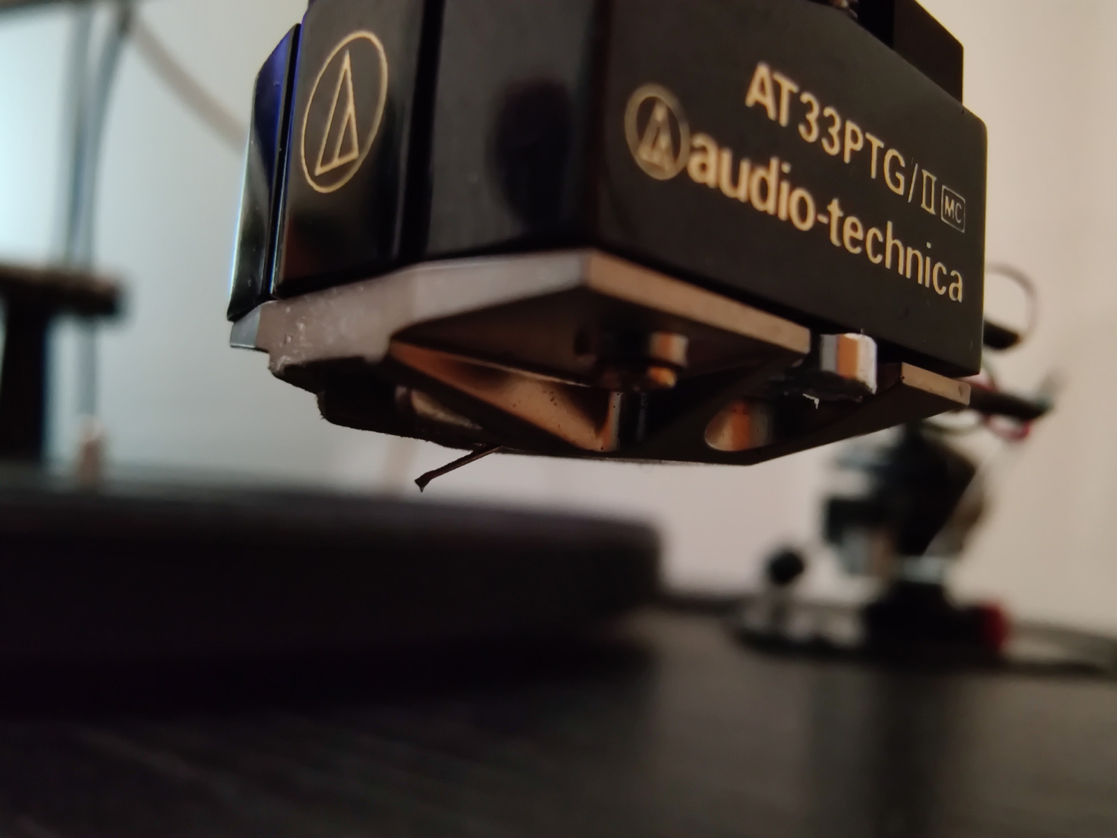

Can't wait to put the Denon 103 back in after getting a good sense of all three.
Denon will have the most characterful sound with its vintage design. Look at its 'huge' spherical stylus when compared to the AT33's tip. I was able to macro it on my DL-103R with just my phone.

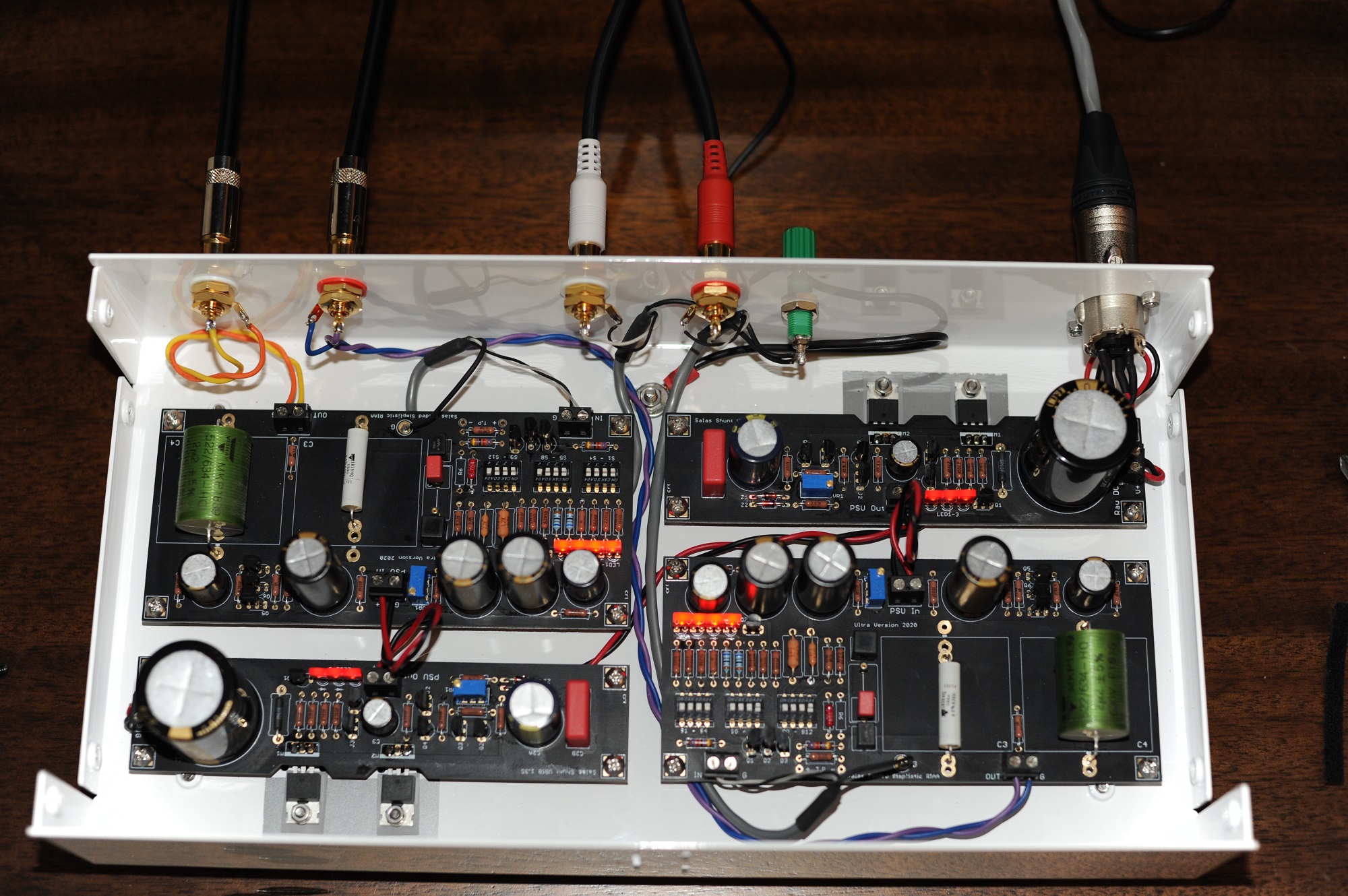

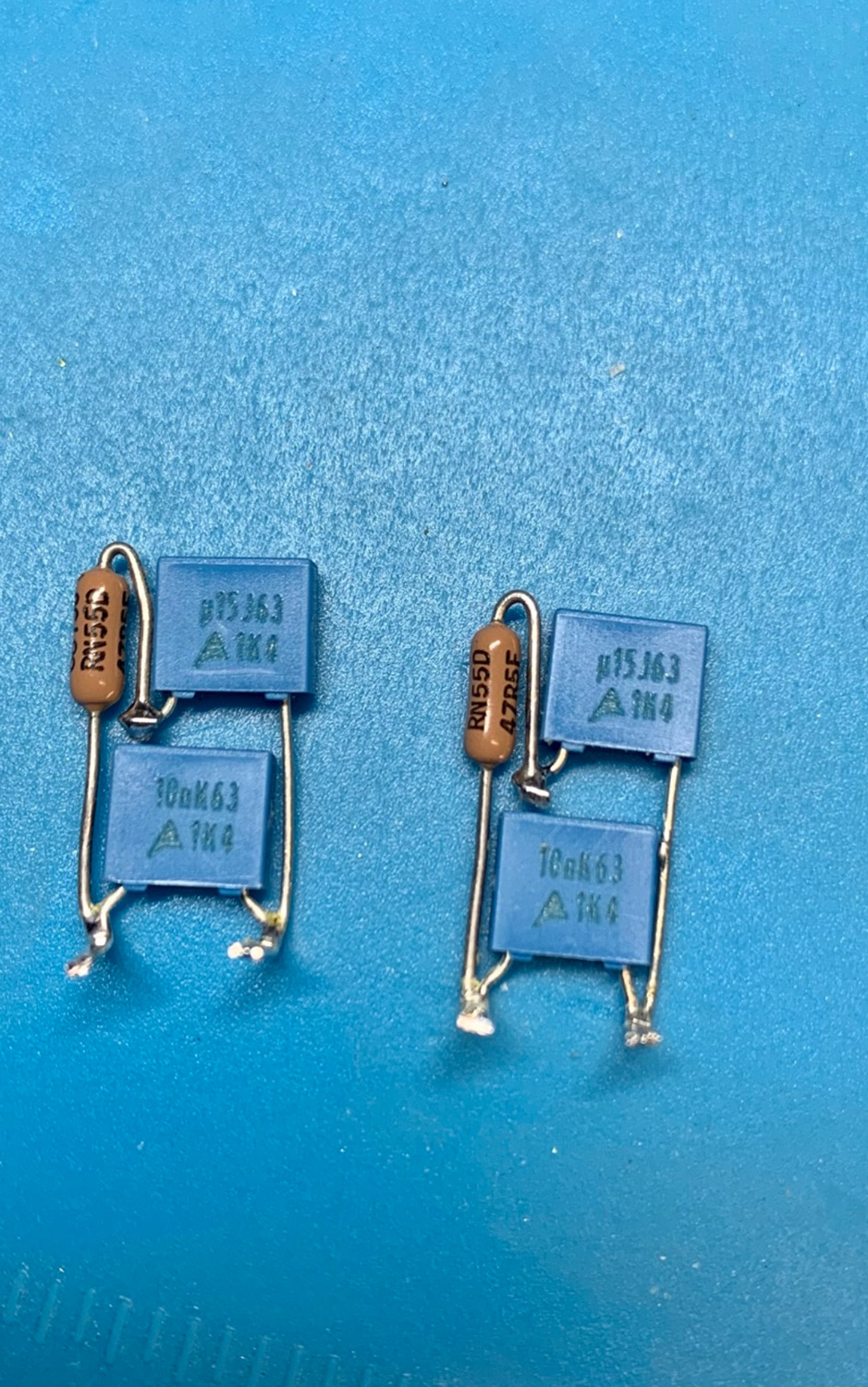

Completed the dedicated RAW PSU for Ultra. Now I can run it concurrent with FSP.
With new PSU I observed that 1. the system seemed even quieter than previous with my FSP PSU on Ultra (Was already superbly quiet, so this is almost more of an instinct, but there it is)
Maybe due to extra de-ringing RC components at the new transformer's secondaries that your previous build possibly misses?
Yes, good spot Salas... But, I have snubbers on both PSU build secondaries. The PSU differences are size and model of Antek transformer, the transfo can/shield, external umbilical is a different brand (Canare vs. Mogami) quad. Could just be the transformer itself? The new PSU has a less overkill transformer...50va 2x32 vs 100va 2x32? Wouldn’t think that would matter? But....high sensitivity environment in the amp?
diyAudio Chief Moderator
Joined 2002
Certainly has less of a field when smaller and canned. Are the snubbers of same effect on two different transformers though? FFT noise floor measurements on the same phono with one and the other Raw PSU connected when sitting at the same place could reveal if there is a true difference in quietness between using them.
I don't have any quantifiable verifications on the snubber effects—figure it can't hurt—and I understand some of the theory and it makes sense to me. I scope the transformer with Mark Johnson's Quasimodo jig and then use the CRC arrangement he came up with—R being determined by me with the scope and his jig—the caps are values Mark has outlined. So the R values between the different transfos aren't the same.

Since you tailored the snubbing with Quasimodo on the scope for each different transformer it should be adequate. No worries.

The AT33PTG/II is very neutral and really well priced. Neutral is not everybody's cap of tea of course but worth having to can quantify things.
pfallell, I just Q test-jiged my AS 0532's this weekend. What did you come up with. I was at 40.2ohms with defacto Cs and Cx. How did you get them in such a tiny space? And CRC? Wired direct? I am interested in Salas's take on this since he certainly set it up for without. Obviously has it fairly well covered somewhere.
Quasimodo test jig and scope is brand new to me so I have no idea if my value is correct. Way higher than on 4220. Thanks,

There were no Quasimodo equipped diyers back in August 2013 when the FSP was released. I put an EMI filter option though. Rd/link to reservoir capacitor. The sound wasn't harsh on any transformer with that RC so I relied on it. Trying further is not out of the question but comparing with and without some extra snubbers will allow you judge for yourself if making a difference you prefer.

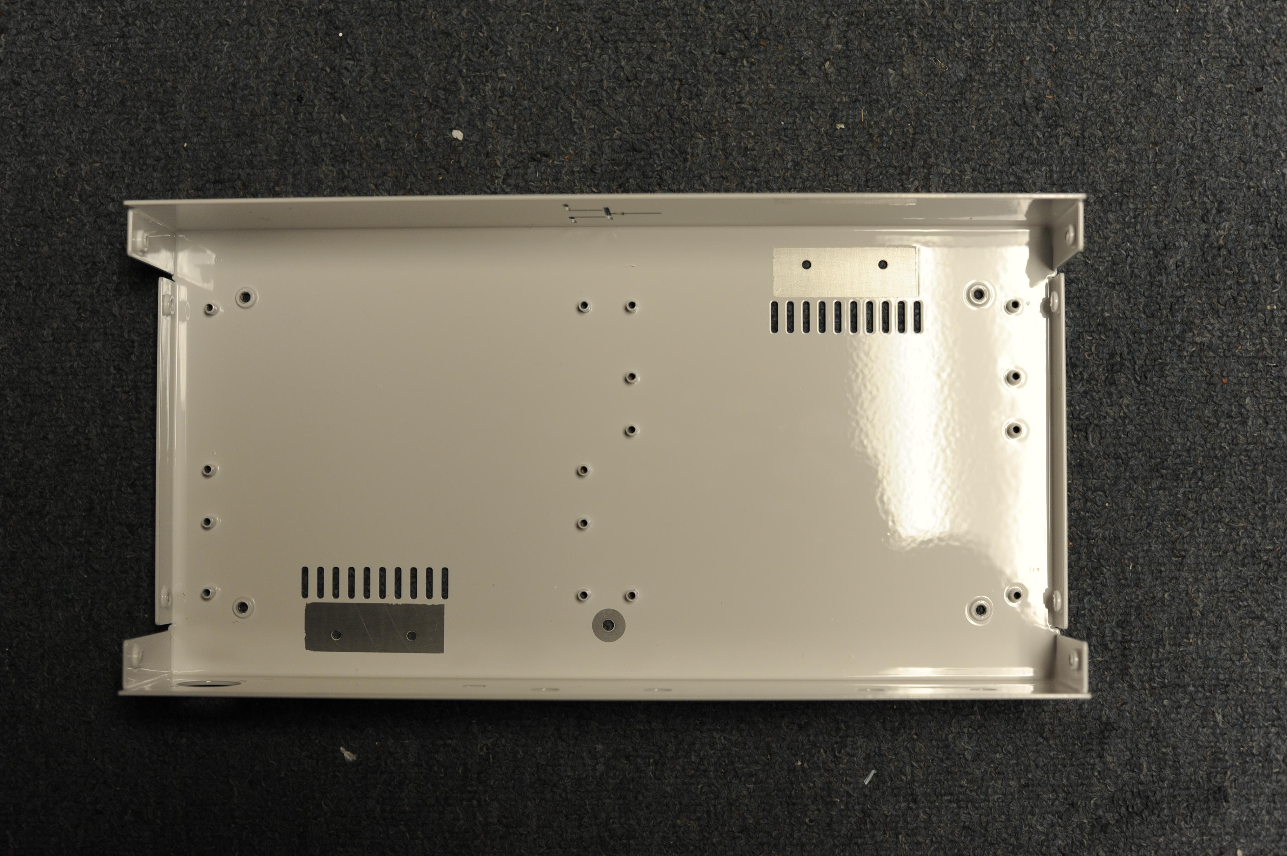

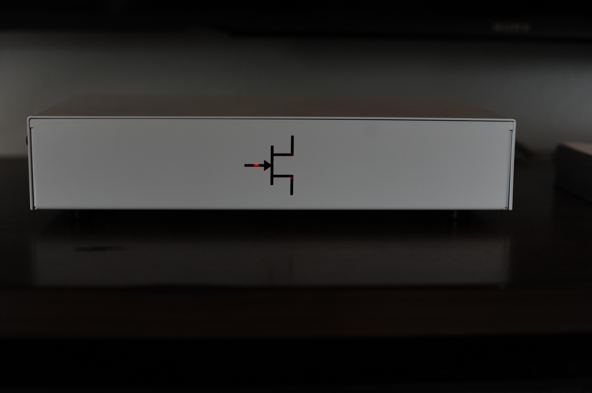

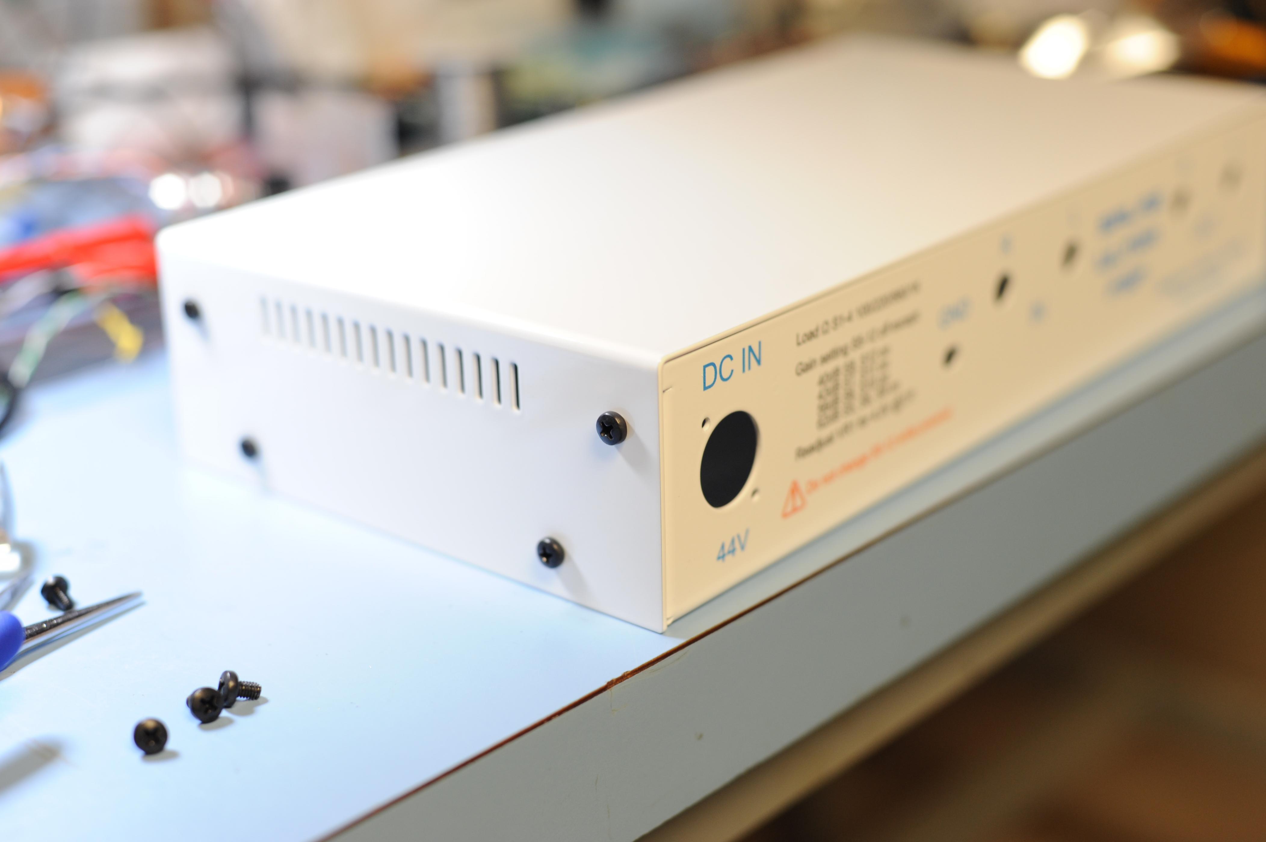

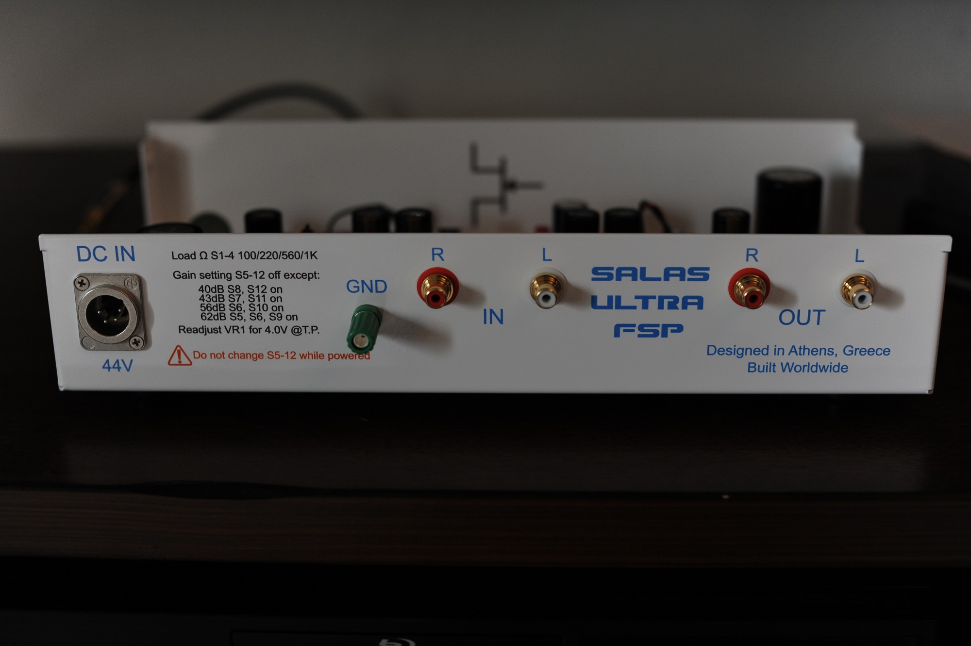

jphabc54, pfarrell and Salas thank you for the kind words!
jpahbc54, it was manufactured by Protocase, I designed it using their software and a little bit of CAD.
Salas, yes it does have a gentle glow in the dark.

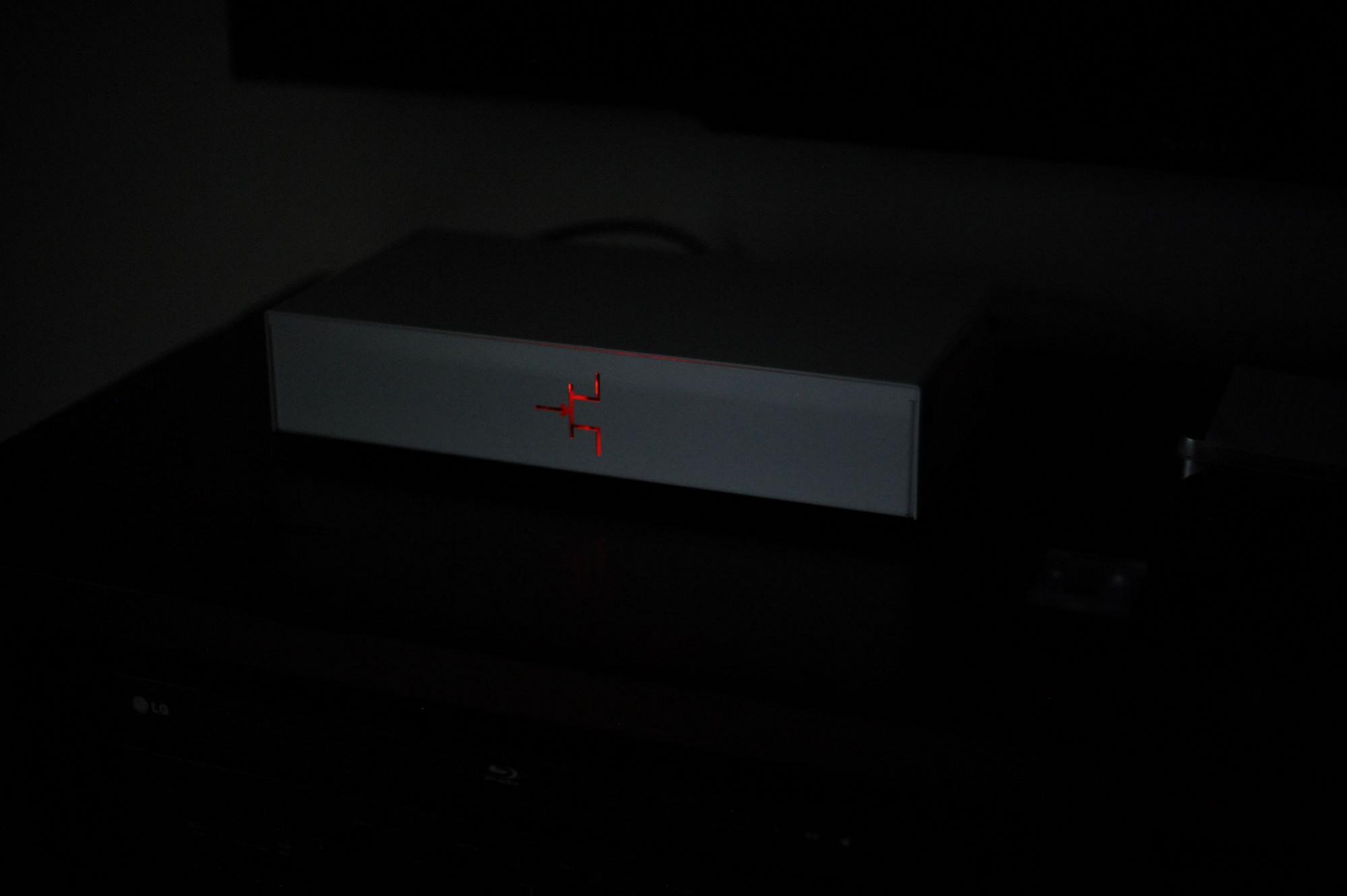

I ordered three, I'm hoping to build at least one more UFSP. All the setup is done so if there is some interest in a group buy just pm me.
Joined 2002

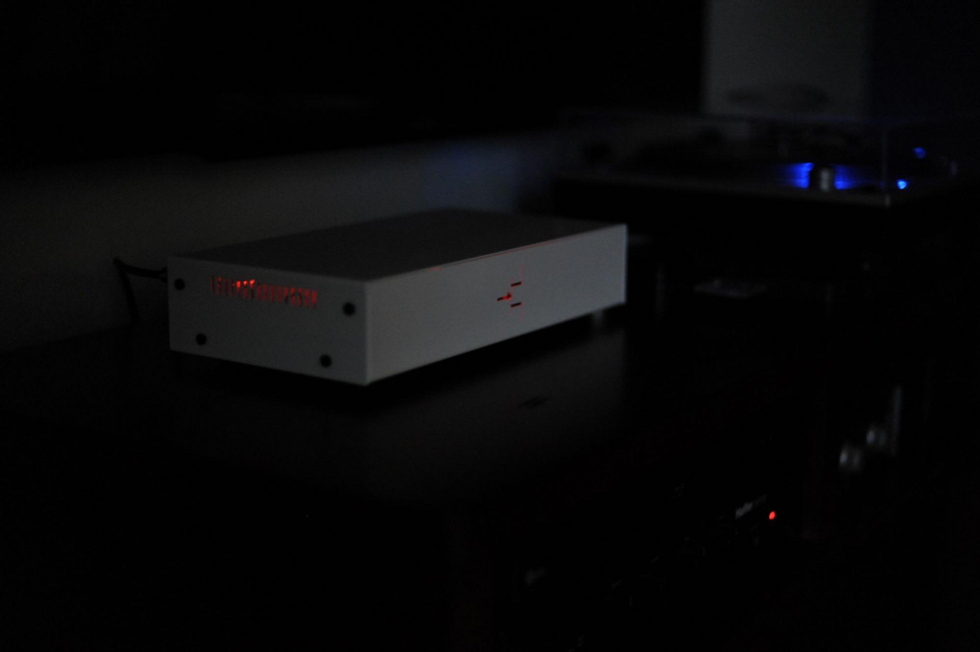

Such night glow is subtly inviting indeed. Does this small enough chassis become hotter than warm sinking those shunt regs, or anything has changed in the phono's background quietness after installed in it?
Was already quiet in open air you mentioned but just saying. Side screws bite thread metal through paint so the box has electrical continuity as a whole?
P.S.
pfarrell's starry night pattern drilled lid should allow some red glow to escape from the top in the dark (?). He didn't mention about it though.
