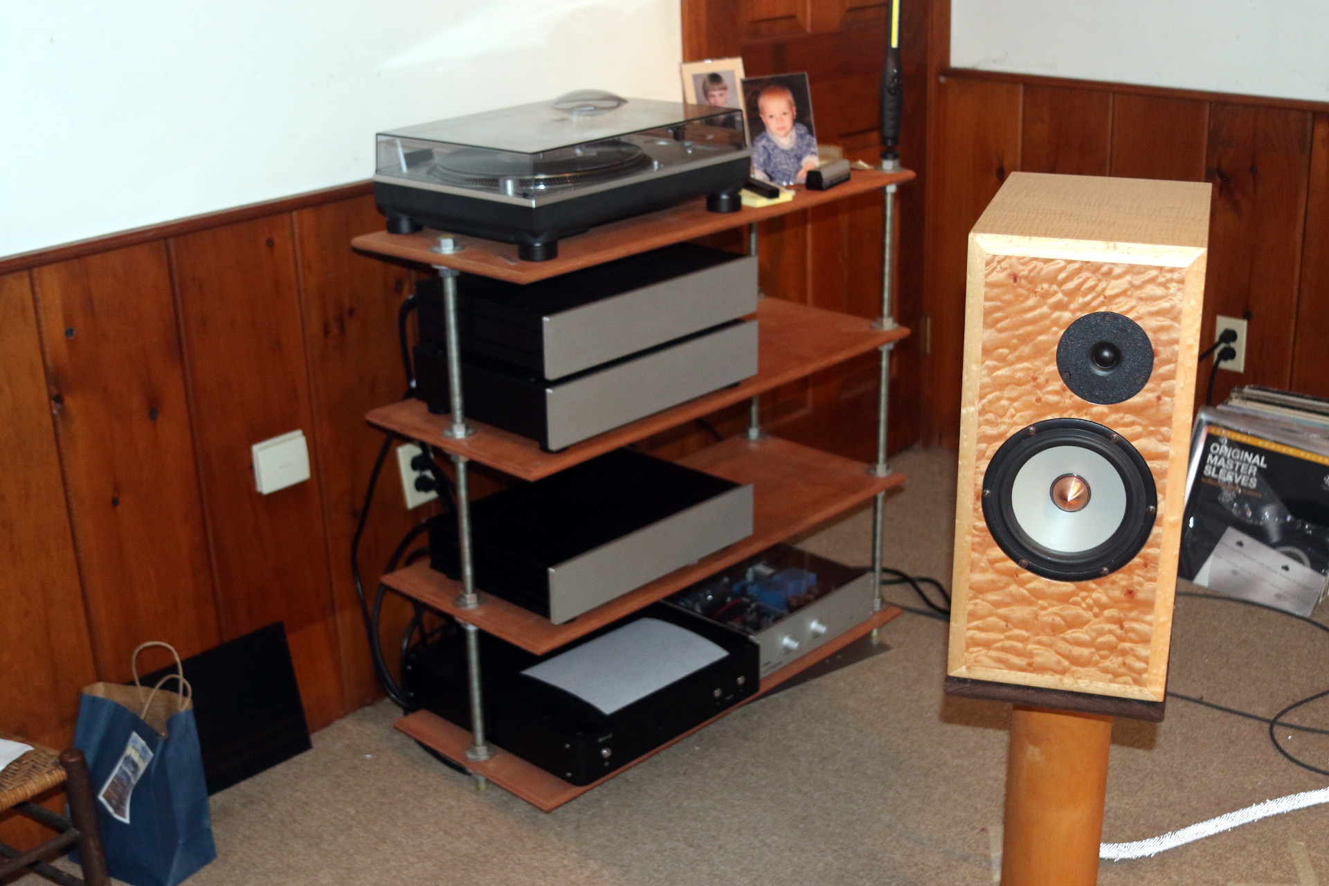

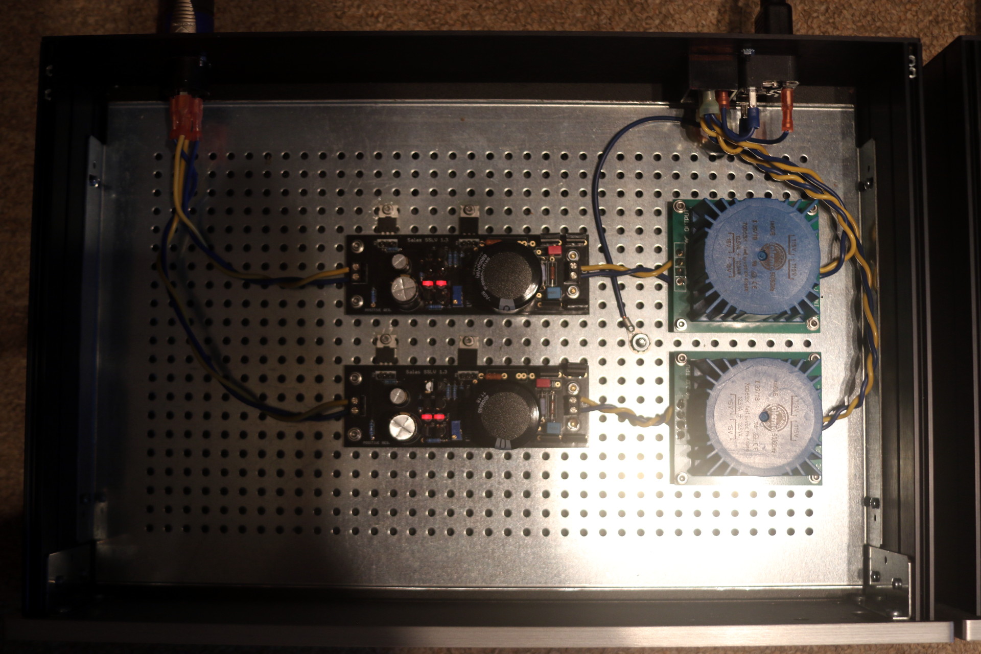

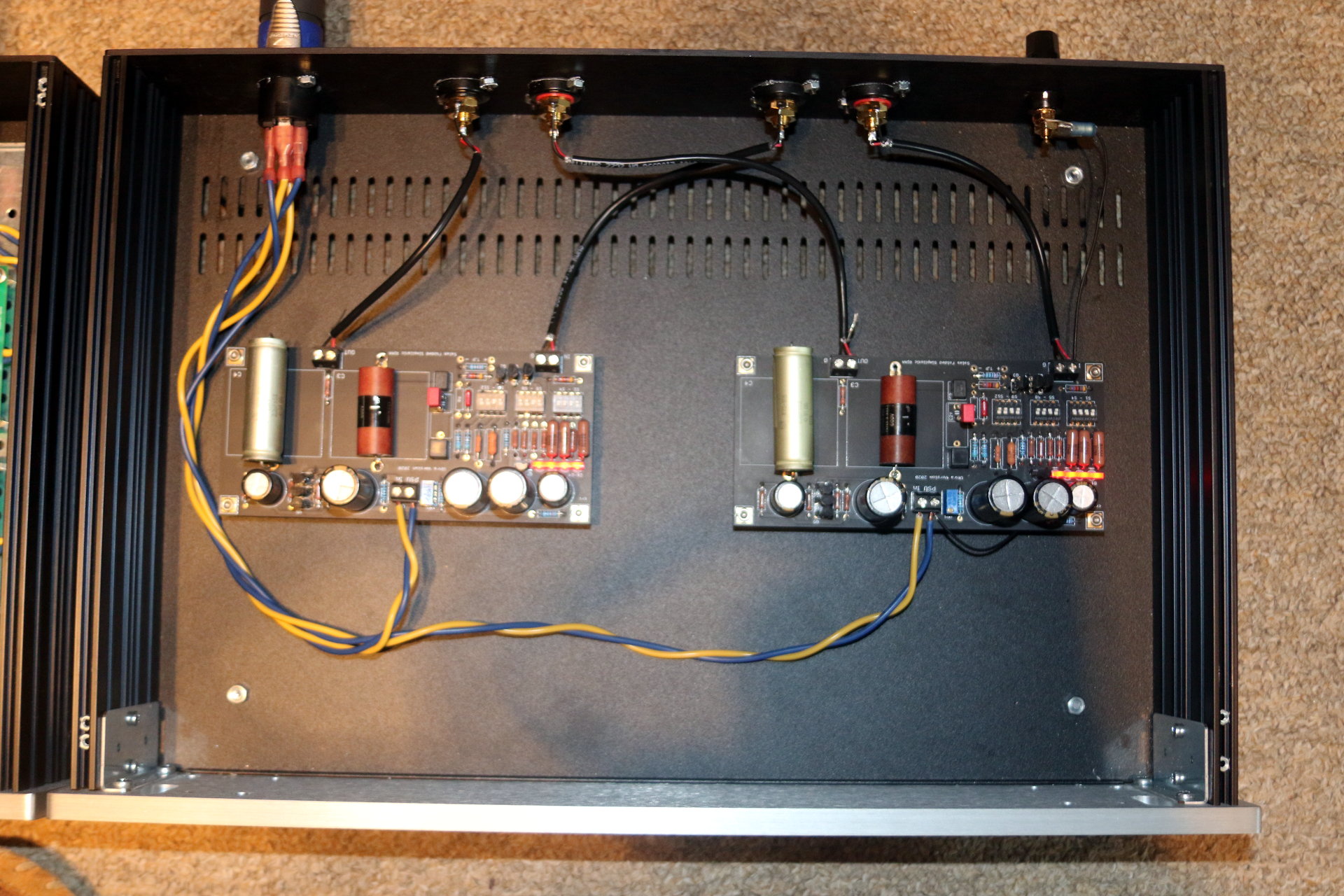

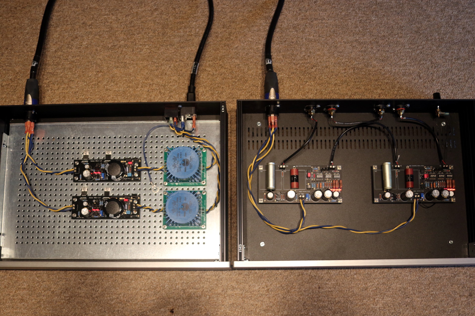

I finally took some pictures of my earlier UFSP beta build. These boards are a little different regarding regulation. I've been listening to the unit for about four months now and still find it absolutely stunning sounding. I would choose cases of a smaller width if I were building another one. Sorry for the lousy picture lighting.
The current analog setup is Technics SL-1200G with Hana ML -> UFSP -> Yarra / Melbourne preamp -> Aleph J mono blocks -> Ellis Audio 1801B. It's a very beautiful sounding combo.
