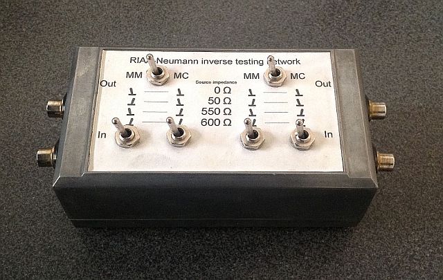

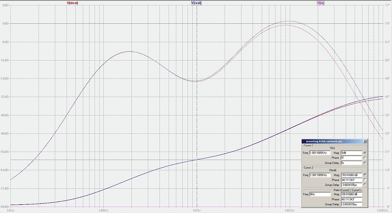

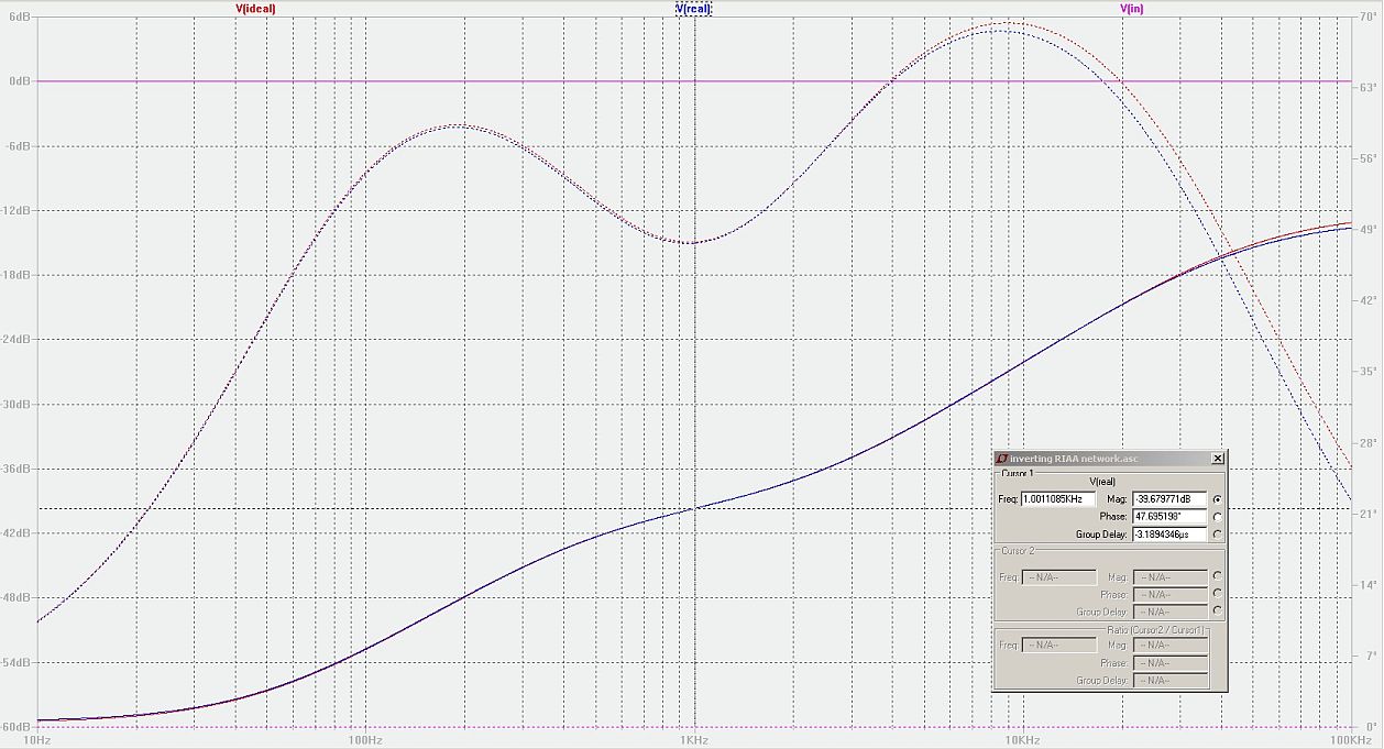

here´s the inverse RIAA I made 10 years ago.
One can switch between 0R, 50R 550R and 600R of source impedance, as well as MM level (-40dB/600R) and MC level (-60dB/60R).
Dimensioning after D. Colins Article "Tweaking the Passive Inverse RIAA Network" in AudioXpress 2007.
Parts are standard metal film and silvermica (stable, low tolerance, quite affordable from Reichelt.de) connected in series-parallel to reduce tolerance.
Diagrams show the diversion from ideal response (red) to real(blue).
A nice little gem that proved its useabilty many times. ;)
jauu
Calvin
