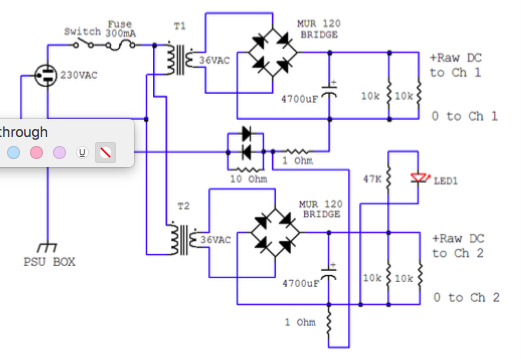

AndrewT has got me thinking.
I don't like the Idea of connecting both Phono power grounds together in the chassis. This will create a ground loop. Isn't it better to have the left and right phono to be grounded at the supply (Isolated PE) and connect the chassis together through the shield in the umbilical(non-Isolated)?
Another idea is to combine all 3 grounds at the supply and use one wire to the boards and chassis (isolated).

We want as close to dual mono as possible. The PSU for each channel has a V+ and a return. You could use a single conductor and shield as return, or you can use a twisted pair for send and return; if it's a shielded twisted pair then where do you connect the shield? The suggestion from Salas is to connect that shield to the PSU chassis.
I don't see how one would have a ground loop by connecting the two 0V lines to the ground post; that is the only place they connect.
For the main chassis I guess you have two choices: either connect it to 0V or connect it to safety earth. If the latter then should the TT ground post be isolated from the chassis? After all it connects to 0V which we isolated from safety earth at the PSU. I guess the alternative is to connect the main chassis and ground post to safety earth but not connect that to 0V reference on the amplifier boards. I wonder if anyone has tried that?
They connect at the supply. 2R is not going to separate the loop.
Sure it is. Current will take the path of least resistance, and the DCR of the return wire should be well below 1R.

I think your second and fourth points contradict. If you are using the umbilical shield to connect the amp chassis to safety earth, then the chassis is no longer at 0V but at safety earth potential. There should not be any current flowing through the shield so those should be at the same potential, but you have bypassed the diode/resistor network by directly connecting safety earth and PS 0V.
I don't understand what component your saying is bypassed. Are you saying the arm grounded to chassis won't be at 0V and is at safety earth potential?
So the fix for that is to connect one phono PCB ground to arm (isolated). Although one must keep the turntable ground separate to avoid EMI from the motor.
Look at the raw power supply schematic. Not only are the two 0V lines isolated from each other by a pair of 1R resistors, but the junction of those two resistors is isolated from safety earth by a network of a pair of reversed-parallel diodes (yin-yang Salas calls them) in parallel with a 10R resistor.
Now if you extend safety earth to the amplifier chassis, and connect the 0V lines, the chassis, and the TT ground wire at the ground lug, you have directly connected 0V and safety earth, bypassing that isolating network.
The way Salas recommends in the build guide is consistent and produces good results. But this is DIY and I encourage you to try alternate schemes. Just be sure to try the method suggested by Salas for comparison.

Well after testing the 2 ground options:
1.-safety earth to phono chassis, phono PCB individually grounded by supply 0V
2.-supply 0V to phono PCB, phono PCB ground is put to chassis . (as per manual)
There was no audible difference. The first option is easier and more tidy.
The biggest noise maker for me was caused by the power transformer. I'm going to try to have about an 18 inch gap from any transformer for near silent operation at full volume.
