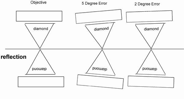

I set VU for highest sensitivity and use them to set my azimuth. I play mono or stable mono 1kHz and I'm trying to see if cart reads same on L and R.

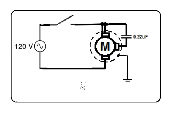

I still do not understand what should/might be done in order to minimized that "boom" sound from TT switch off. High or low pass filters constructed as RC, simply based on rotation of R and C when one of them in series to current and one between current and return. How to implement that for our needs?
One way is as Andrew advised, to use 0.1uF and 100R in series between L and N close to switch.
Did not test that yet, but I will..
Other way is to use that tandem across the switch, but to lower C to 0.047uF and to increase R to ?, in order to lower switch bypass current that "anger" my sensitive to low current motor.
Any corrections or other ideas?

Hi Alex,
Try placing a 150V Metal Oxide Varistor (MOV) across the primary of the power transformer. It will clamp the voltage across the primary (and therefore the switch contacts) to a lower level. Without the arc, the noise should be lower and the switch contacts will last a lot longer.
Side benefit. If you have a lightning strike or surge voltage, the MOV will help to clamp that spike to safer levels. Note that a fuse is required in it's normal place because the MOV sometimes protects by shorting out.
I used to use the 130 V MOVs, but with our mains voltages creeping up you should go with the 150 volt rated ones. Remember to solder this part directly across the transformer primary wires. The fuse and power switch are wired in away from the transformer, closer to the power line.
-Chris
The cap allows AC through to your motor. So you may hear the motor make noises as appliances turn on and off on your grid. Furthermore, this movement will occur while the motor is stationary and may cause faster wear, because the protective oil film that develops during movement is not present.
I agree with the suggestion of MOVs.
How to connect MOVs. Please see my drawing. I have 2 primaries and one connects via Cap.

Andrew, my compliments and you was absolutely right. It works like a champ! I teased it during listening of my records during last 3 hours and I triggered off switch about 10 times (shortly after start and longer time waiting after LP side swap). Absolutely quite!!! No any impact to the motor actions either. At least, I did not notice about any...
So, 0.1uF X1 Rifa and carbon AB 1W 100R across L and N resolved my switch "boom" issue during power-off action.
Did not test MOVs, since I'm very satisfy with RC now.
Thank you a lot.
