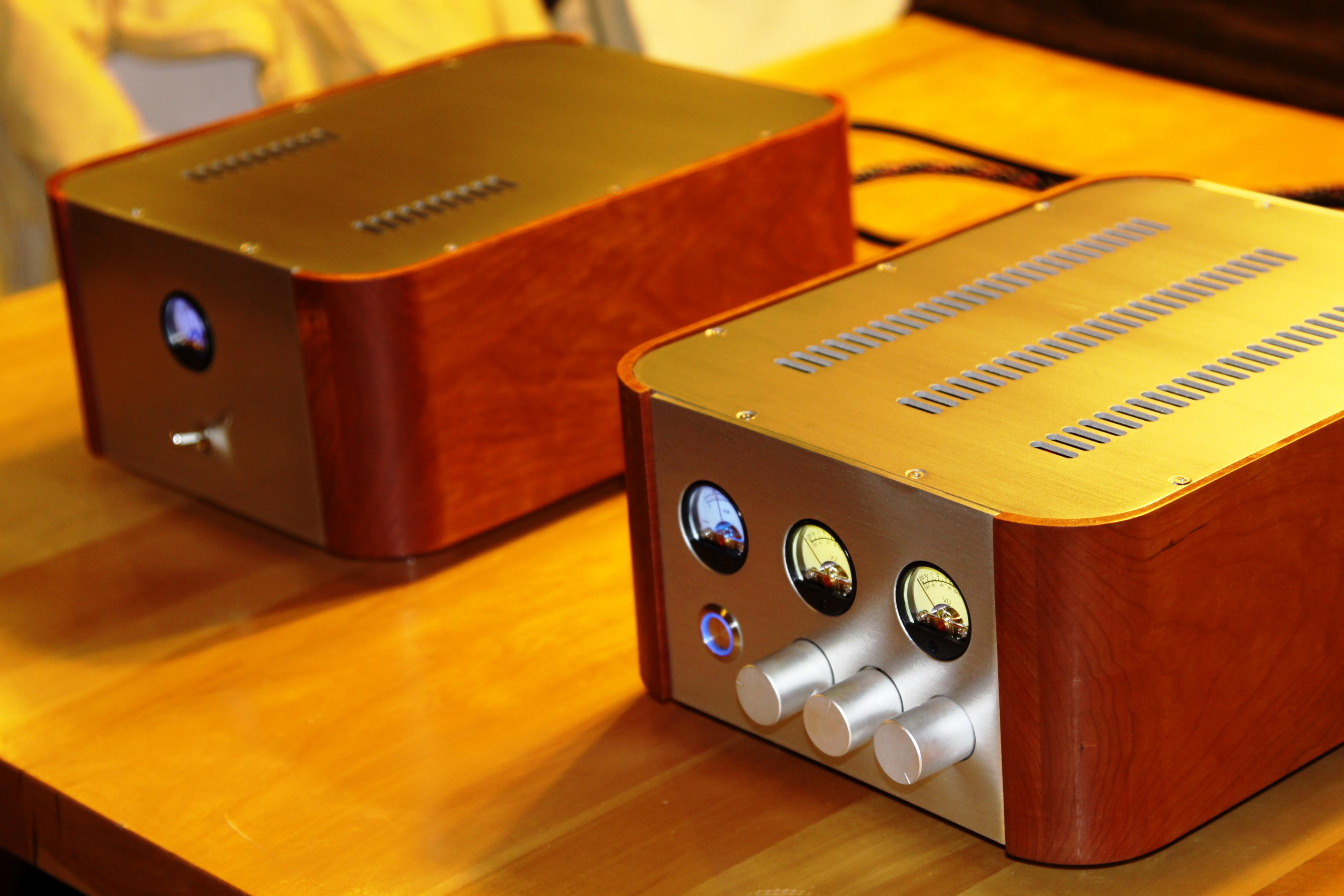

I got everything set for 60+ dB on FSP and my sound is perfect. I never got such detailed and live-like sound coming from my TT. So, the NOISE that I was fighting for so long is gone and it was coming from my damaged cart's coils. Man, I suspected and tested, and changed so many things assuming it is PSU ripple, GND loop, bad cables, RF and EMI....
It was cartridge!!!!
I'm more than happy with my setup now.

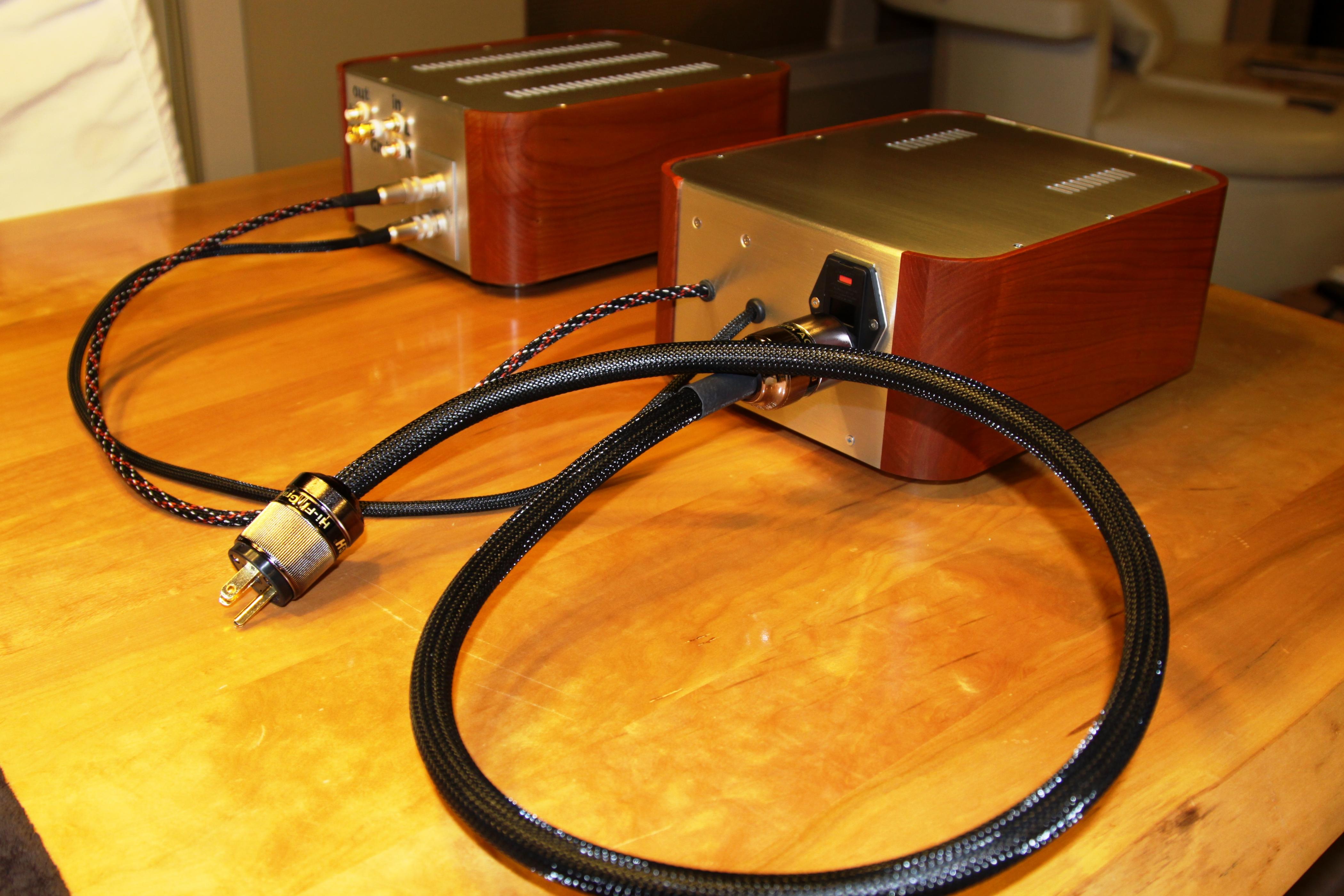

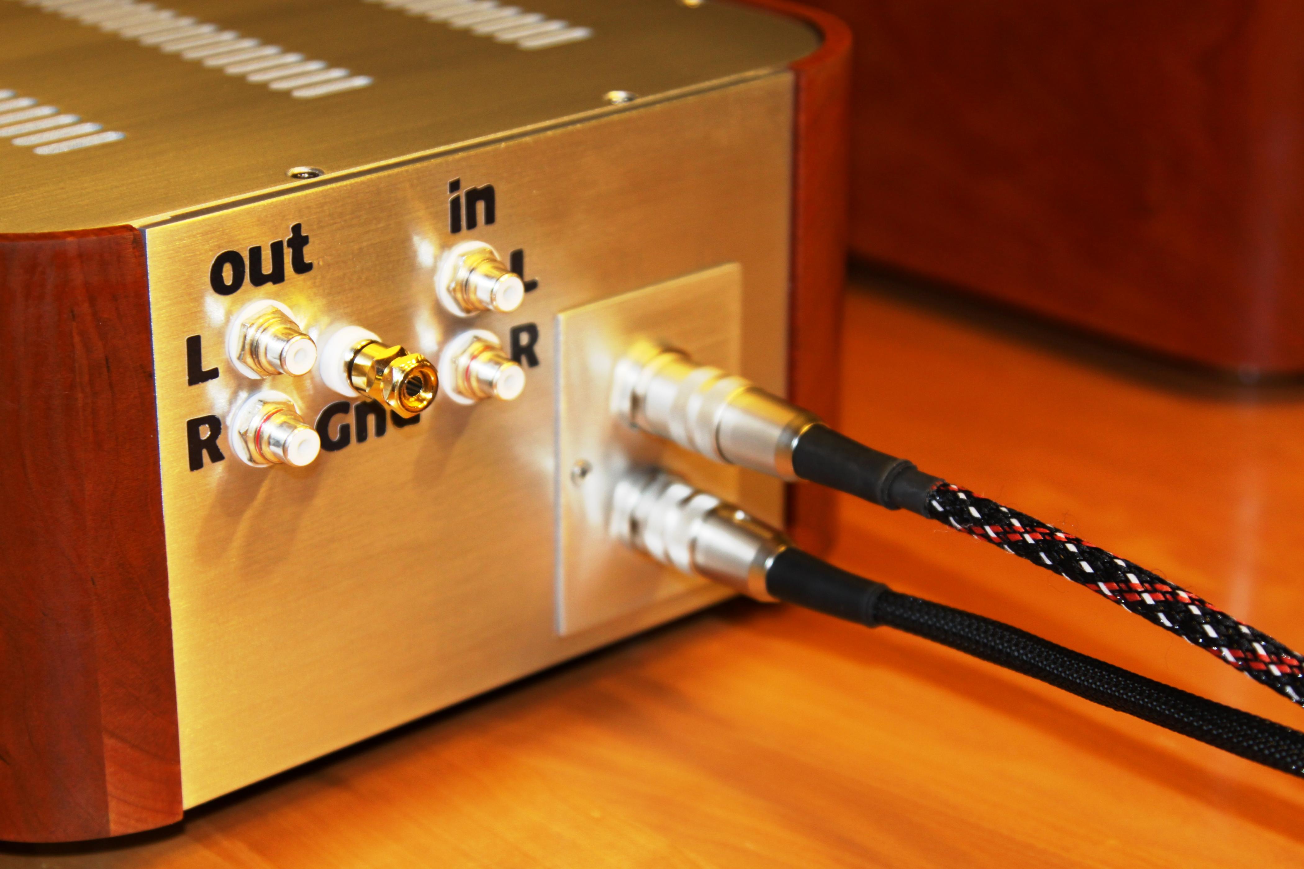

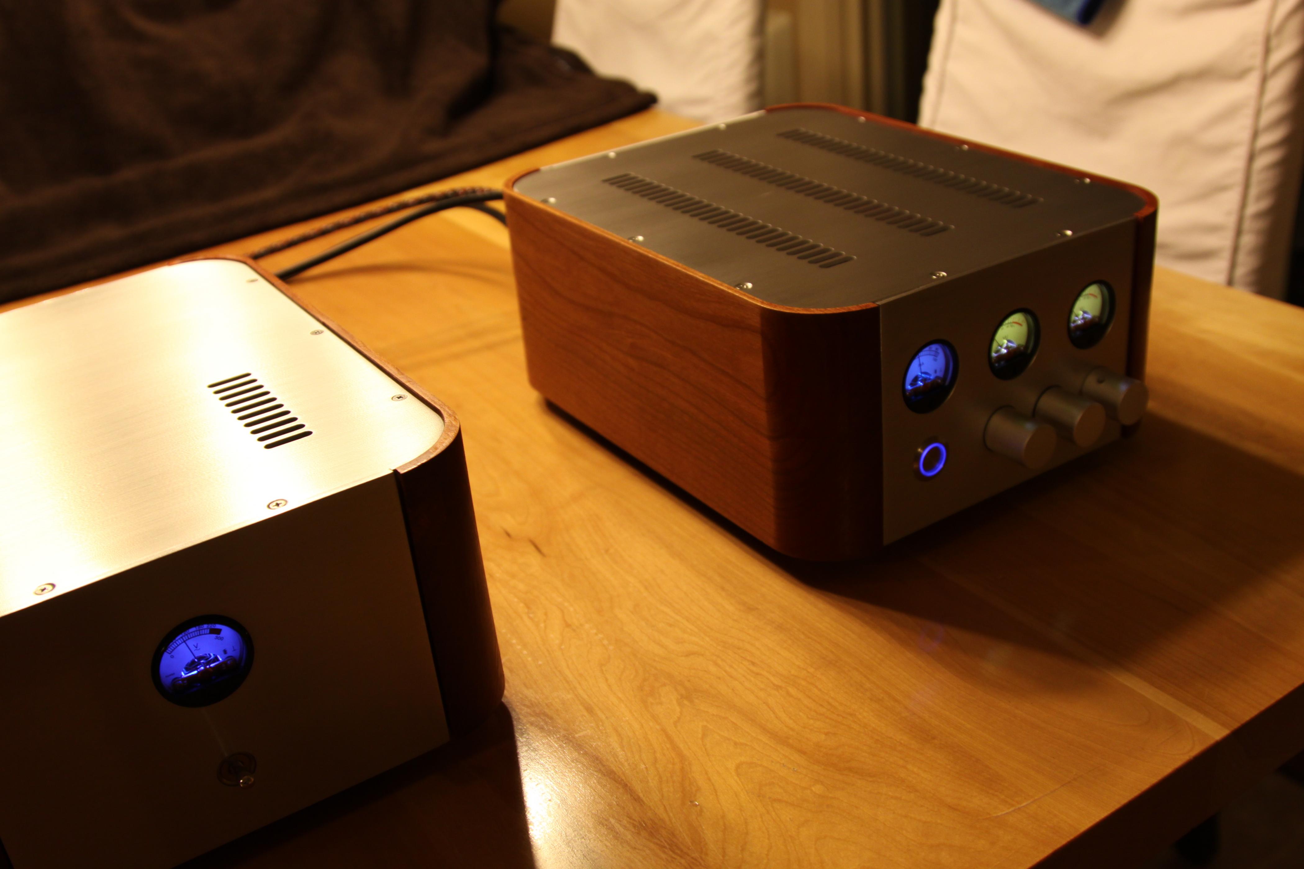

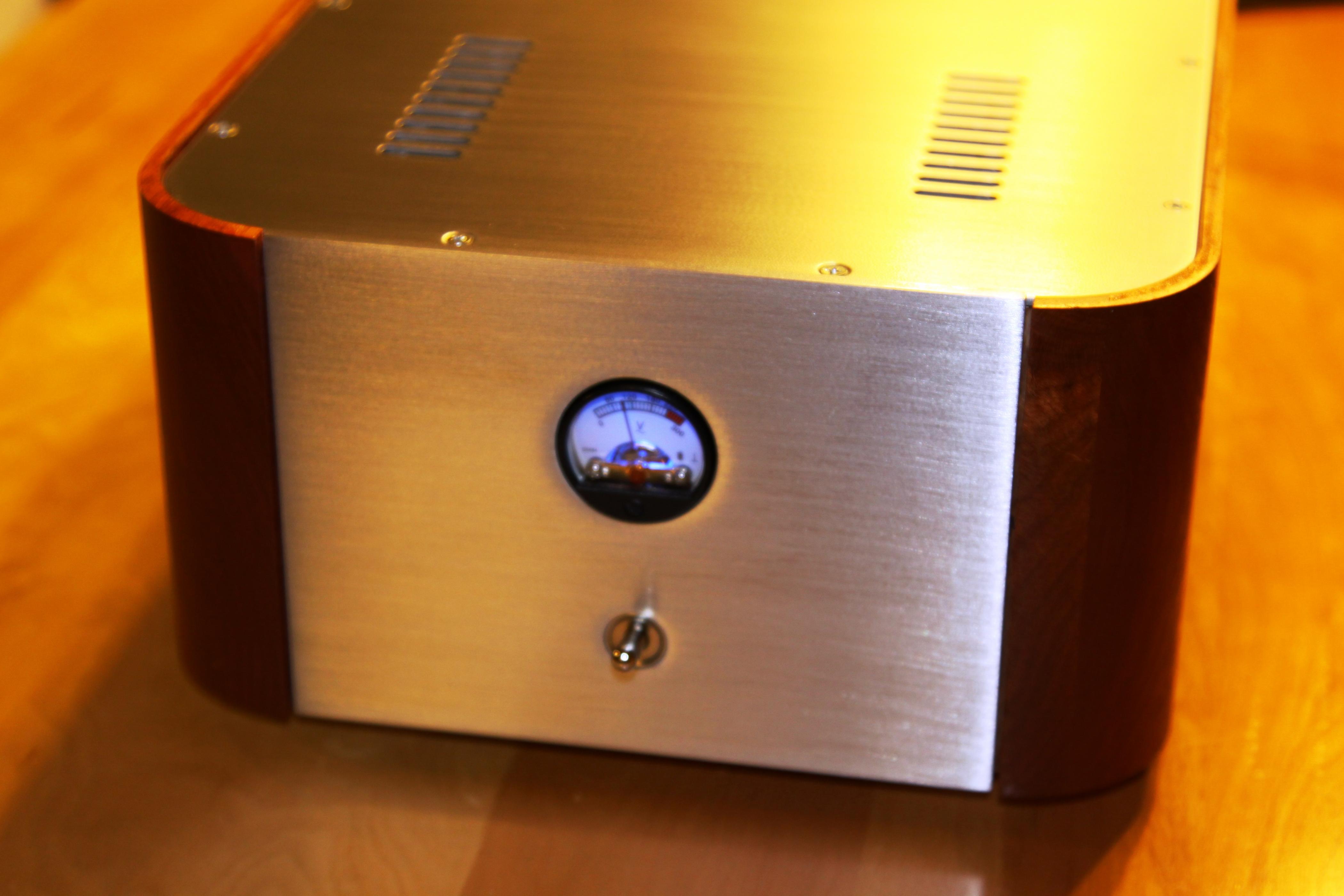

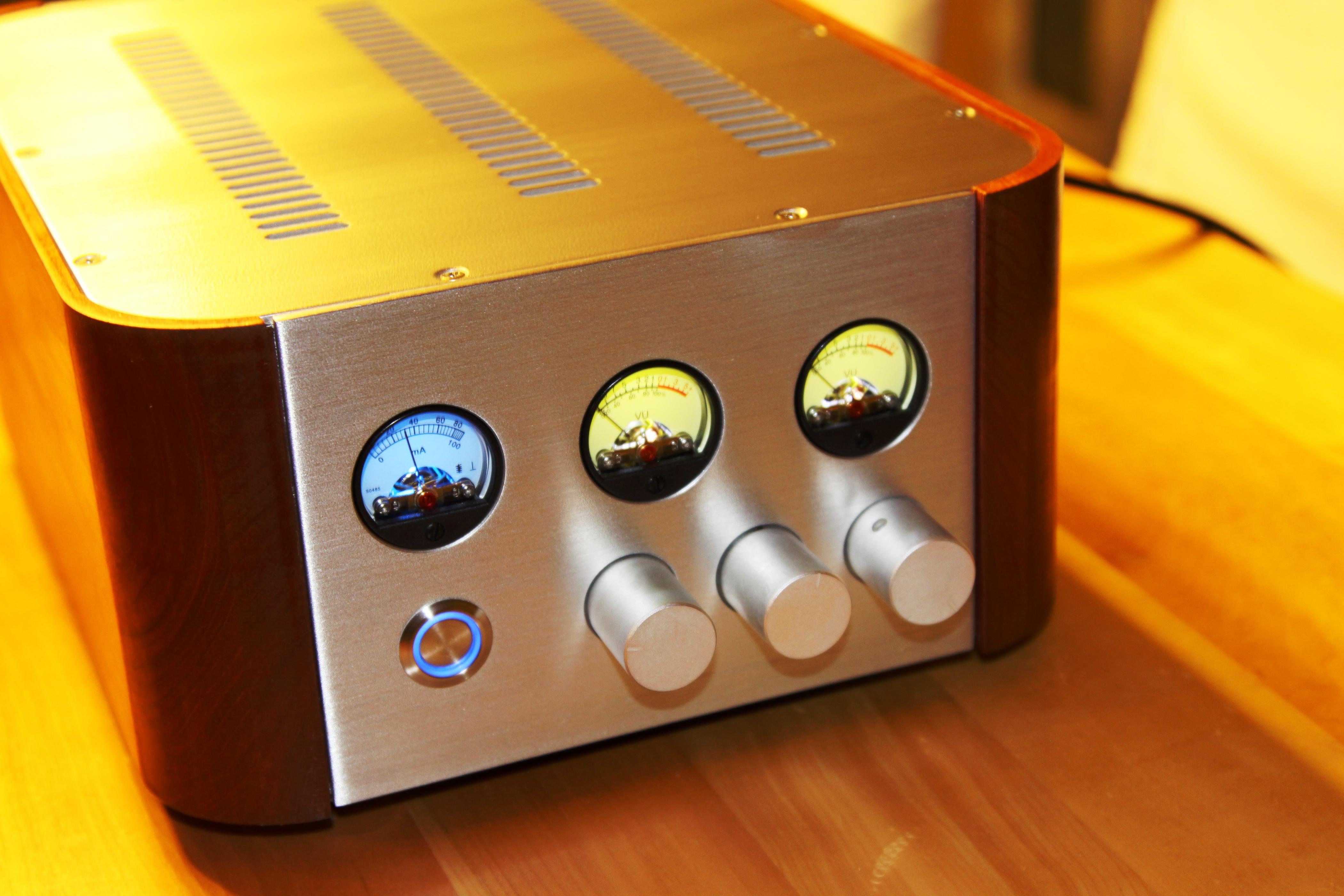

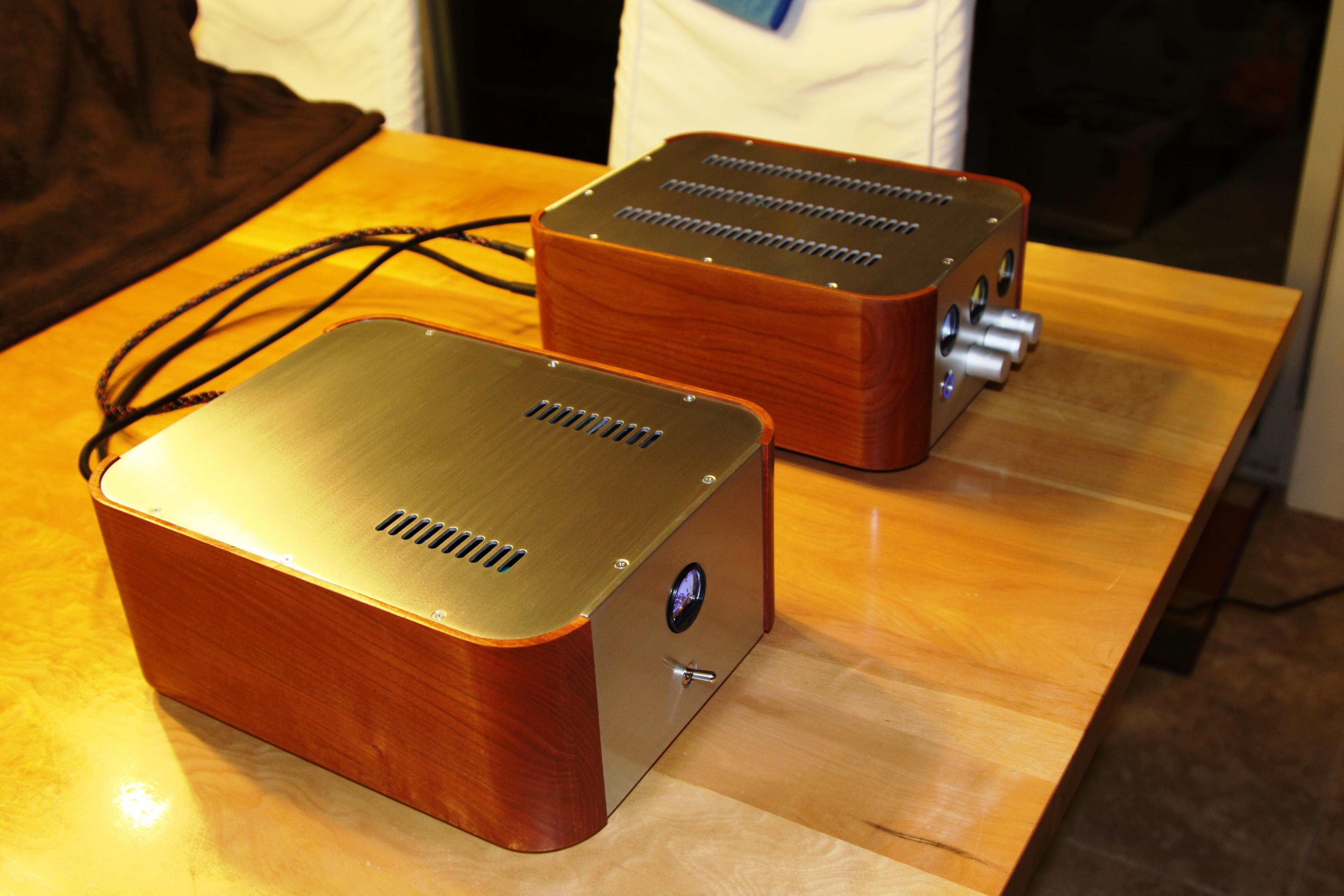

Please see my build pictures (as Salas asked) taken about 6-7 month ago when I just finished my FSP. I already uploaded them once, but for the guys who did not see....
Couple changes vs. to what I have today in my FSP:
1. R13 is Mills MRA-5
2. R1X is Caddock MP930
3. C2X is EVO Aluminum Oil, instead of EVO Aluminum

Hi Alex,
Thank you for posting those pictures. I LOVE your case, it's exactly my style. Too bad I couldn't match your work in a million years. You have more than enough reason to be proud of your work. I am serious, it's lovely!
Mine will be done in a way that might be acceptable to be seen. I've been playing with the idea of putting my next projects into test equipment cases, the older HP style. Cosmetics aren't my strength.
-Chris
Hi Chris,
Thank you. BTW, these boxes purchased raw from some guy live in Quebec about 2-3 years ago. He retired and does not make them anymore. Very nice enclosures and easy to work with. I buy boxes from eBay too. Not bad actualy. Please see this one. I just use it for my first made phono called BHL.
BZ2409H Silver Full Aluminum Enclosure Mini Amp Case Preamp Box PSU Chassis | eBay
I asked that guys to send me one with the IEC opening for PSU and other without any holes it for Phono. Not bad quality and quite easy to drill.
I also use his feets. They kinda of small, so you can use 40mm diameter if you want.
4X Aluminum Feets for Power Amp with Rubber Ring D 29mm H 15mm | eBay
