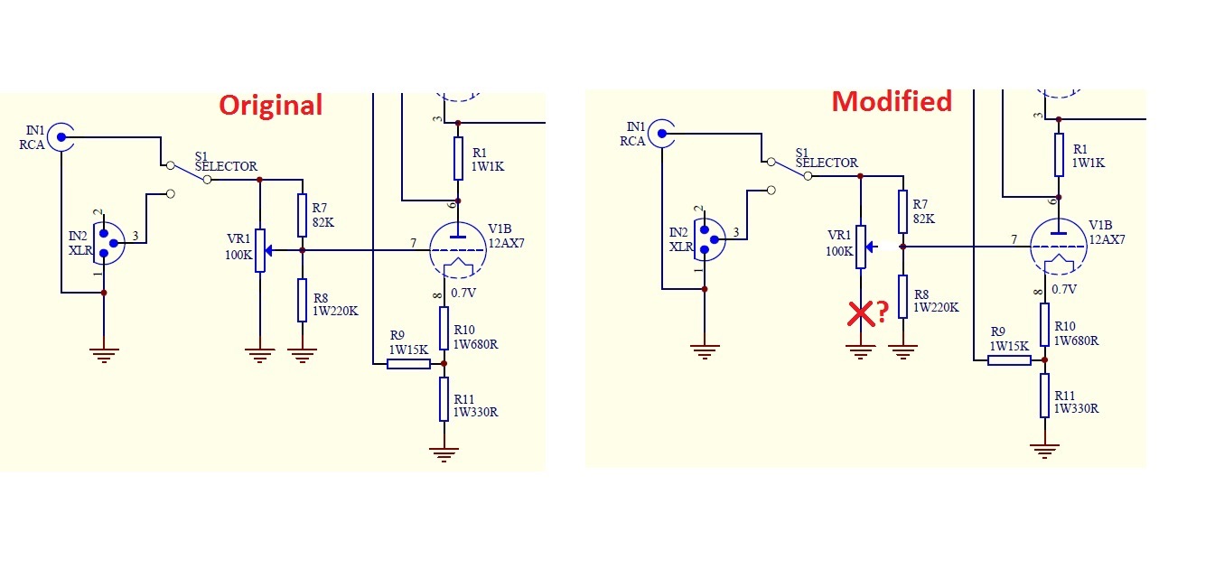

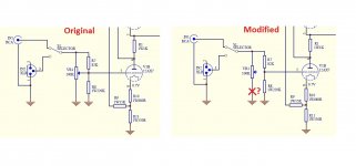

If I were you I would cut R7 and R8 in both ends because this network can work as a variable high pass filter in combination with an output cap on the source.
Thank you for advice, but I decided to resolve that case with very simple solution. May not the cheapest one, but simple... I replaced both Alps in 2 monoblocks with 100K Mini-V Goldpoit step attenuators. Easy mod vs. disordering resistors and creating all needed bypasses. It was a mess since all these parts were soldered on mail PCB. Thank you.
