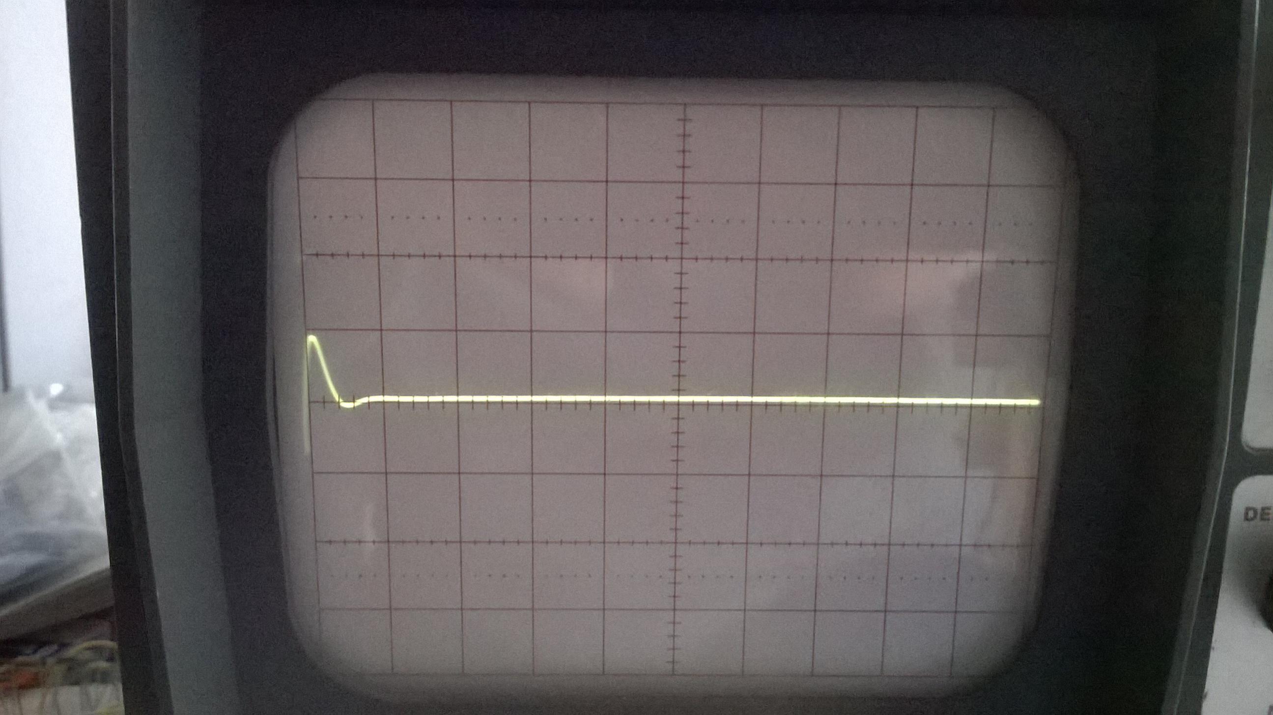

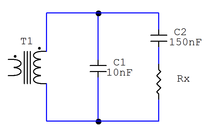

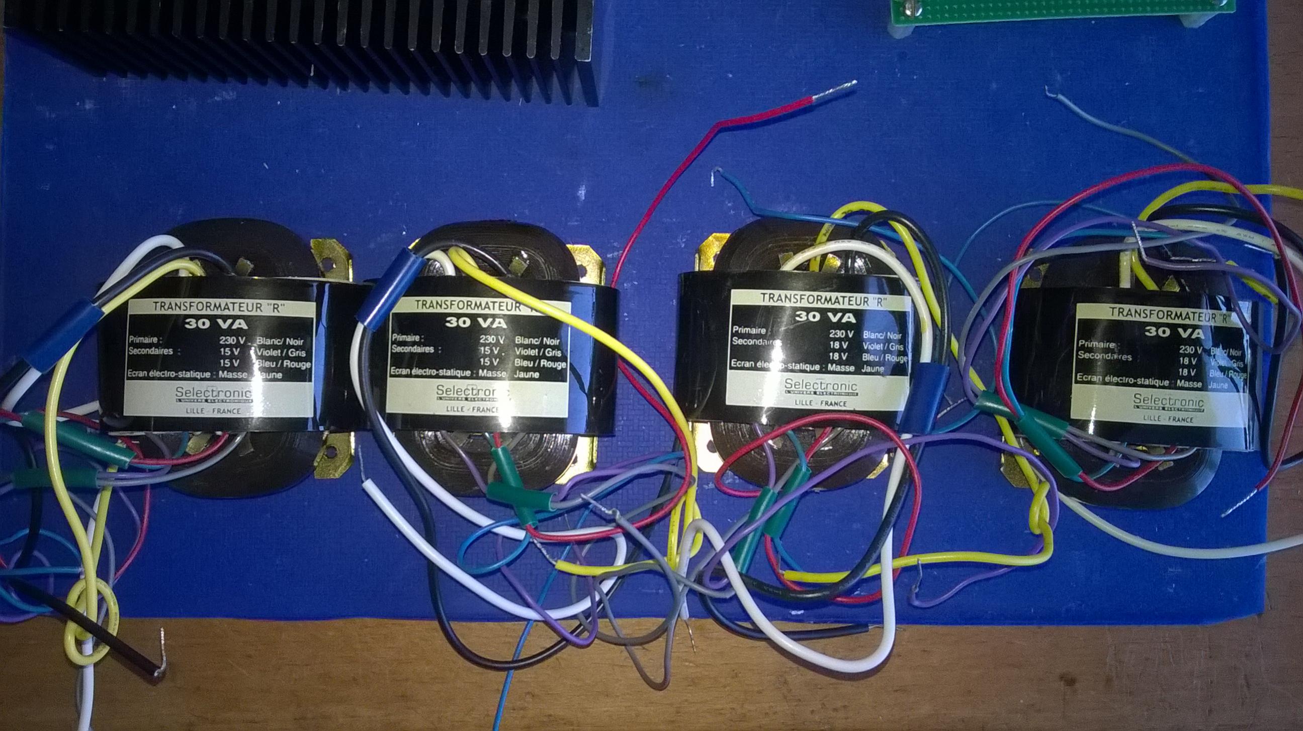

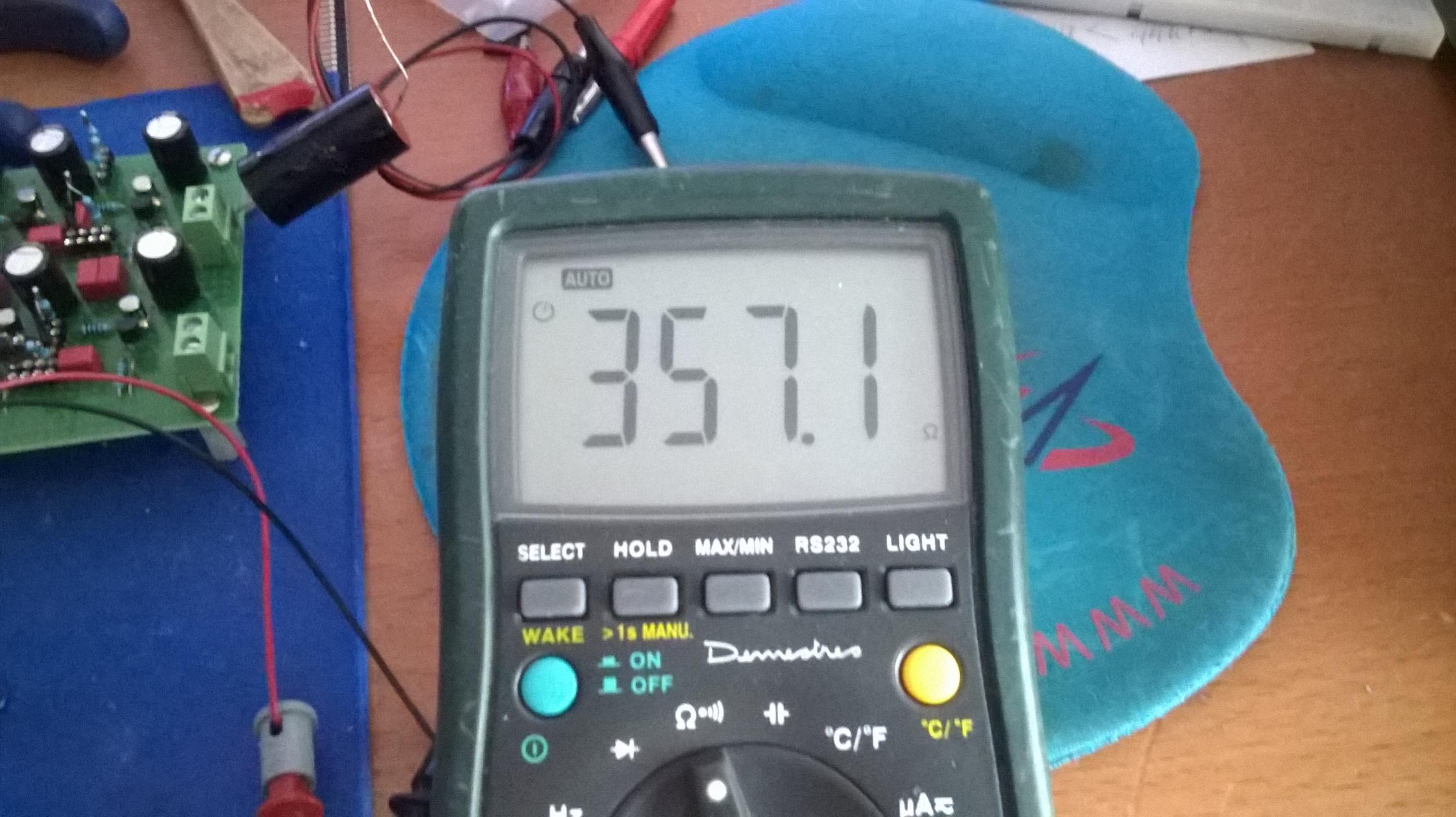

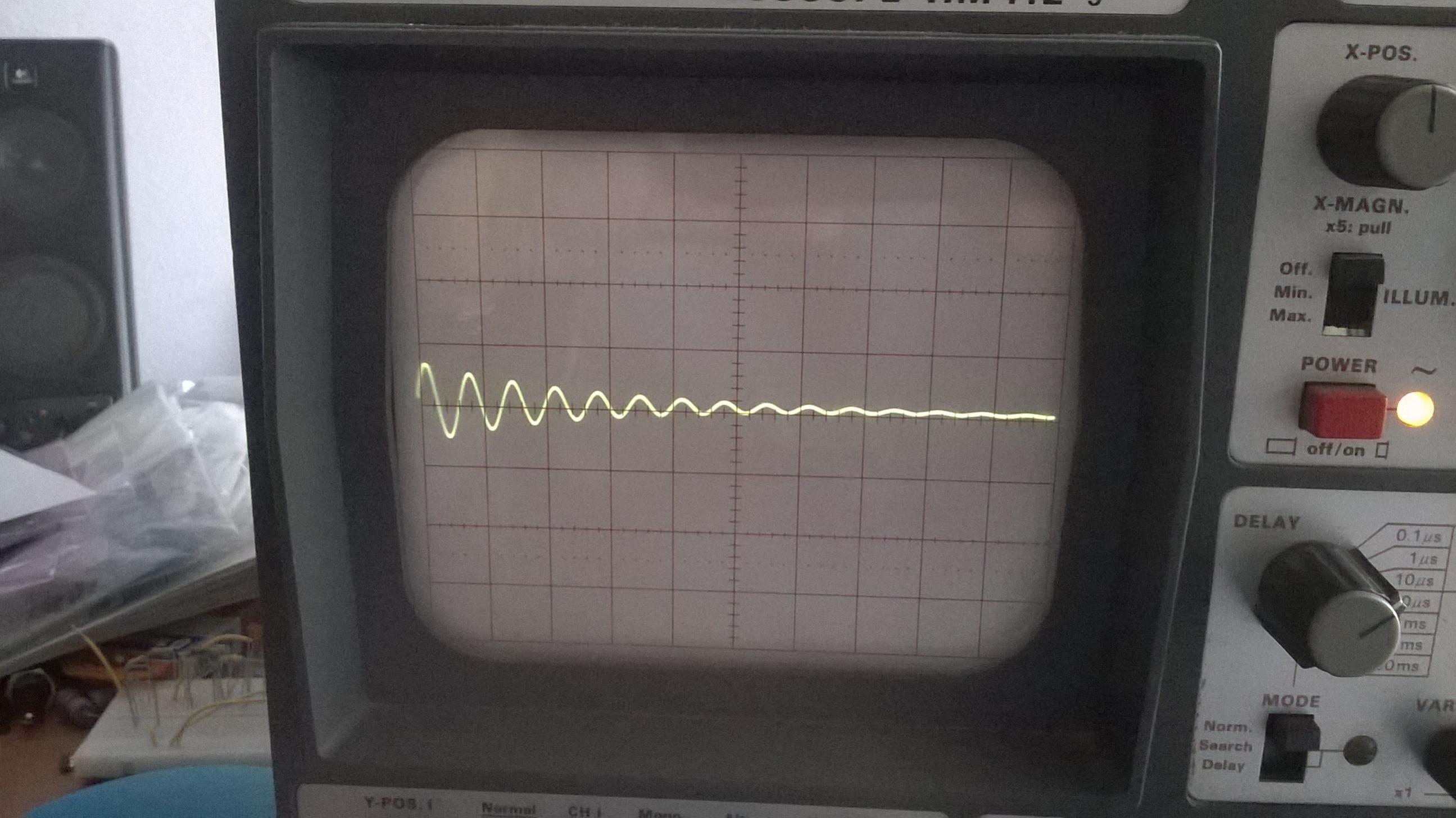

R-Core 230V 30VA two 0-15VAC secondaries wired in series to have 0-30VAC, attached pics. It's also very important to know o measure wich are the real phase at primary and secondary. As 3rd pic shows our necessary Rs is 357 ohms (use the more aproximate standard value)
Asap I will give value for R-Core 230V 30A two 0-18VAC secondaries wired in series to have 0-36VAC.

R-Core 230V 30VA two 0-15VAC secondaries wired in series to have 0-30VAC, attached pics... As 3rd pic shows our necessary Rs is 357 ohms (use the more aproximate standard value).
I am curious how much the ringing varies with different R. So if 357 is "ideal", what does it look like with 330R? 220R? 500R? At what point above or below "ideal" does the ringing become significant? (And how do we define "significant"?)
Joined 2009
I posted the target snubber pic, if you use 500R the tx will be over damped and scope will show a large tail wave, if you use 220R you possibly see in the scope more than one wave or at least the second inversed wave. Attached Mark Johnson PDF, link diyA thread http://www.diyaudio.com/forums/power-supplies/243100-simple-no-math-transformer-snubber-using-quasimodo-test-jig.html
