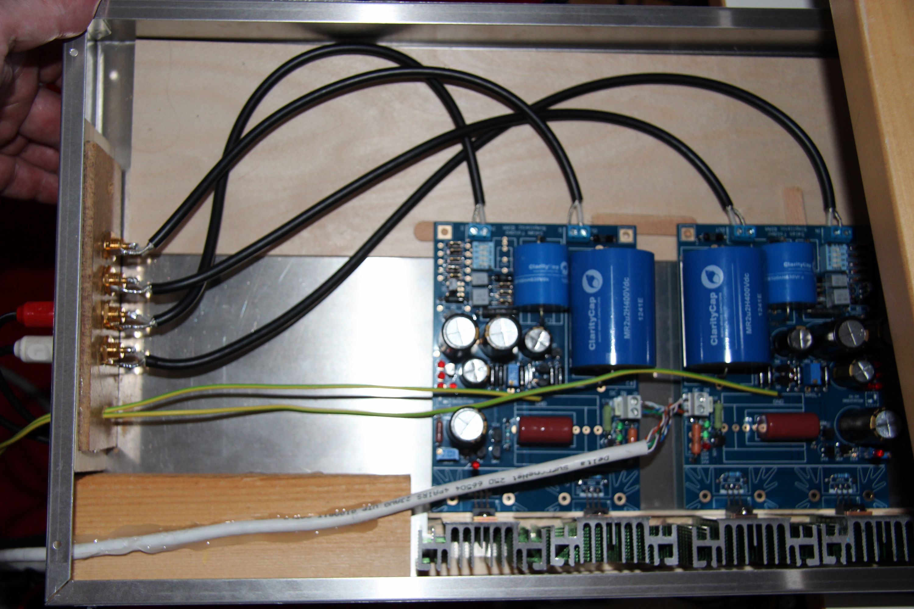

Ah well I didnt wanna wait so I did some quick and dirtys so I can listen to it when I build the rest.
Putting them in boxes needed some 50 mV adjustment again on VR2. Even without full enclosure (no lid) there is hardly any hum to mention. I can hear some 100 Hz in right with ear in cone. Left is dead hum free.
Gain is about one quarter of pot setting less then my Focusrite Scarlett. Bass is impressing from start. Overall sound is nice, after first record.

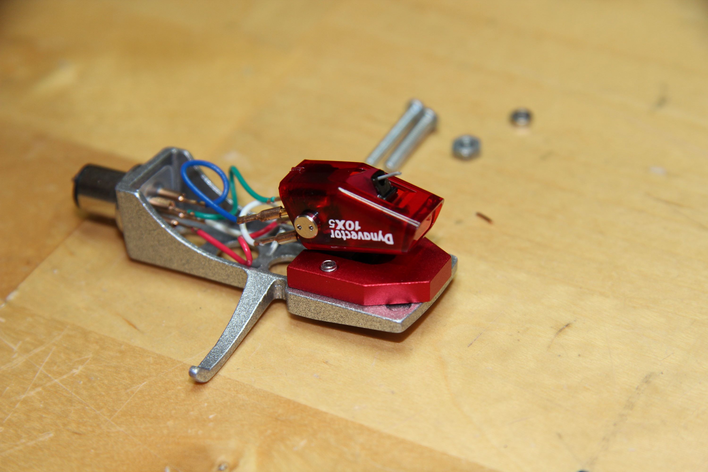

I set the load switch to 6K51 from start. I guess I need to read up on needle pressure etc now to tune it in.
I found only one screw to fasten the puppy with. The ones that were was to long. And I couldnt find my record brush
Whatever. Cool start

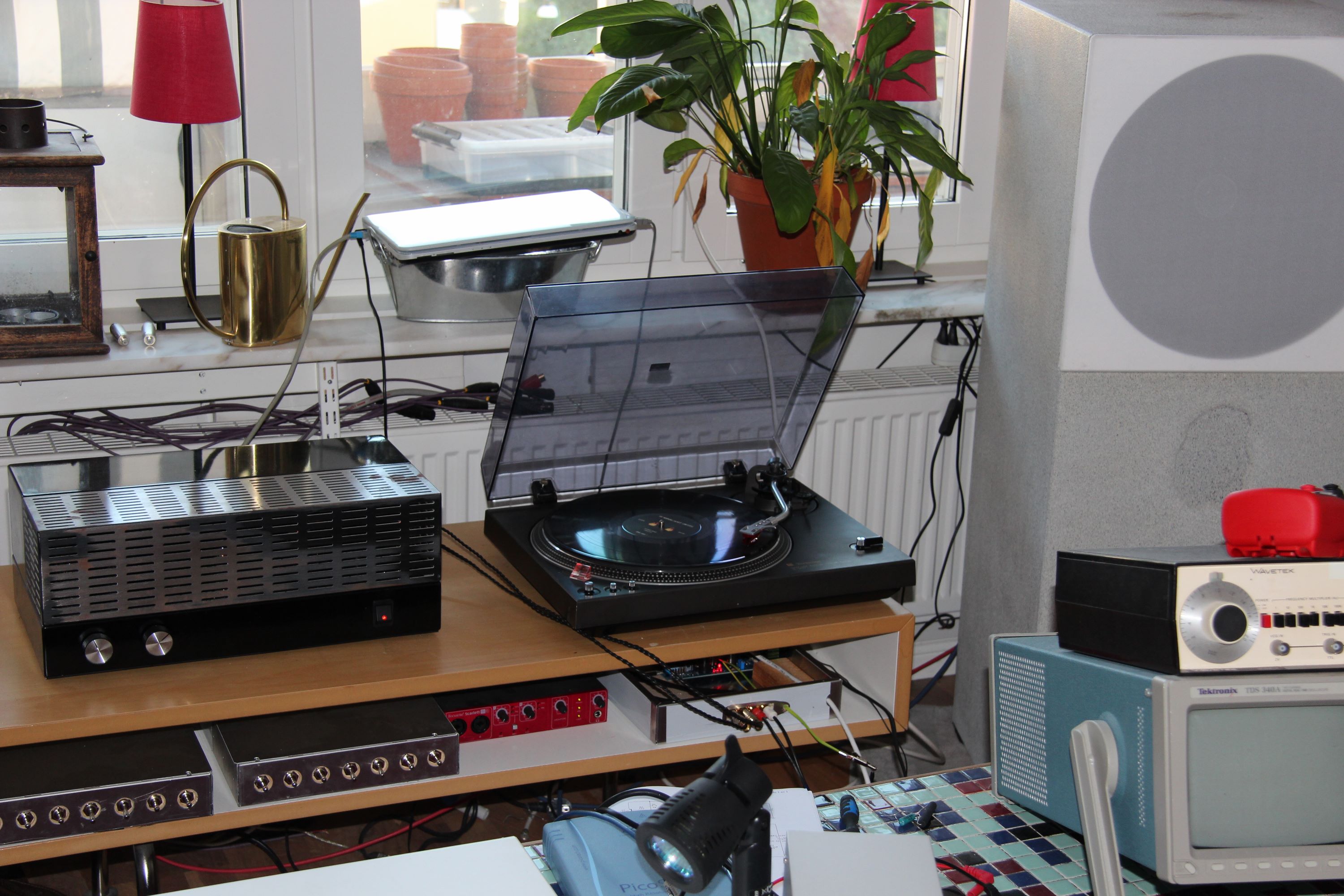

Sorry for the bad pic, holding cam with one hand.
The suspension was depressed and output went down. Watch the cart, take it easy with TT set-up. After all is well checked try about 3K load switch point too.Worked even better when I didnt use max needle pressure. Cart chassie was touching the vinyl
Oh. Scary resolution. Feels like gain is coming to. Maybe cappys needs some softeninng. Turning knob down every minute
Yes no wonder. I had it apart for some greasing some time ago, prolly I just left the arm for max stability.
Cant see the stylus weight on my cell but I sure need one thanks.
Impressive with that little disturbances in open chassie. Theres a bad over dimensioned trafo some 40 cm away and it stands right under the deck trafo.
Maybe the cart itself or the TT wires pick a bit of fields too. Later when all is dressed and put properly its possible even little hum traces will nearly vanish.
I'm planning to laminate top and bottom with grounded alu/steel/alu with insulation inbetween. Id be surprised if anything gets in. Final placement is further away from trannys. Sure looks promising

Well it seems like its the candycables with stupid RCAs. Possibly in the end cause I can wiggle it and get resistance 148 ohms and zero ohms. Didnt I just say that I hate RCA? And now I have to solder new ones
