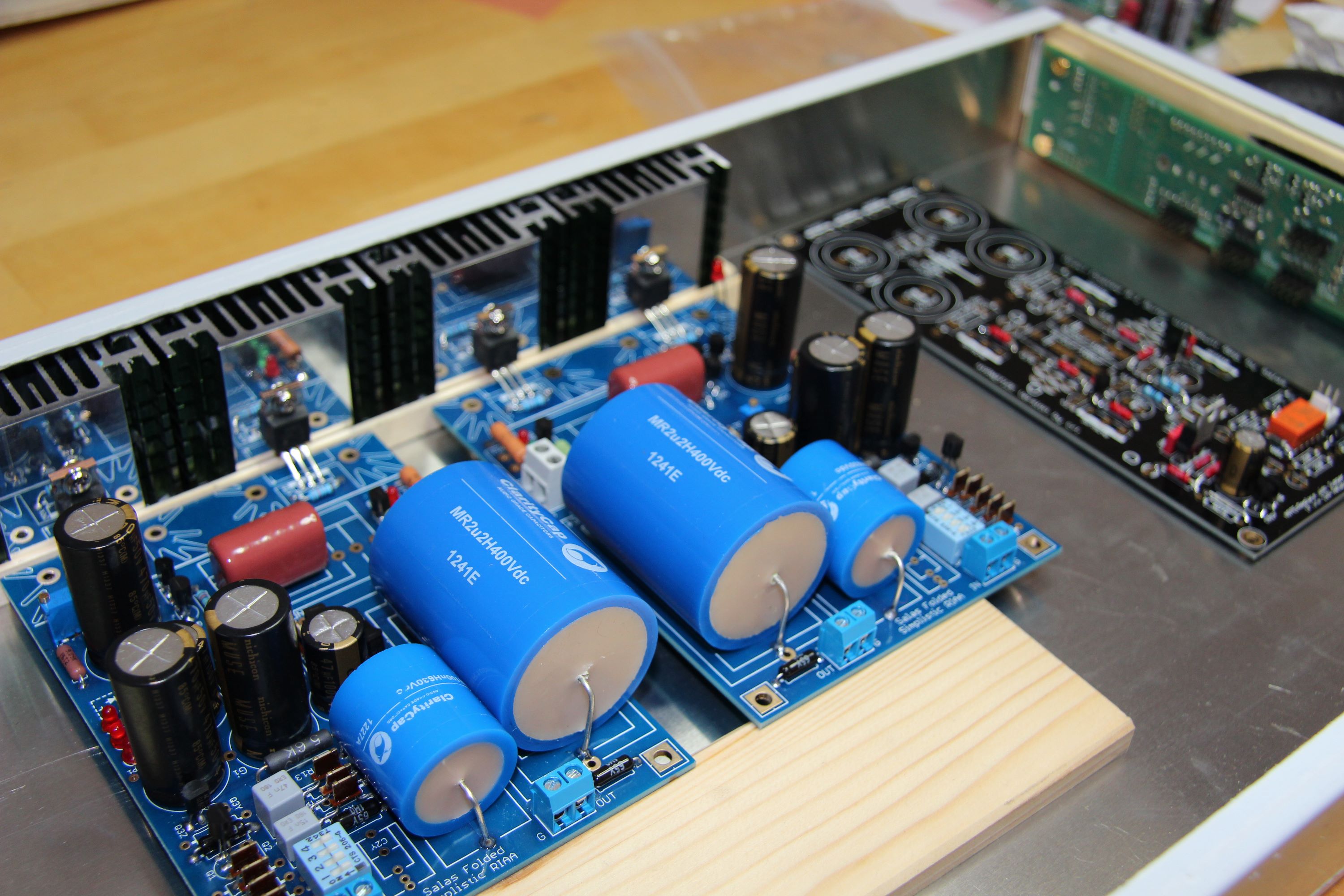

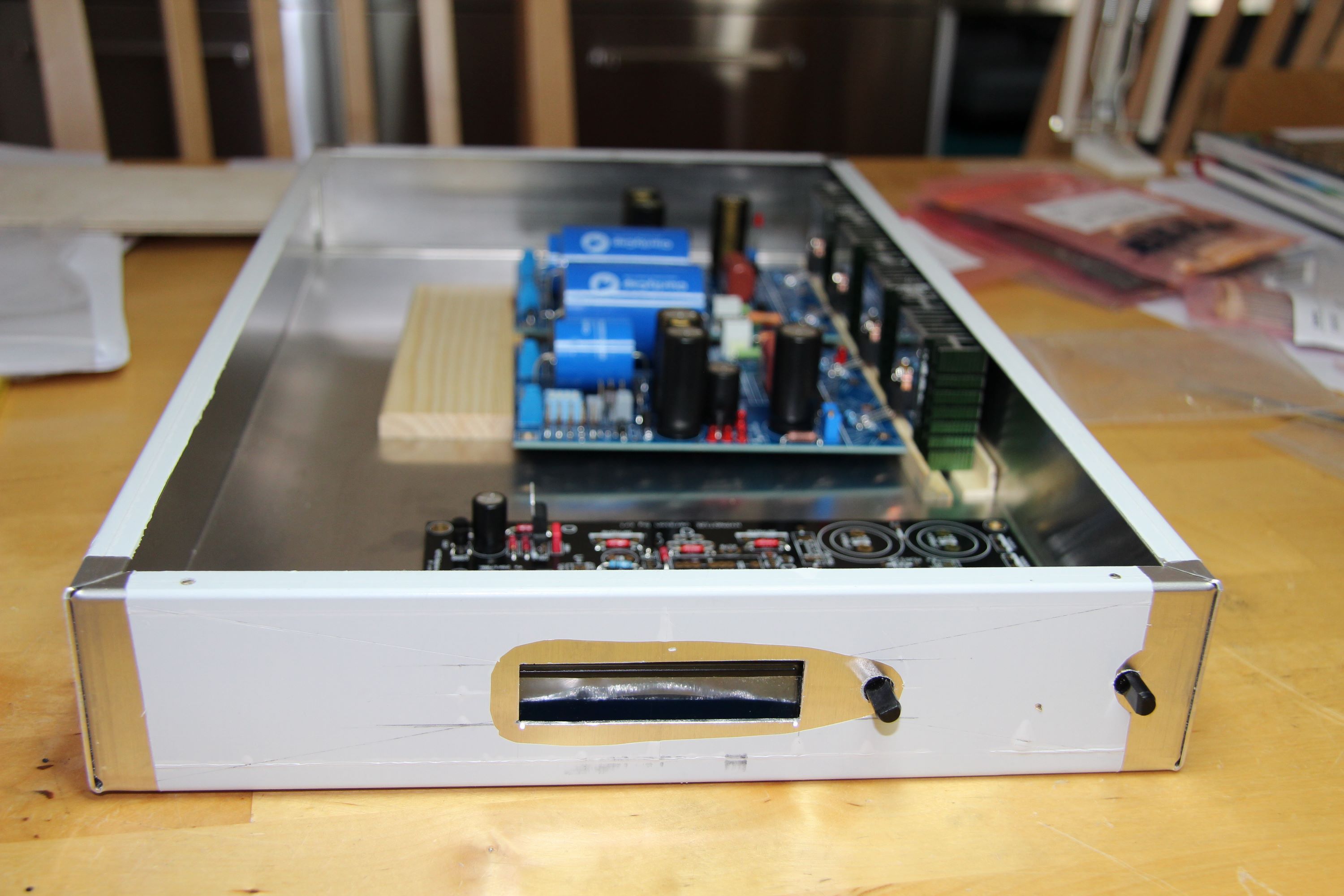

Boxing taking shape. Oii, I found this bunch of Epcos 25 V 10 mF 0.035 Ω ESR but they were to biggy 30 mm dia. Had been perf on the DCB1
I also now know that I can cut a fin or two on the Q1x:es. The were hardly lukewarm and I can get the boards closer.

It looks to be coming along nicely.
Yea thanx. Light blue is not my colour any day of the week but they sure soak the space. Had the worst workday so I feel like emptying a sixpack or 3 but maybe I plug it in for some disco later, we'll see

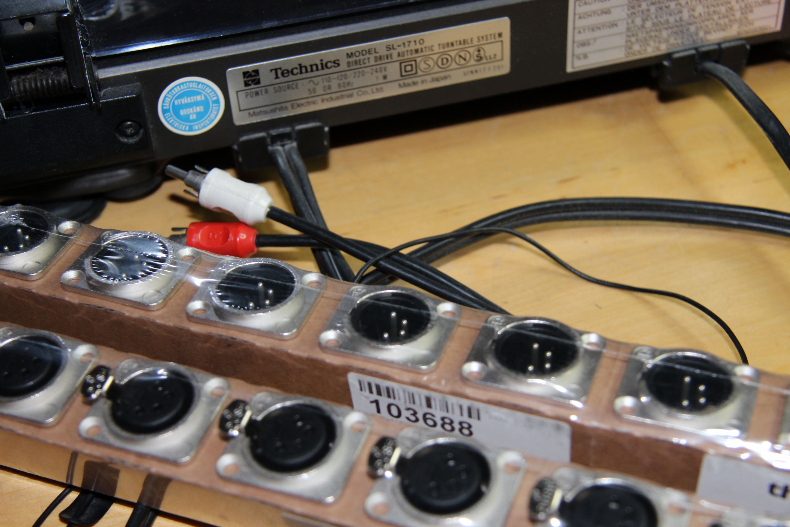

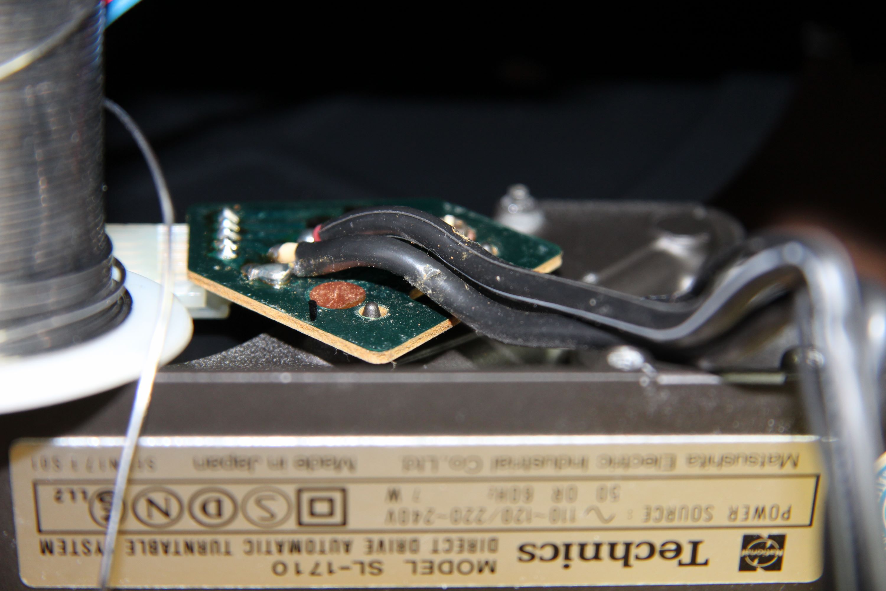

Should I just cut those candy cable RCAs?
I have some Belden 75 ohm 56 pF/m. Would that do? http://www.belden.com/techdatas/metric/89259.pdf
I know a lot of people with SL1210 turntables change the cables, considering them not up to the standard of the rest of the wonderful deck. I used to love my SL1200. The arm is good too. I'm on a DIY Lenco these days though, with a terminator style linear tracker I've nearly finished.
This stuff is cheap and <97 pF/m, made from ultra pure long crystal oxygen free copper by the world leading professional cable manufacturer. It's all the good stuff without the snake oil.
