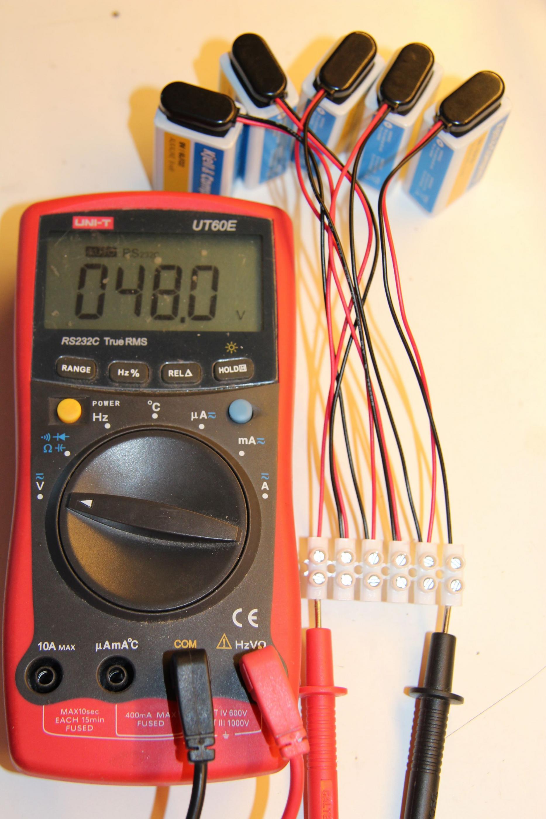

For picking the LEDs, first select your Q7, then rig it up as a ccs in series with 2 x 9v battery and the triplet in sockets like you showed. Then you can measure the Vf drop of the LED string in very similar conditions to the actual circuit.
On Q7 I guess you meen quartet of LEDs and 18 volt. On Q2x there is a triplet and I guess that I there can either use the dummyloaded original raw psu or serial 5 9V batterys?
I did indeed mean "quartet"; I was going to correct myself but was sure you would know what I meant.
The question of the appropriate voltage to use to test Q2x is a good one. I used my 2x9V because that was what I had at that point. Luckily the Idss of the FET doesn't change much with Vds.

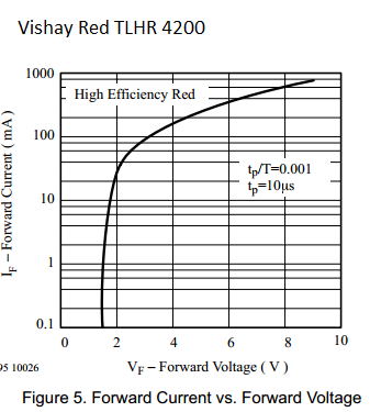

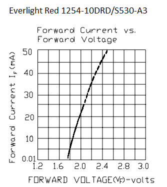

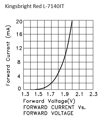

Here is Vf/current on 3 common 3mm red leds.
Interesting set of curves. The Kingsbright is much more "horizontal" at the low end, showing more change in Vf for small changes in If. The Vishay is almost vertical through the range we are interested in, almost no change in voltage. I assume there are also temperature effects.
