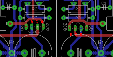

Its too much in this case. Needs be ~0.6V. Please check they are installed like I attached. Vbe is easy to sample across their outer pins.
I swear they are in the correct holes. Remember I was able to get the proper bias voltage initially. My rail/ground was low and that is when I placed the resistor in series with the WRONG resistor and created this BIG problem in an attempt to solve a little problem, damnit.
I did measure across the outer pins. I have those hook type measuring leads so they were firmly attached to the leads and no chance of them shorting. I attached the leads before turning on the amplifier. I let it fully warm up (20 minutes) to see if anything changed. It did start out higher - 0.76 and then settled down to 0.73.

Over 0.7V Vbe means too much current is channeled through the BJTs to R4 loads and that ties with the odd TP readings and their no response to VR2x. Having that condition points to either the 369s don't pull enough current or the 970s have a problem. You can check their current on R2 and R3 by mV across them divided by their value in Ohms. Normal is about 9mA each. Also check voltage across the 369s. Normal is about 8V. If those conditions are OK do the BC560C Q3Y instead of the 2SA970BL Q3Z thing and try the TP points goal with VR2x again. BC560C has CBE as we face it and its own D framed positions and orientations marked Q3Y on the boards.
