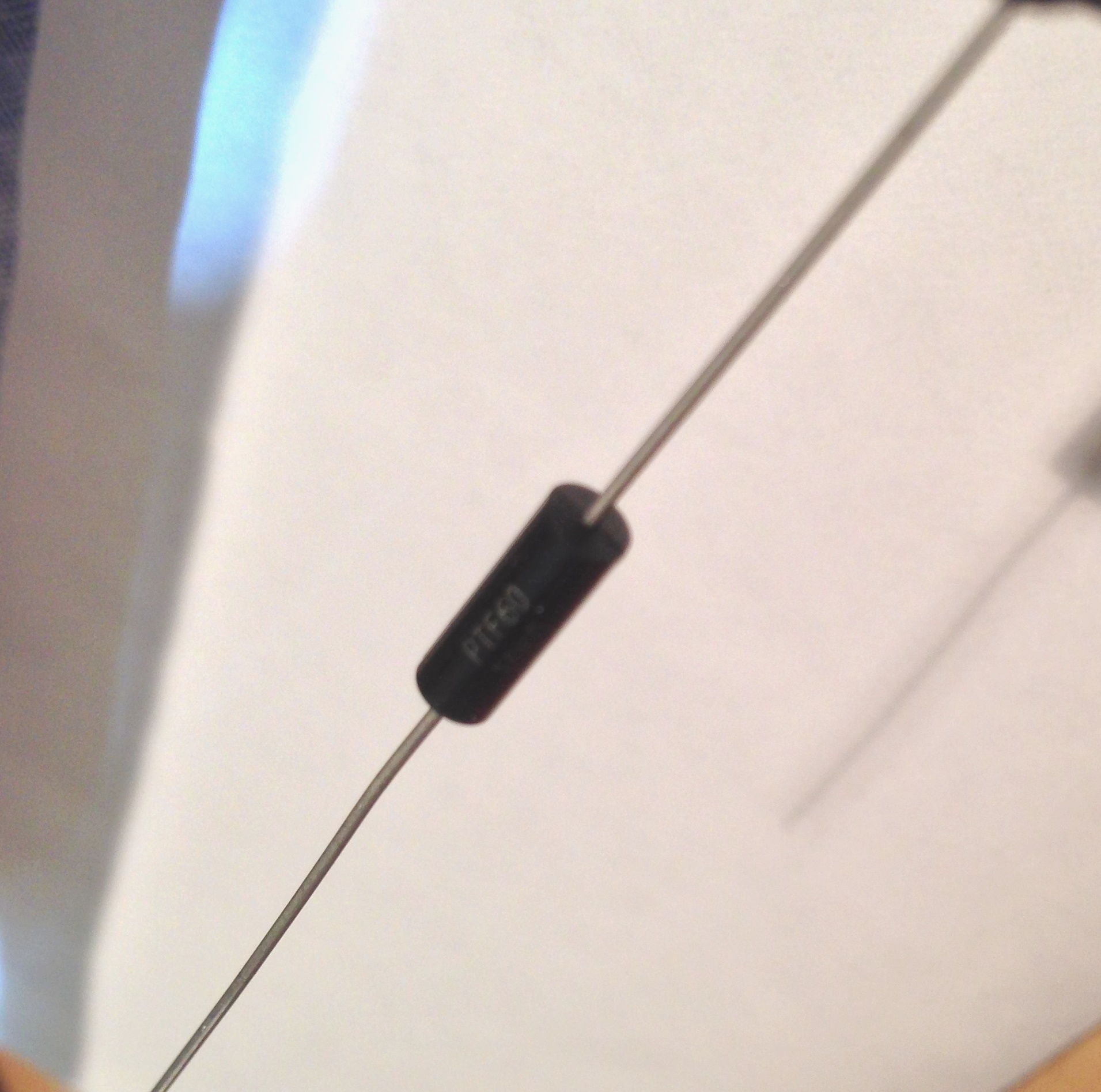

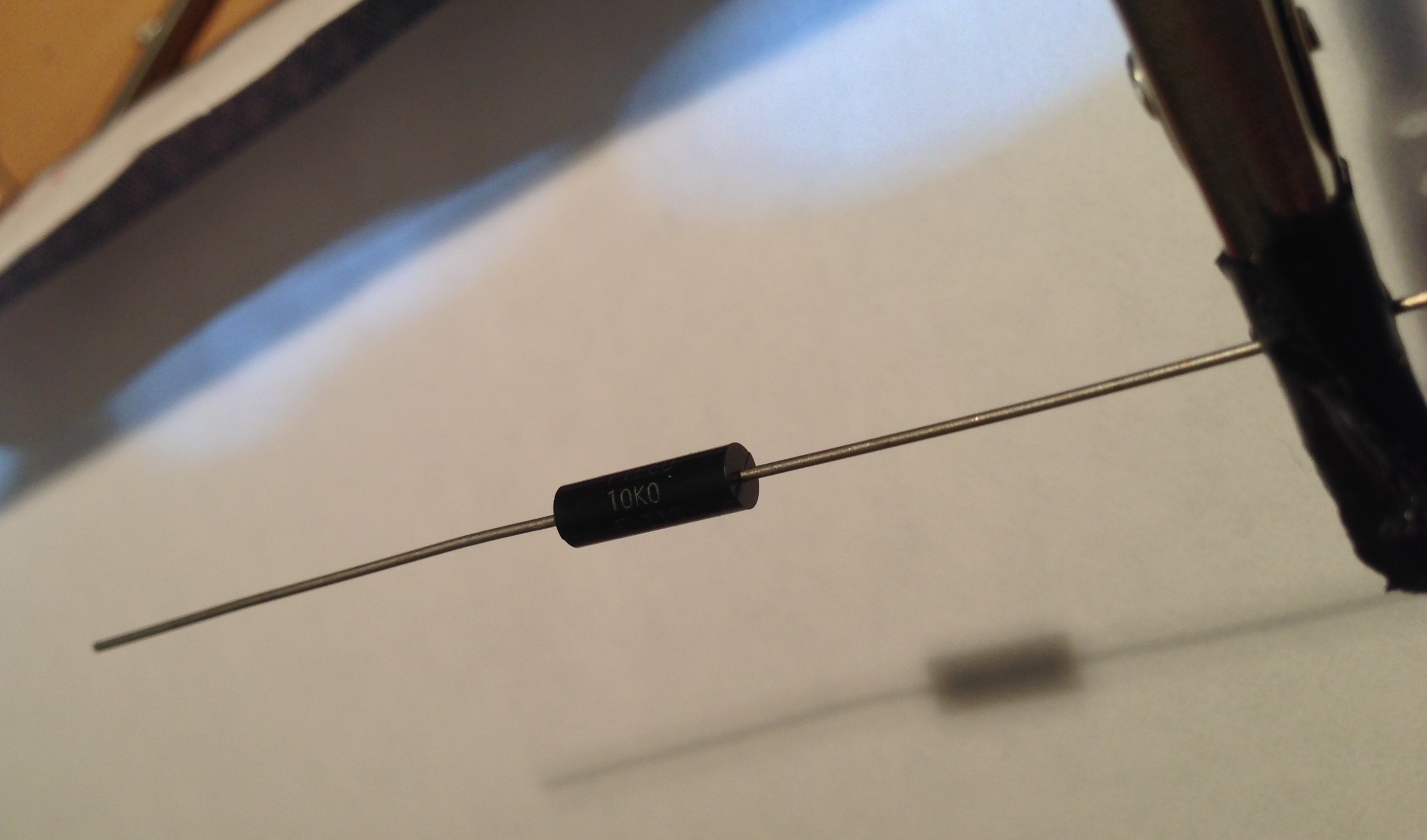

23pos Seiden w. Takman Carbon + 10k Z-foil
Damn this Riaa sounds good
Doors at 13 O´Clock volume, perfect for a sunday night
9k=

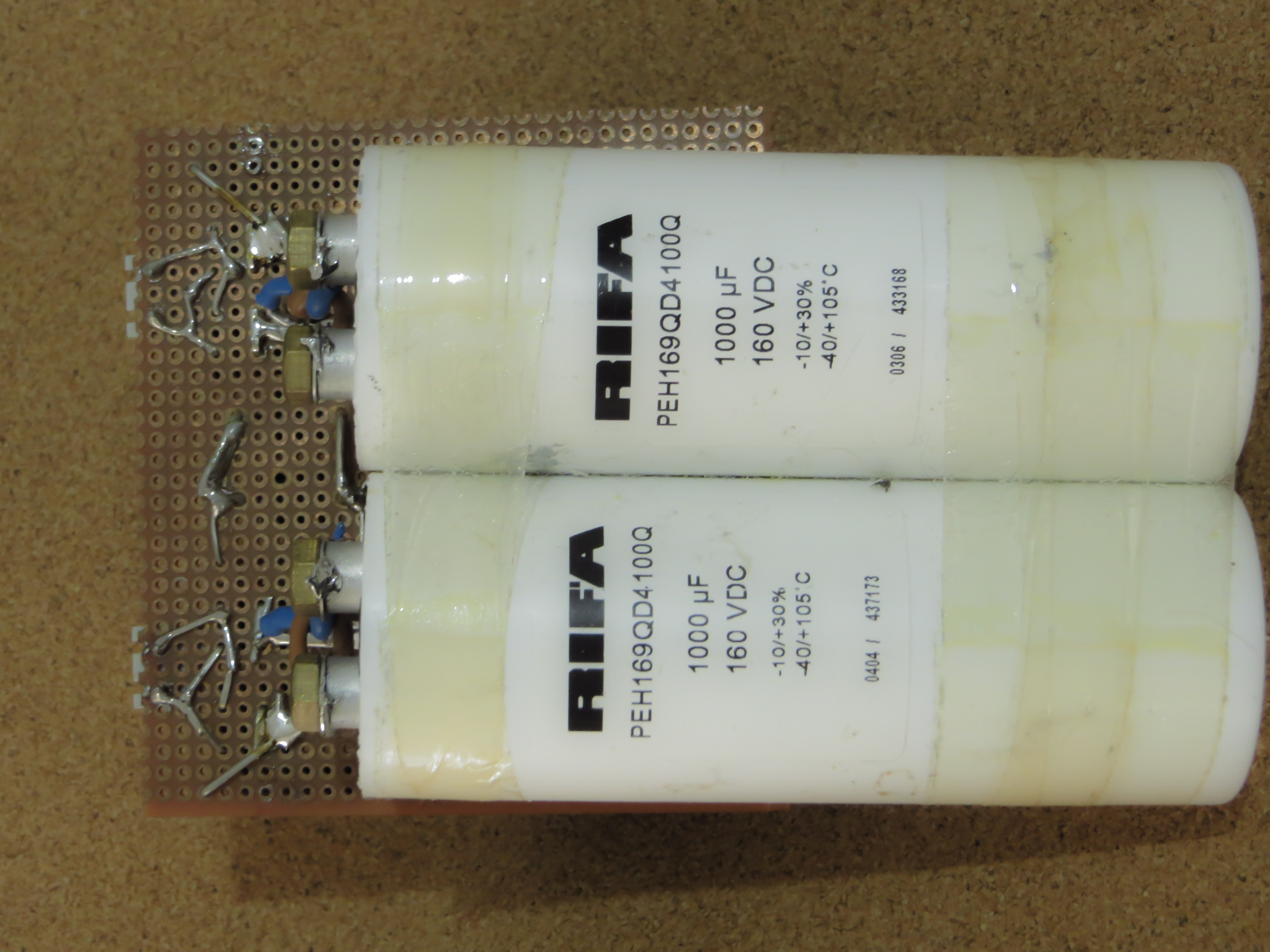

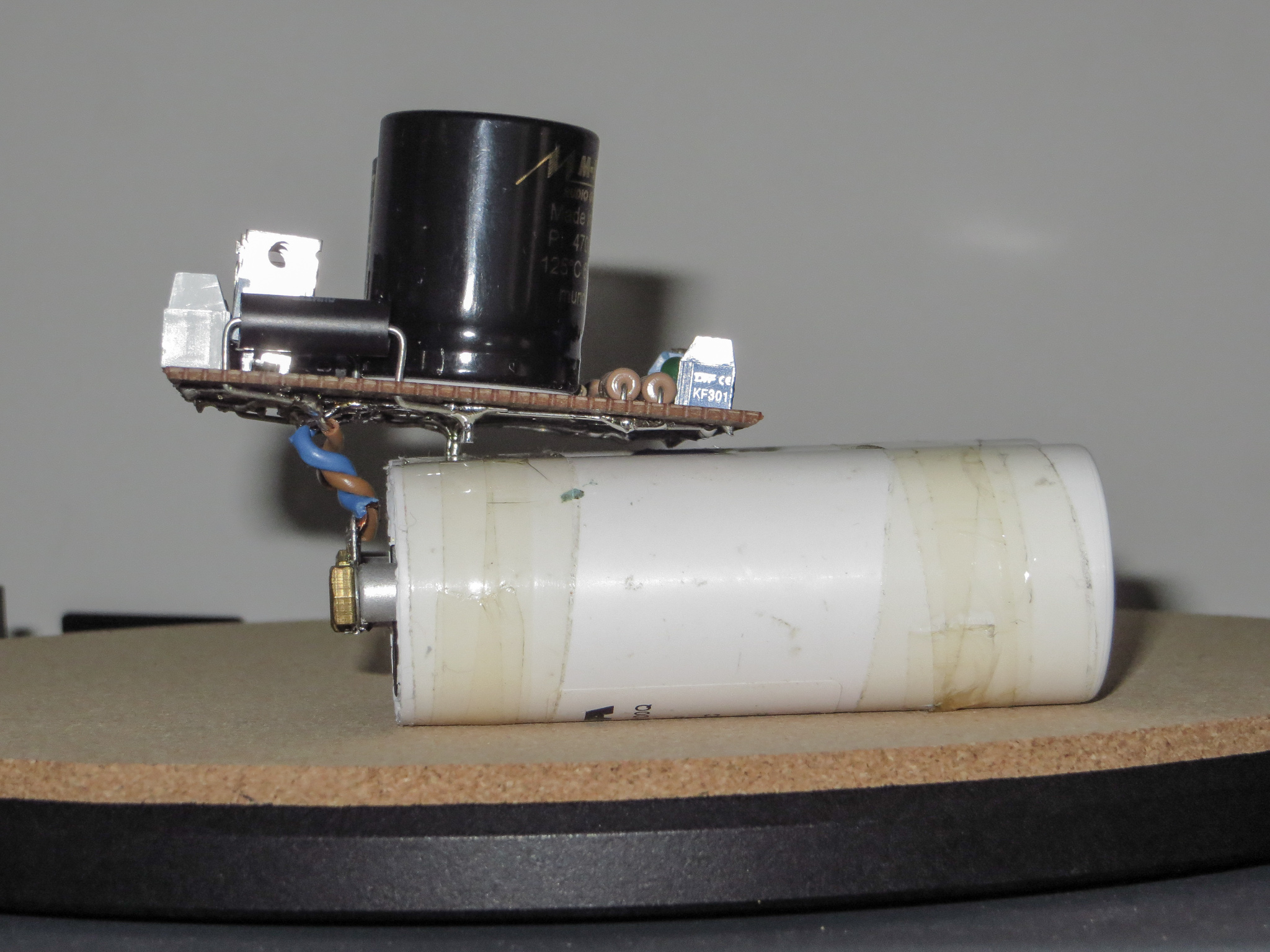

Today for sake of experimentation i thought of adding 2 1000uf Rifa PEH169 to the PSU right after the rectifier, forming a CRC filter. 1000uf-1ohm-4700uf
I may be doing more harm than good because these caps connect to the board with wires. Havent done any serious listening session yet, and the PSU looks a bit silly :)
Sweet
have you settled for 1 ohm?
roughly you would have about 100mv ripple in that setup
Going to about 15 ohms decreases the ripple to aprox. 16mv
Per
No i havent really settled to specific values, just using what i already had in hand. Salas if i increase the value of R to 15ohm , how would that affect the reg down the line?
