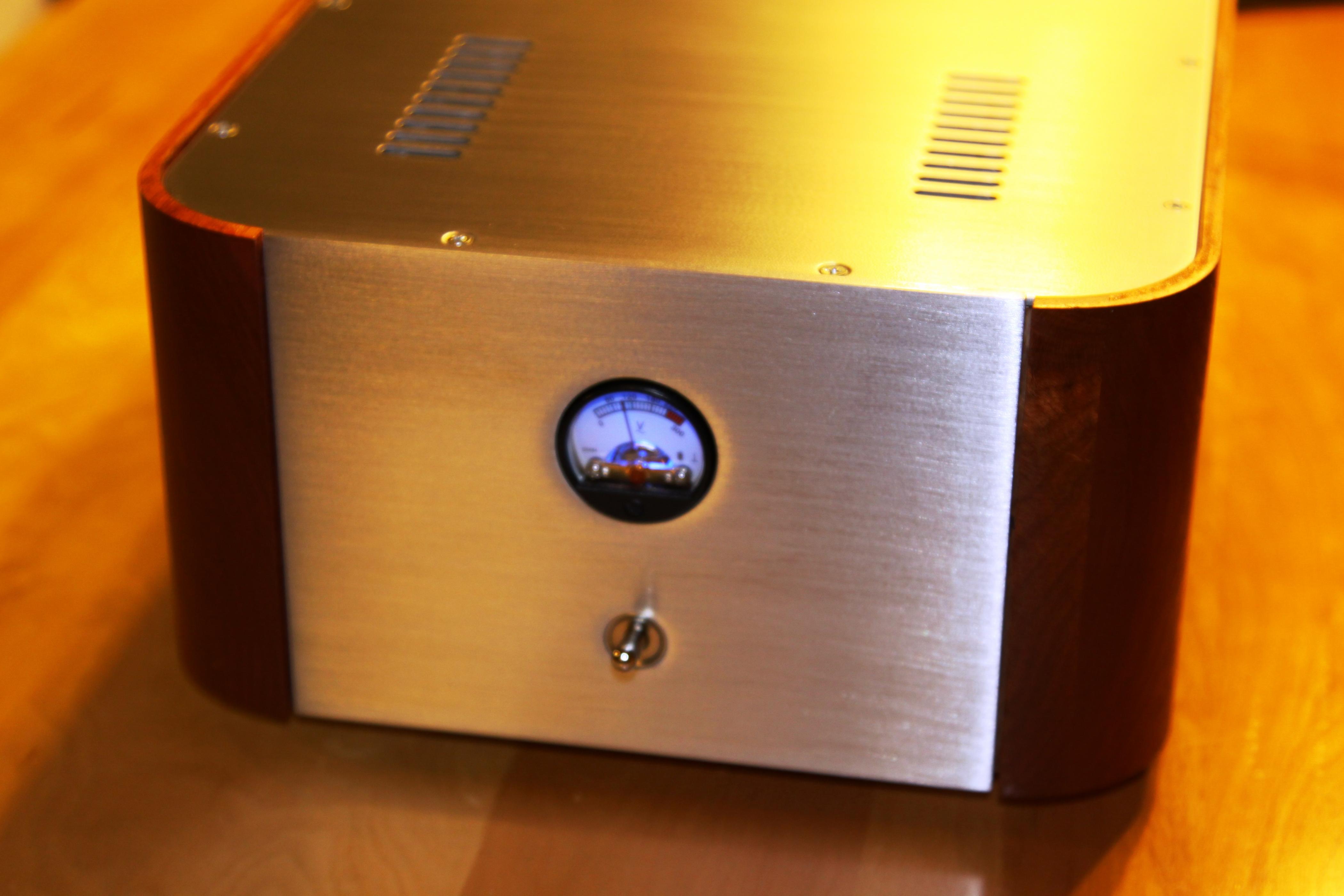

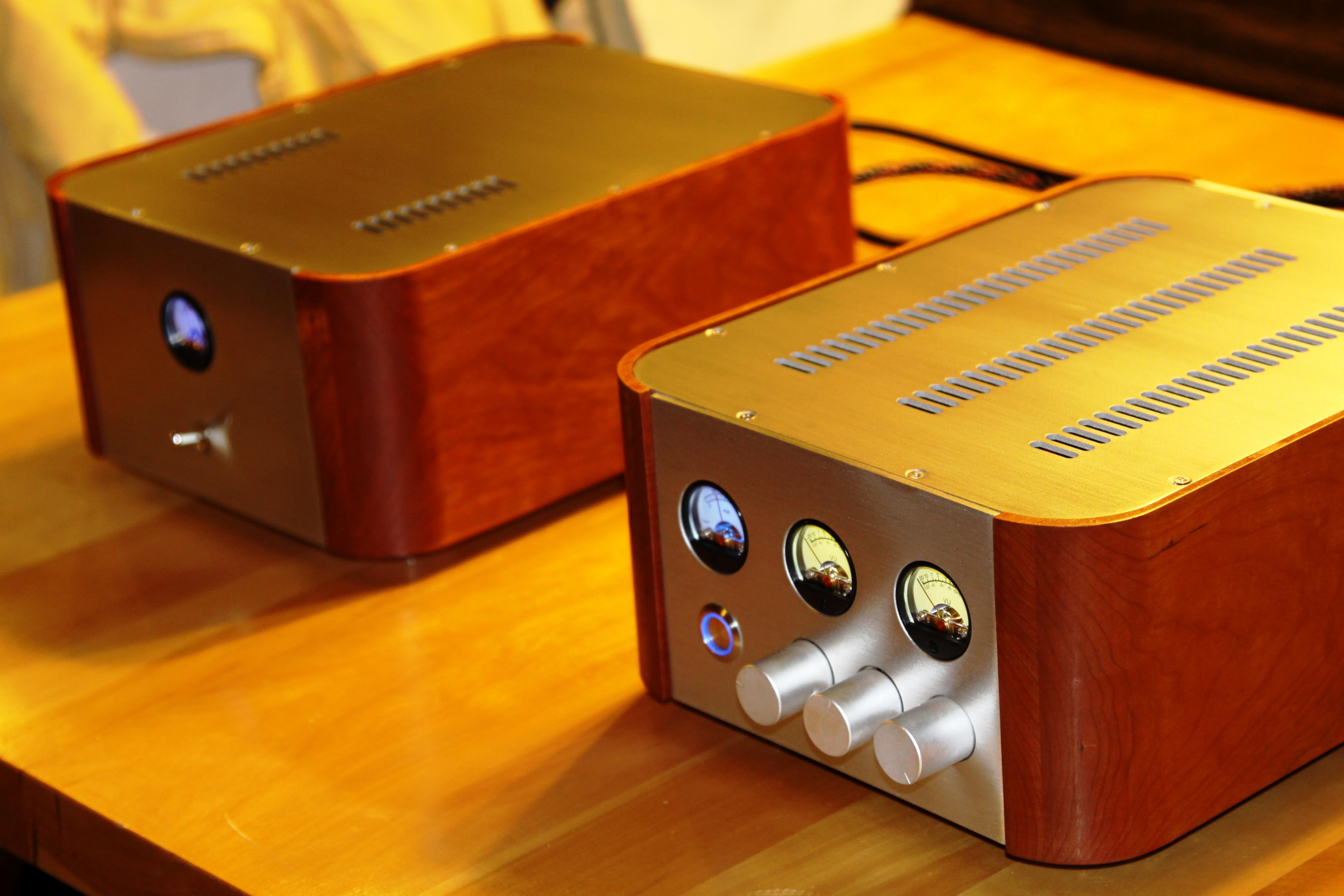

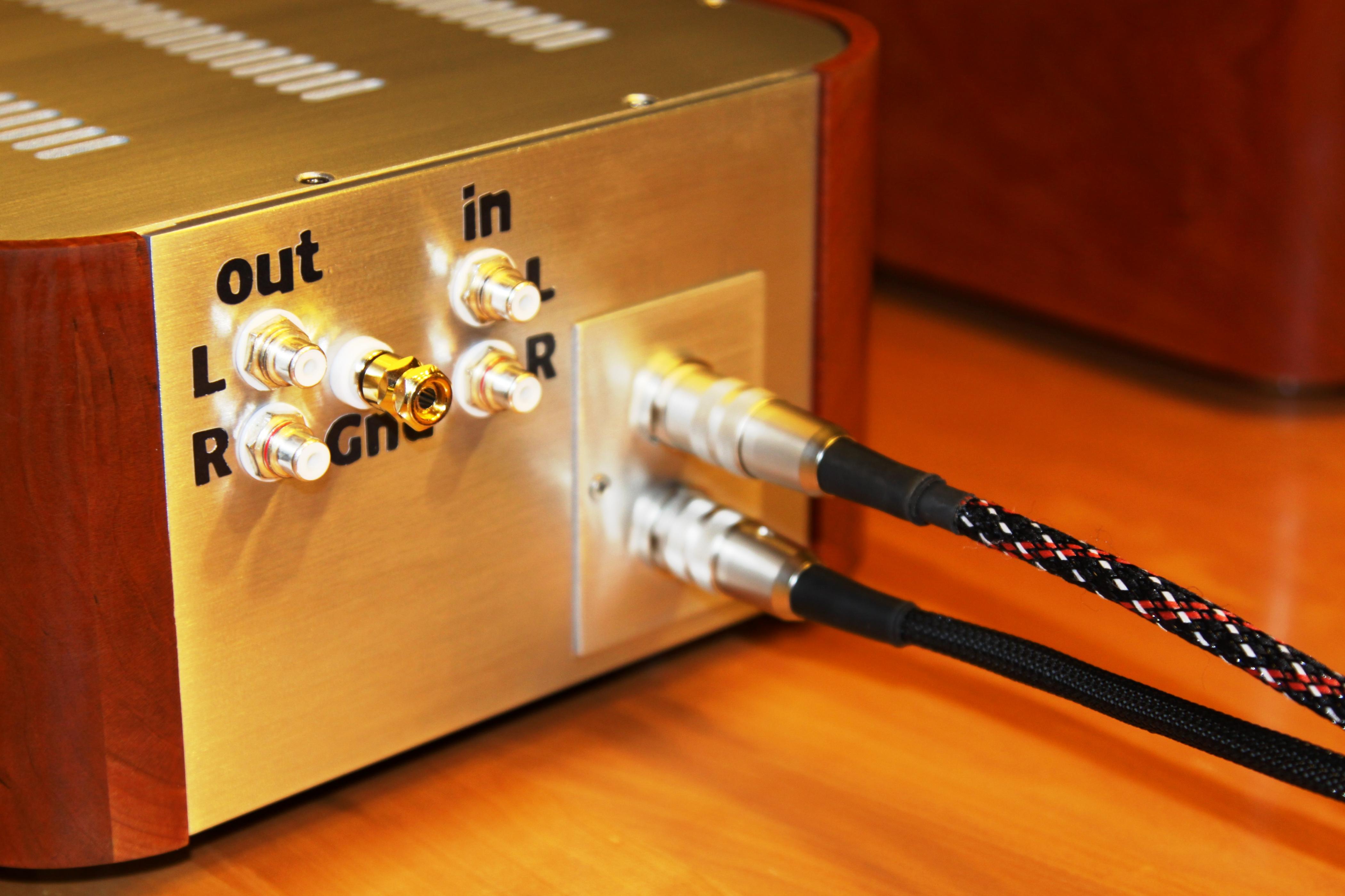

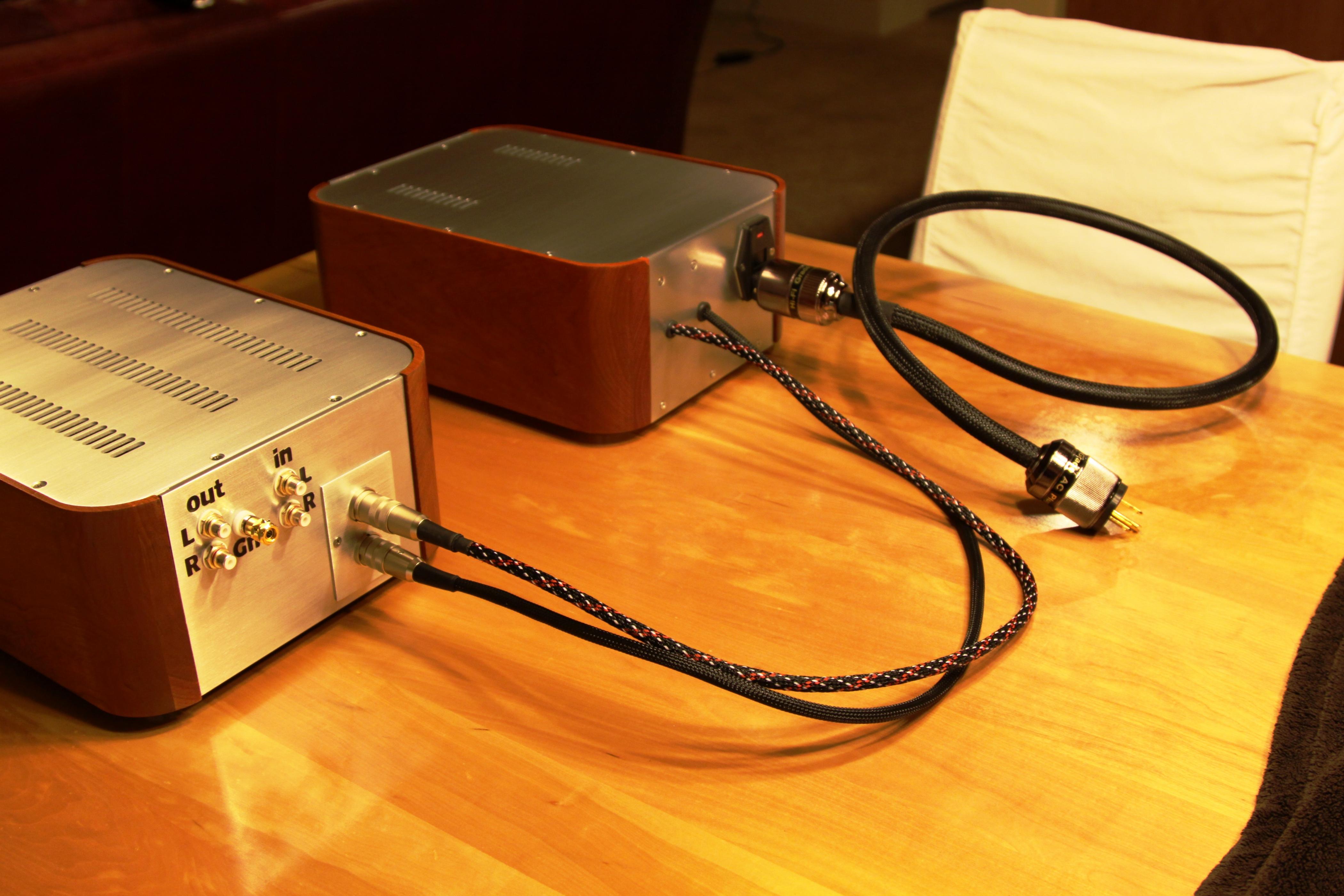

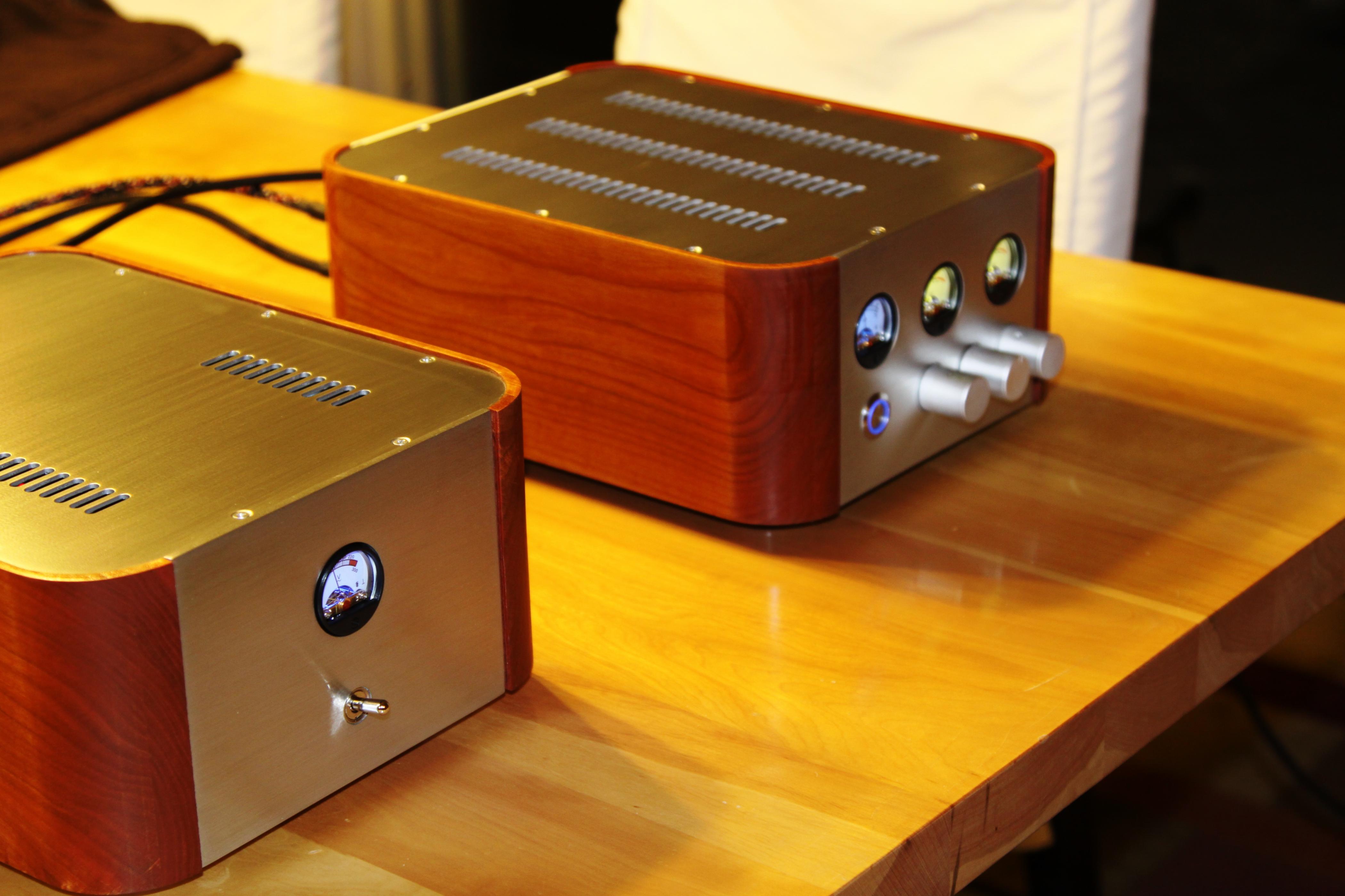

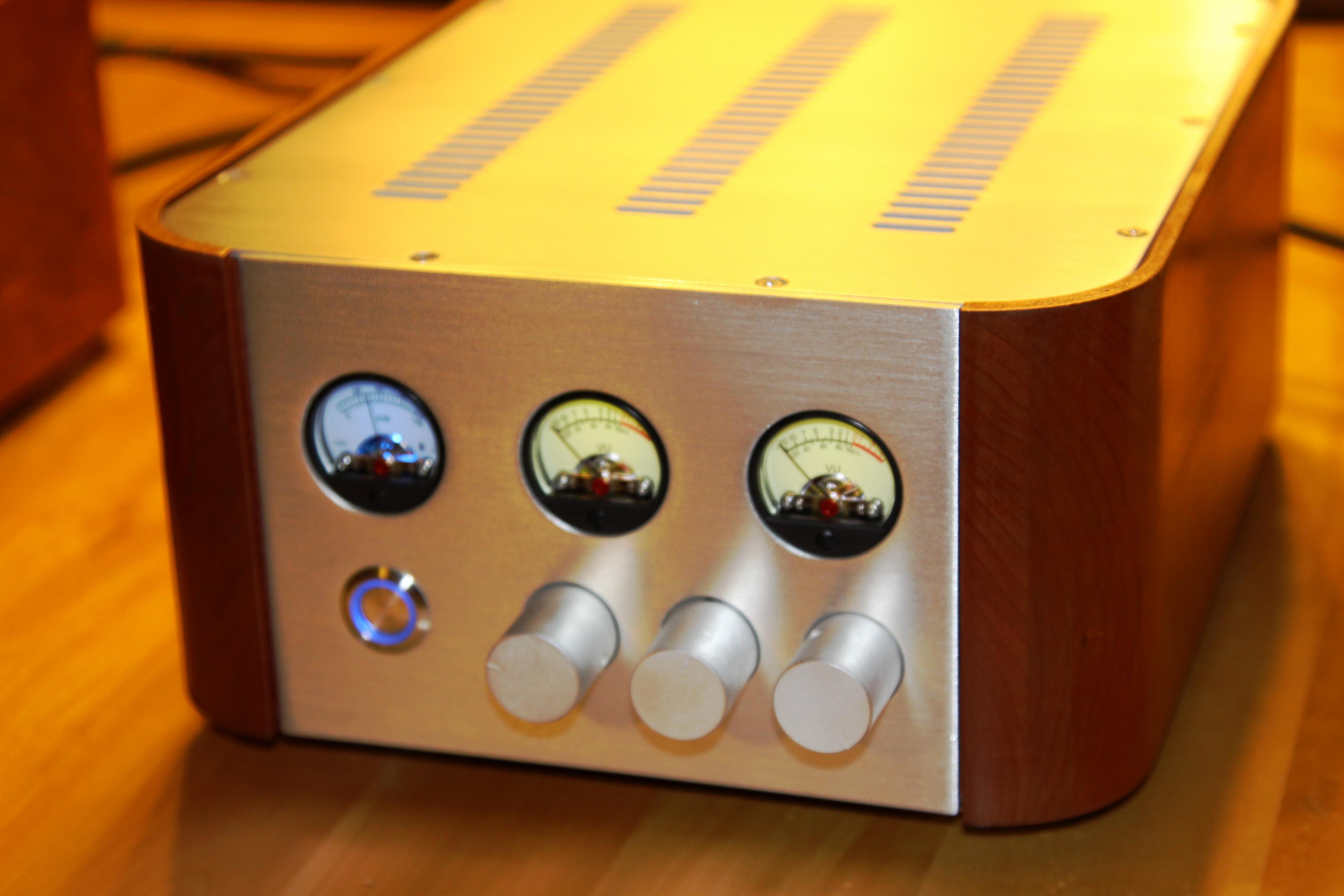

Hi Salas,
I'm done.
The best sound came from 47pF for C2Ys. I made tightly matched pair with choice of two caps with 44.3pF (Germany made KS Styroflex 160V). I also corrected umbilical cord braid connection to 0 in PSU box.
Please see attached pics.

Wow Alex!
Very, very stylish! Gems...
Regards
Thank you.

Fine aesthetics finish. Congratulations.

Awesome appearance! What do the knobs and dials do?
