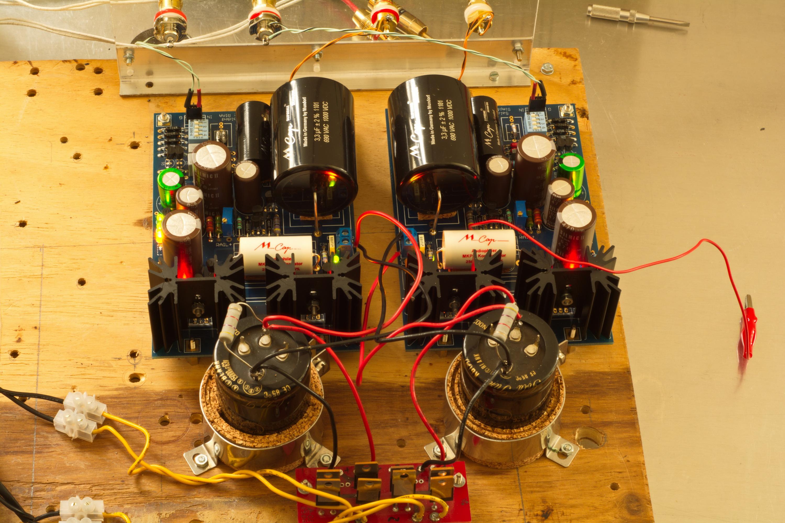

Sorry for coming late to this topic - boards only arrived last week and since last night - it's playing :)
Following the crystal clear guide building was entirely problem free. Two, slightly tweaked for output voltage 60VA Talemas, MUR860, Nichicon KG 15000 and the rest - parts out of my drawers and of course Tea Bag's great minikit. Went for the highest gain which works perfectly with a Cadenza Red. No hiss, nearly no hum with the boards screwed onto a piece of wood with no screening at all.
Soundwise - still caps to break in but it is very, very good. Big thanks to Salas and Tea Bag.
What impresses me most is the extremely low subjective distortion. Very clean transients, great resolution and microdetails. Very natural decays. I may wish for a tad fuller bass but this is really nit picking, besides coupling caps are still new.
I get about 10v at the output follower, not sure if it's worth finding a correct idss ccs for exactly half the supply voltage.
Recently got to listen to Naim's Superline and much to my surprise i quite liked it. It is obviously not too different to the simplistic if one does not pay too much attention to loop feedback, bipolar inputs and tantalum coupling caps :)
Which sets an obvious upgrade path for my version of the simplistic - remove a couple of resistors and decoupling caps and fit each channel with 3 or 4 BiBs.
