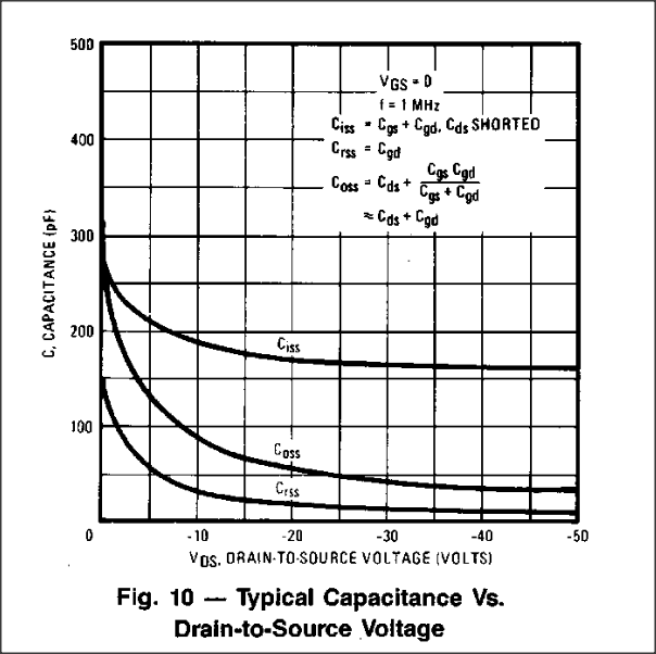

P.S. That is why I don't warn against if they have 33V B+ and high raw DC in this FSP PCB as long as they are OK with 9610 sink temperature and not higher than 50V for Q2x's safety, because 10V+ is good for the MOSFET. You see how pF evens out at VDS>15V and how it picks up at VDS<10V.
Now this is some important notice
