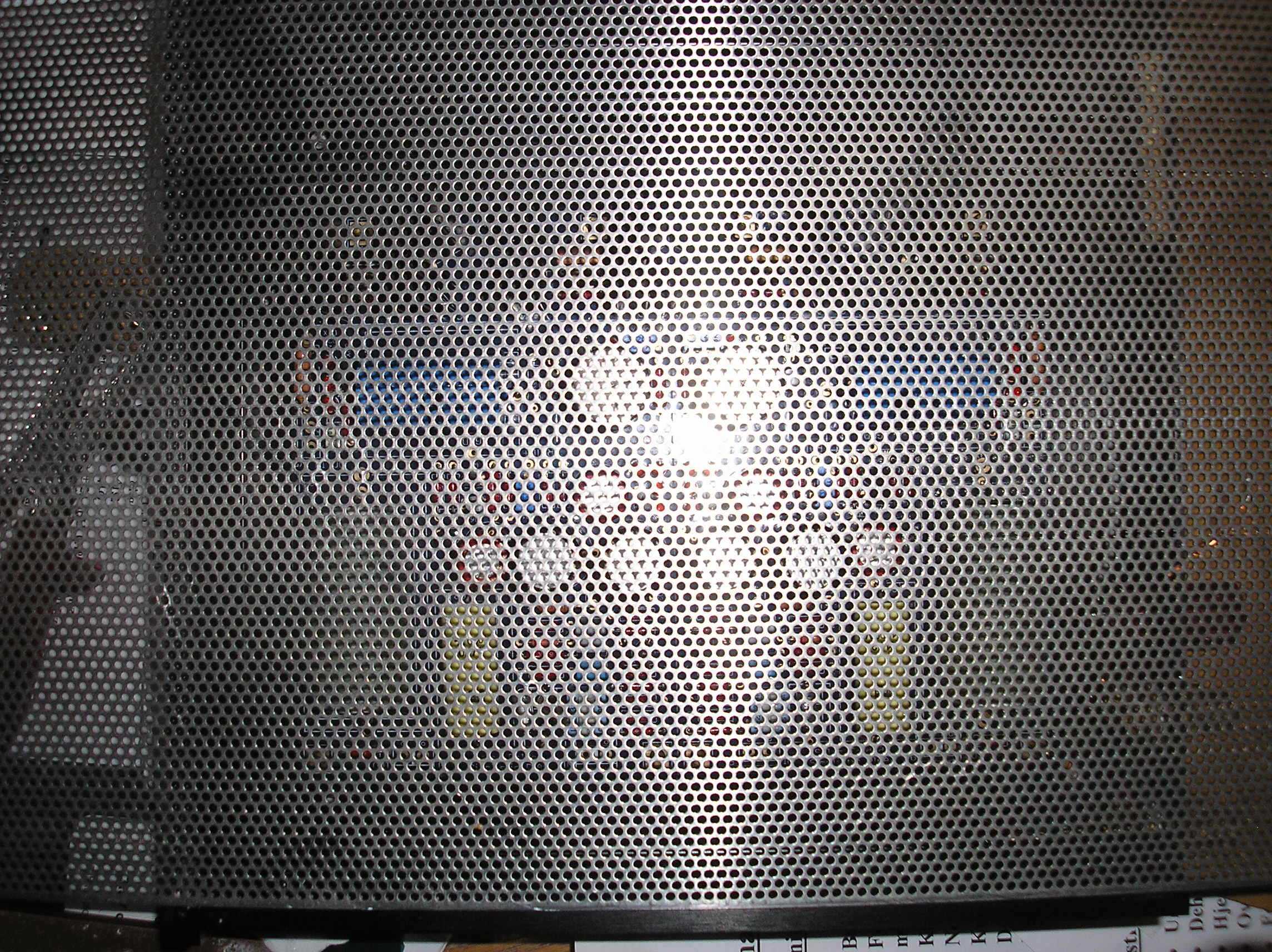

Will glow nicely through that. If there will be air con in the room better improvise something to block the input FETs from drafts or unpredictably high ambient delta. It will be cooler with the perf cover but also exposed. Use the mini sinks if you got them or make a mini matchbox to enclose them.
"Another useful tip is before pushing the optional mini sinks on the input JFET(s) prepare them collars a bit wider with the pliers and form fit them on another same case transistor or Jfet first. Else the pressure will be too much for already soldered Q1 Q2. "
Jupp, I had a hassle getting them on top of the JFET's. God luck that I assebmled them before soldering which included widening. I had to get the legs in place after the procedure...

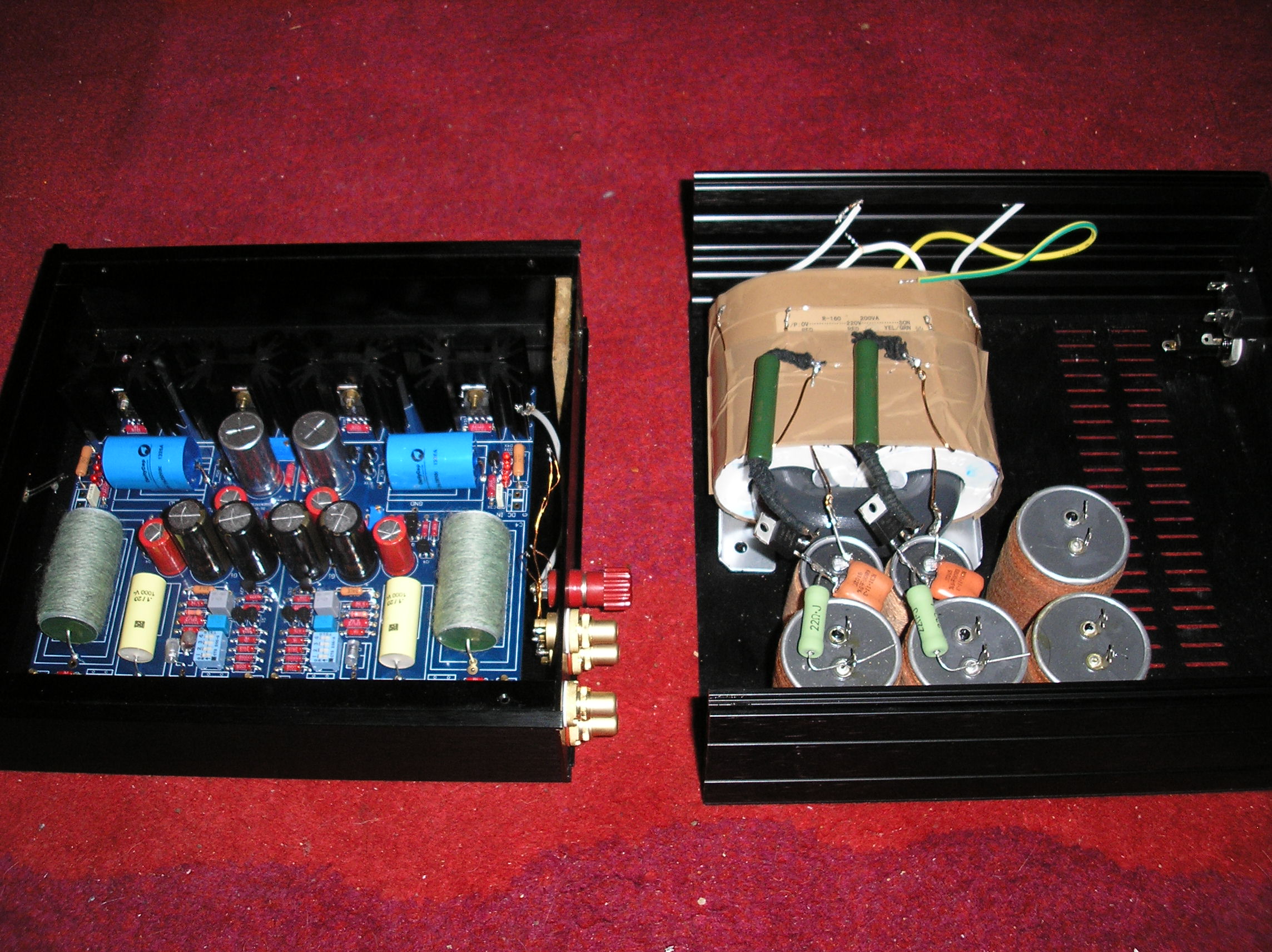

Can you please share with your Raw PSU schematic and parts brands.
I see you deviated from Salas original setup.
Also, I see that one of your channels (left channel in picture) has 2 C2Y caps and other (right in picture) has only one. Is that related to certain channel matching?
Thank you.
