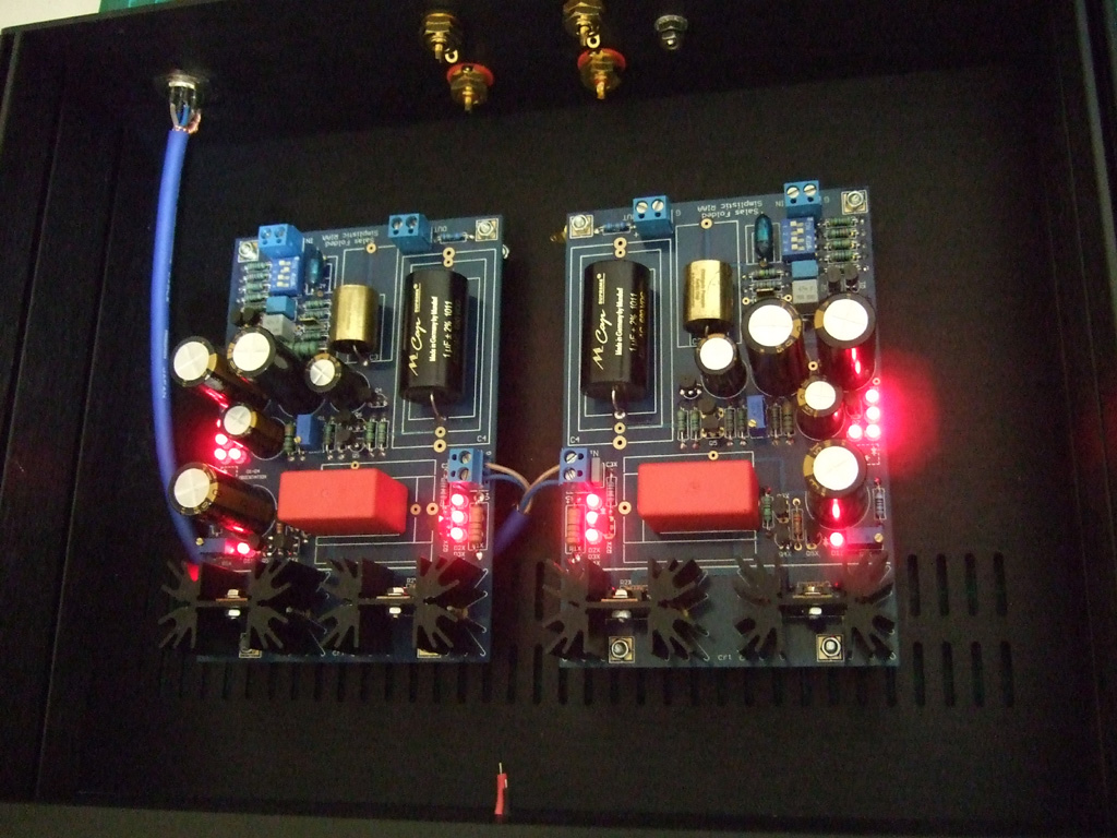

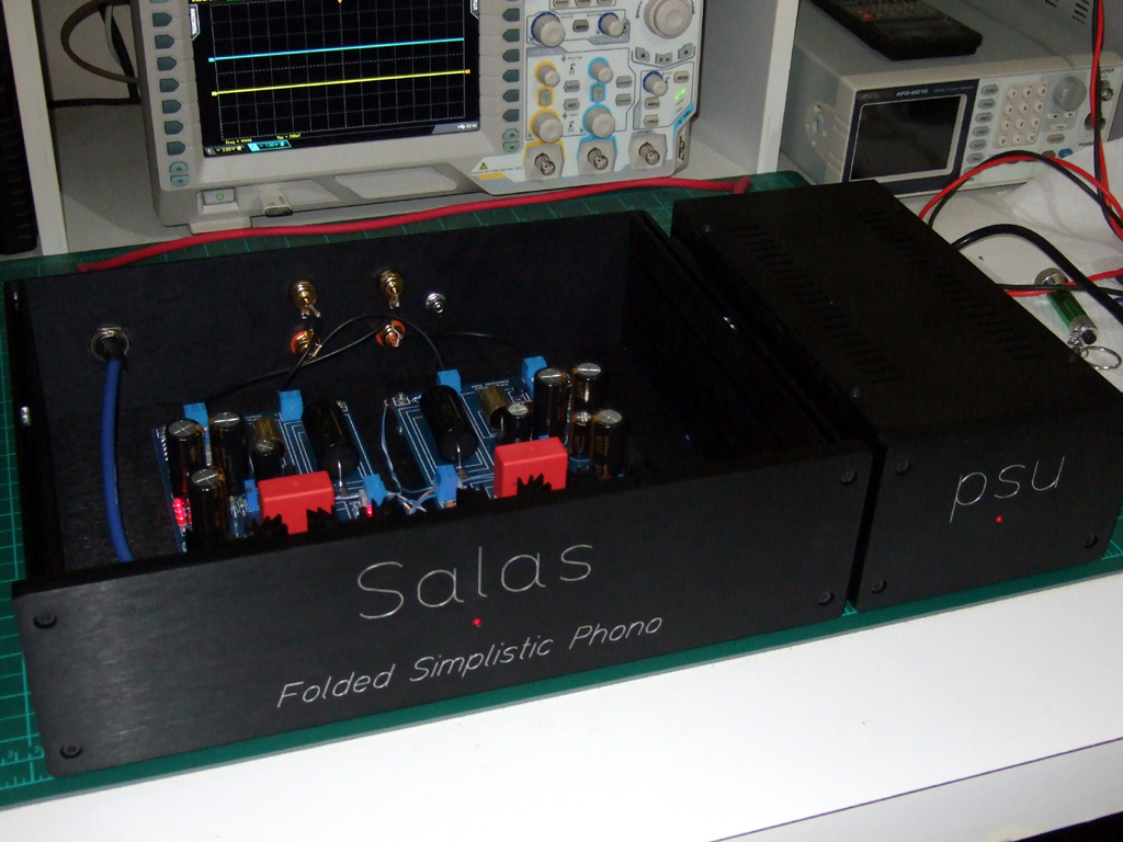

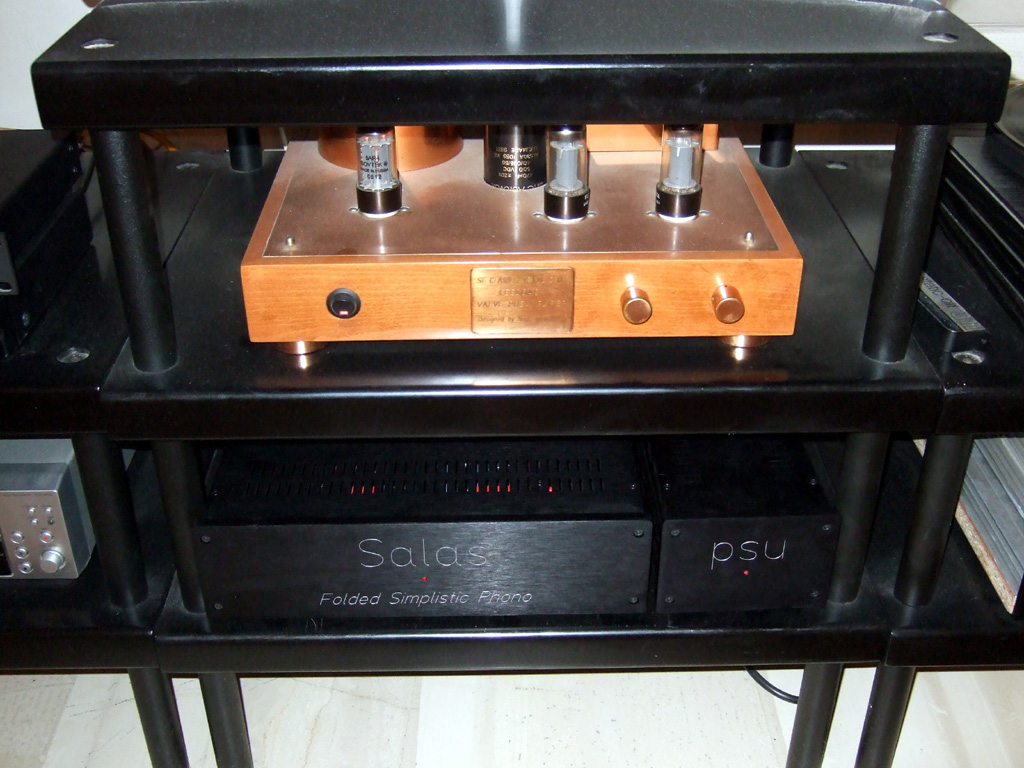

OK, don't shout, its here. :)
The young folded phono version on PCB is stable. I will send files to Tea soon. Listening to Bill Evans now, and I wanna run it in a bit more. Its performance proves adequate.

Thank you... I see I got it all wrong :)
Ricardo, this is a simplified tighter 1.1 type reg especially made for the PCB phono. So it does not resemble the general use ones and it can perplex you on first look. Even some values are tweaked. The boards quality proved very best by the way. No corrosion with handling, very easy to solder, and very tough.

Joined 2002
As it is biased, the Norton Vref in the regs has a red LED compensation for its JFET CCS and measures very stable after 5 mins of warm up. The input stage runs circa 75% IDSS and its also nicely stable. Just don't push the ambient temp in the box with hot rod ideas is the precaution so to avoid tipping the tested thermal balance. Making it as the assembly notes will describe its enough to stay care free. I tested it for many hours in hot summer room temps near 30C with its lid closed and it did not do funny stuff.
