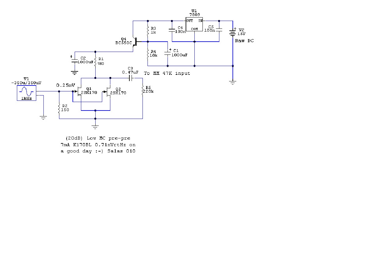

Low MC pre-pre
How much current draws the Low MC pre-pre? what fuses value between the PSU & the Low MC pre-pre?
Quite similar.... in fact I use always the same value as a ballpark.... tunning by ear is needed in the end.
Tuning the RIAA components by ear, RCruz? :confused:
So it sounds right to you .. or so you get the RIAA response curve to within, say, 0.2dB?
BTW, there are several well-reagrded phono stages - like the Allnics - which state a +/-0.5dB for their RIAA response.
Andy
Joined 2006
Hi Andy
If you follow the exact values indicated by Salas in his schematics, you do not need to tune by ear but, if you can not get the exact values, as it happens to me seldom, there is a need to tune the high freq cap (15nF) by listening.... I gather two or three different systems and listen to the builds... Then I collect info from the various listeners and trim this cap acordingly.... that is what I do.... But if you want to be technical, get a signal generator, an anti riaa circuit, a scope... and measure things.
Salas I've just seen the preliminary pcb design (post #9651)
Nice idea! A bit too compressed for my taste (I'd rather use 1/2W resistors), but interesting indeed. (As you might know I'm presently making my own with SSLV1.2R on board)
I noticed that the cascoding bjt might be different: two dissimilar pin out. Are you going to replace the 560C or offering a second option for that?
