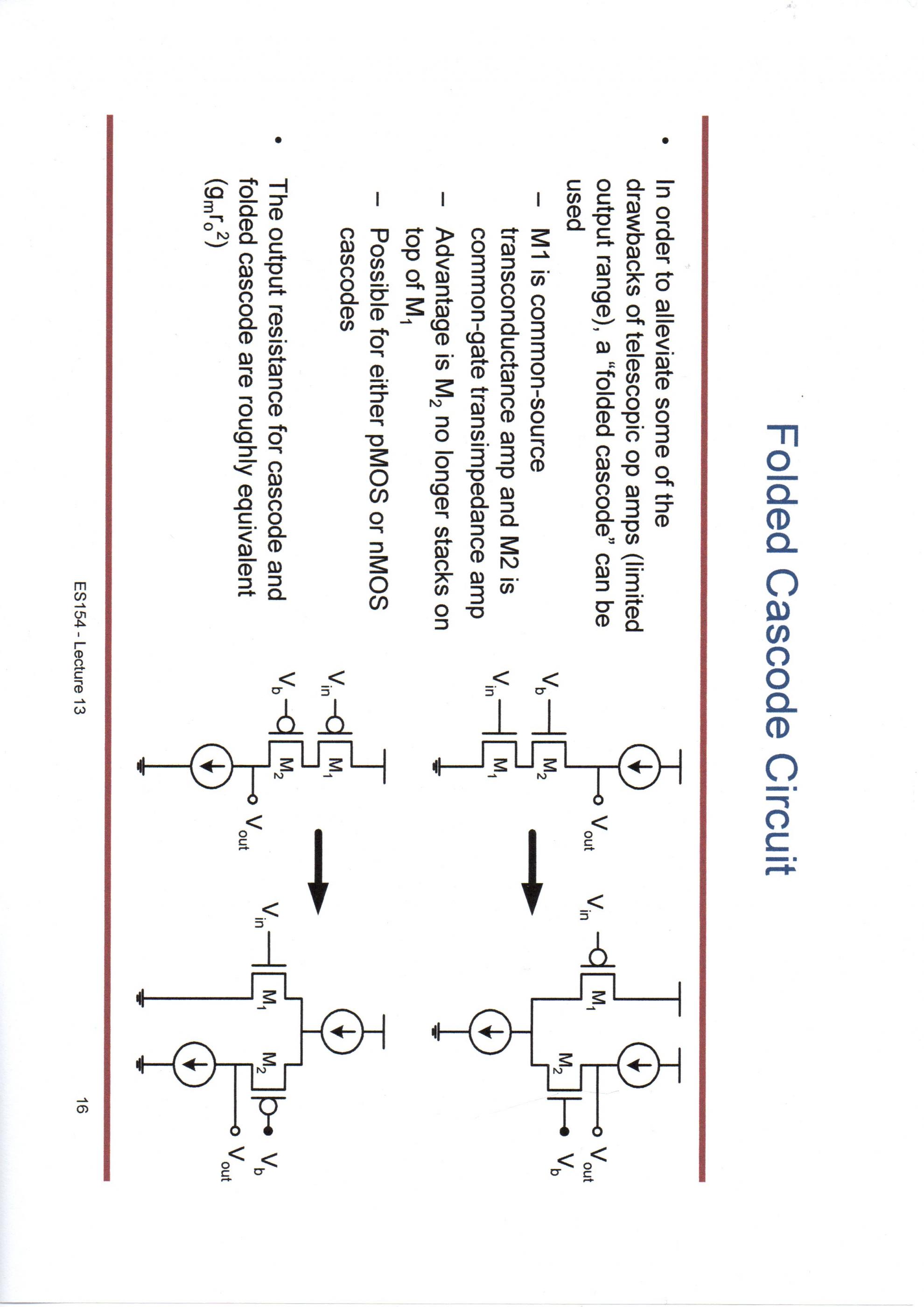

The folded cascode provides higher output swing tan the telescopic at the expense of power dissipation.
