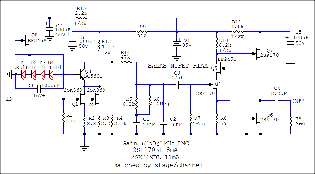

The conversion was a total success. Just finished modding my 48dB 28V reference build with the new folded cascode input, running at 35v.
As for repeatibility so far so good. Ultra low noise, ample gain and sounding even more dynamic than the "Wallis experiment".
I did not touch the riaa filter (just adjusted the 47k to suit better the 2k2 folded cascode load)
On second stage I use 2k2r feeding the buffer so I get 10v out of second stage and 20v over the buffer. (I had to build a BiB to power a breadboard where I reproduced second stage to find the best resistor combinations)
It is sounding really serious right now....
Pics latter :)
Learning question: How high output can I choose for a cart with this configuration ?
What happens If cart output is too high.. clipping ?
Why did it not happen with the "normal" simplistic ?
Its a matter of the signal not exceeding the VPP bias capability across the input stage load. Since Riaa has about +20dB at 20KHz, it depends on disc modulation and transcription tracking distortion. The "normal" has a telescopic cascode that leaves more choice for upwards voltage biasing. I.e. It will happen on any when mismatched, but here it can't be very flexible. I have installed the folded at 58dB gain with the 0.9mV Goldfinger Statement cartridge and it did not clip or latch on pops with heavy cut 45RPM special reissue discs. So up to 1mV nominal carts should be safe. I would prefer circa 0.5mV which is designed for, so to stay on the safe side, and have optimum THD.

This one?
