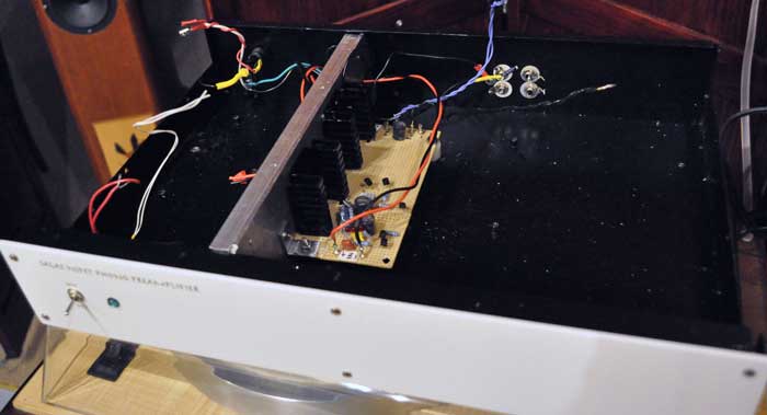

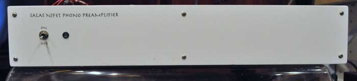

I am winding up things chassis-wise. Here are a couple of teaser photos. I will post some more in a few days.
First learning experience: I had a bolt through the toroid trafo that touched the chassis. (I've never used a toroid before.) Had a 20 volt difference between circuit ground and safety ground. I'll get a nylon bolt.
Dumb question: where can I hook an indicator LED without messing up the circuits? The resistors I have in the raw PS drop less than a volt.
Thanks. More to come.
Doug
