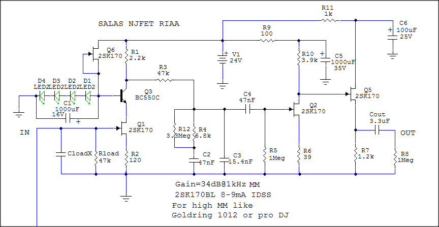

I have a goldring 1012x mm cart which has an output of 6.5mv at 5seconds which is really high. Which of the low gain versions would be more appropriate? Given the really high output of my cartridge would the 38db schematic be appropriate or could I lower the gain event further?
At the moment I use the integrated phono stage of my rega brio r amp, but I rarely pass the 10 o'clock in the volume as the overall gain is too high.

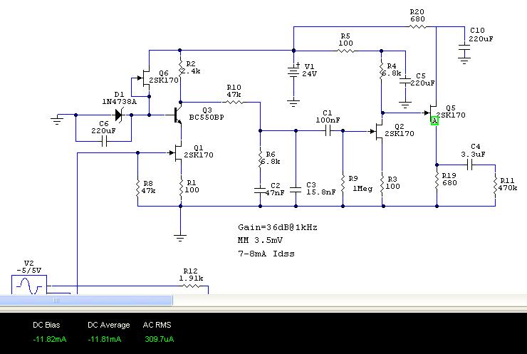

36db-version 7,0-8,0 mA IDSS Post 417 MM 3.5mV

That's a rather special category, make this one that will fit better. Your Brio R has 40dB, thus 6dB less will fare better on the volume knob.
