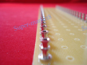

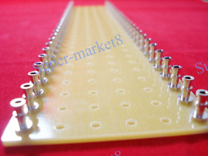

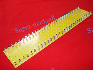

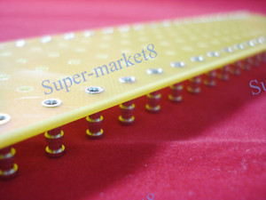

Turret Board Si.
Hi Ricardo
This is the 'turret board'.
Also sometimes called a 'group panel'.
Most people use this for high-voltage stuff.
Often find it in 50s' 60s' guitar amps, before PCBs.
The board in the pics is 60mm x 300mm & has 2 rows of 30 turrets.
The spare holes are on a 10mm pitch & you can get spare turrets, which you just rivet into position using a centre-punch & hammer.
Not much good for Op-Amps !
But I think it's great for discrete stuff like regs. or the simplistic.
It also comes in larger perforated sheets, so any size is possible; just rivet in your own turrets.
Glass-fibre or Tufnol.
What I like about it is :-
You can solder components across the turrets, without cutting the leads short; good for experimental values.
Can wire interconnects below-board for neatness or above for visibility & ease of access; you can work on turret boards fixed in a case without removing them to get to the back.
Also good for mounting chunky bits like ex-Soviet military capacitors.
Wires can also be laced through spare holes, to relieve tension on solder joints.
Blurb...
...blurb...
Blurb...!
You can tell I like the stuff, yes ?
One row is often used as the ground row & the top the live row.
Just rivet in extra turrets in between, where you need them.
The whole thing can be laid out just like the schematic in fact, with all wiring on the surface which is easy to see & solder.
Try it out it's Grrreeeaaatttt !!!
Cheers
Si.
PS...only about 0.000000001 pF capacitance ( we hope ! )
