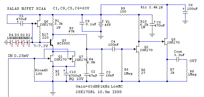

Simplistic NJFET RIAA
Polysterenes are also very good, RIAA caps important thing is tolerance & accuracy as stated by RCruz. If yours styrenes are 1% surely sounds better than teflons 5% or more tolerance.
I'll be measuring and matching them as my meter can measure capacitance. I intend to match the 5% Teflons up using low-value polystyrenes. Hopefully the Teflons will be here in the next couple of days so I can get on with the build.
I have just read the pdf on the HiMM (great info by the way) and need to check with you about matching the fets.
In the range 8 to 8.5mA:
I have 4 at 8.4mA. So these could be Q1 and Q2 (two for each channel).
I also have 2 at 8.3mA. So these could be Q3.
Finally I have 2 at 8.2mA. These could be Q5.
Have I understood correctly?

One question- Is there any way to get a few more db out of the circuit, apart from adding source bypass caps? I built the MC RIAA 8-8.5 idss from your Document version 11.02.F0.
I do have some more matched jfets in the 8.5-10mA idss range. Though I gather the RIAA values would need to recalculated.
If hard to do, I'll leave as-is. I just like running straight w/o a line amp, but could go that route if needed.

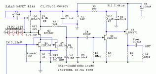

I want to increase the gain +6 dBs, I'm using this schematic without C10 so instead 63dBs I have 57dBs, wich one will be a better solution:
-Partridge 977 1:6 15dBs step up, what I have to do about load resistor? I have to take of 150R from Simplistic & adding a resistor at the ouput of the step up, I don't know how calculate?
-Salas active pre-pre 1:10 20dBs, I don't know hows but I think it need to be modified because will be connected to MC instead a MM and also is the load resistor, I don't know how calculate?
-Make a new active pre-pre for only +6 dBs?
-Using Sowter 9395 autoformer attenuator and utilize its +6 dB gain tap as suggested to Kent?

What I suggested to Kent was for output volume control straight to his amp along with gain at output. Useless at input side.
For 63dB you make the pre-pre and himc chained together. No individual circuit or pre-pre to 57dB matches. Unless you can compromise to a capacitor bypass on the one you already got.
