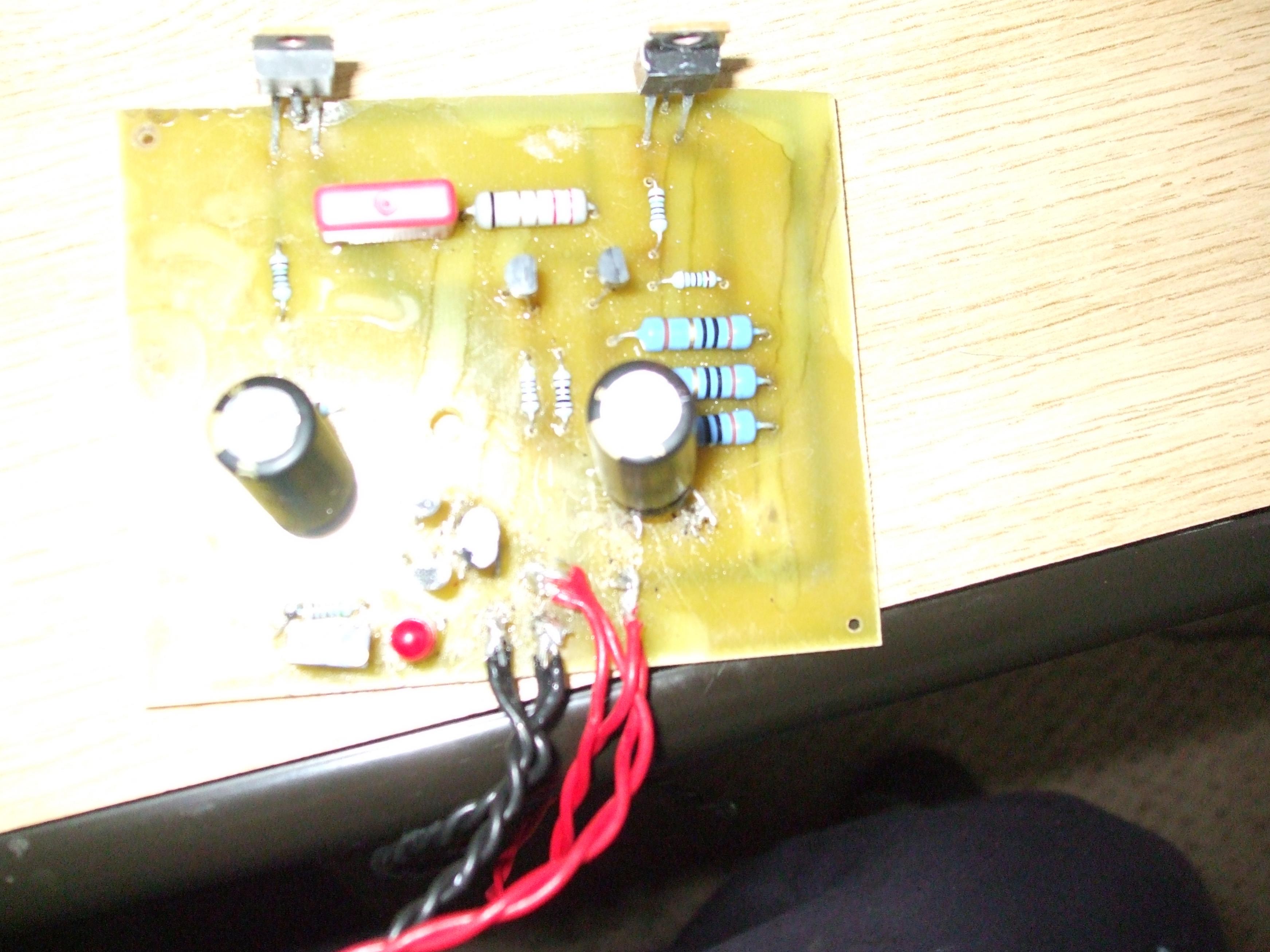

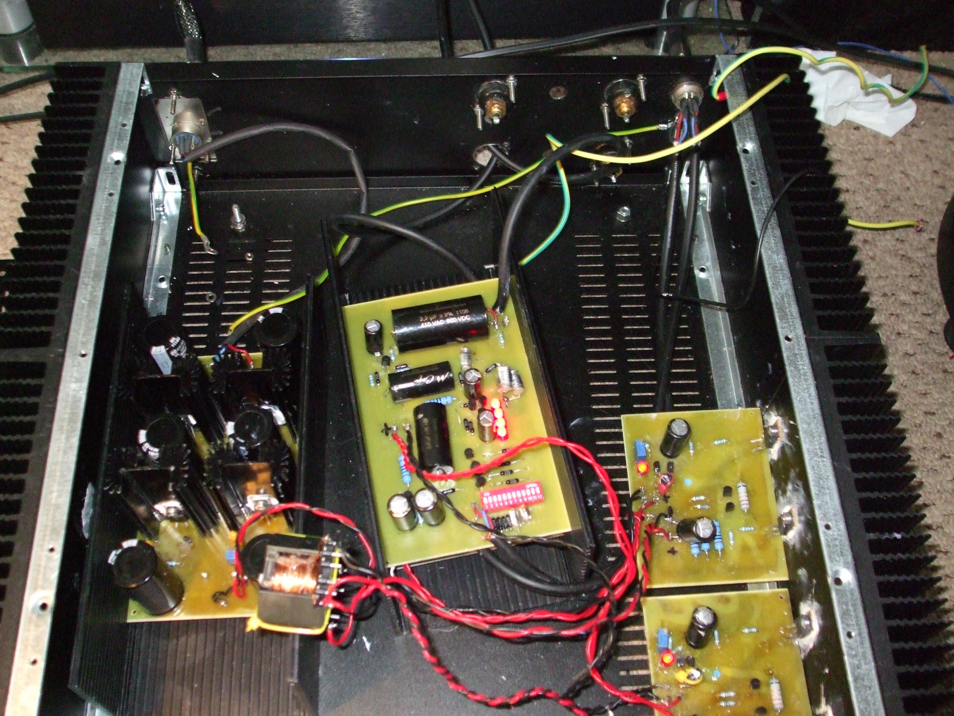

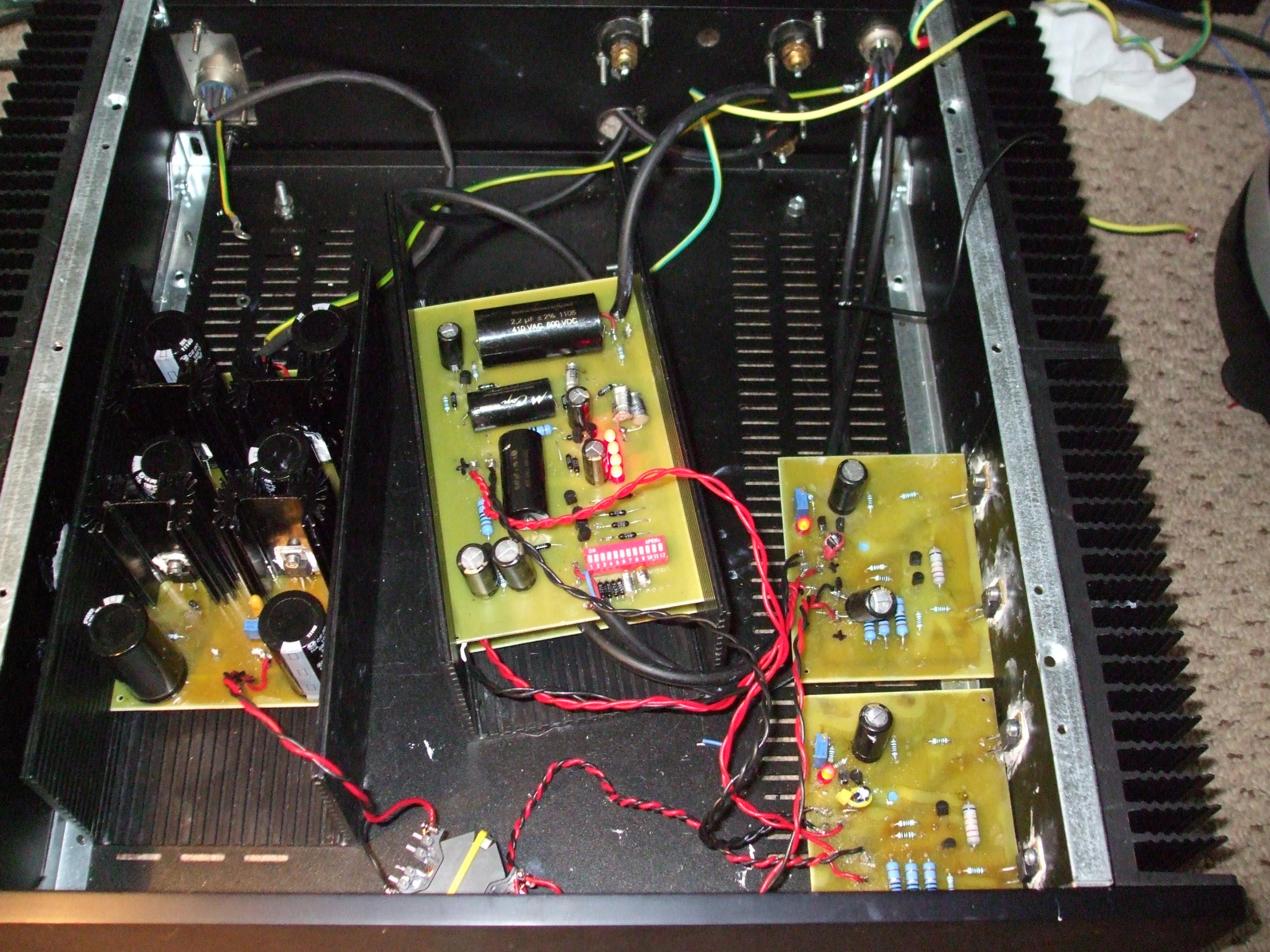

I made the thing and it worked first time.
I am using 24 V suply rails as I was going to use bateries as suply.
And it sound good.
I am shure proper version sound even beter
I am using 4 J fets with 33R source resistor for each
did not bother with the regulator I just put the transistor bit on it.
If I managed any body can thats for shure

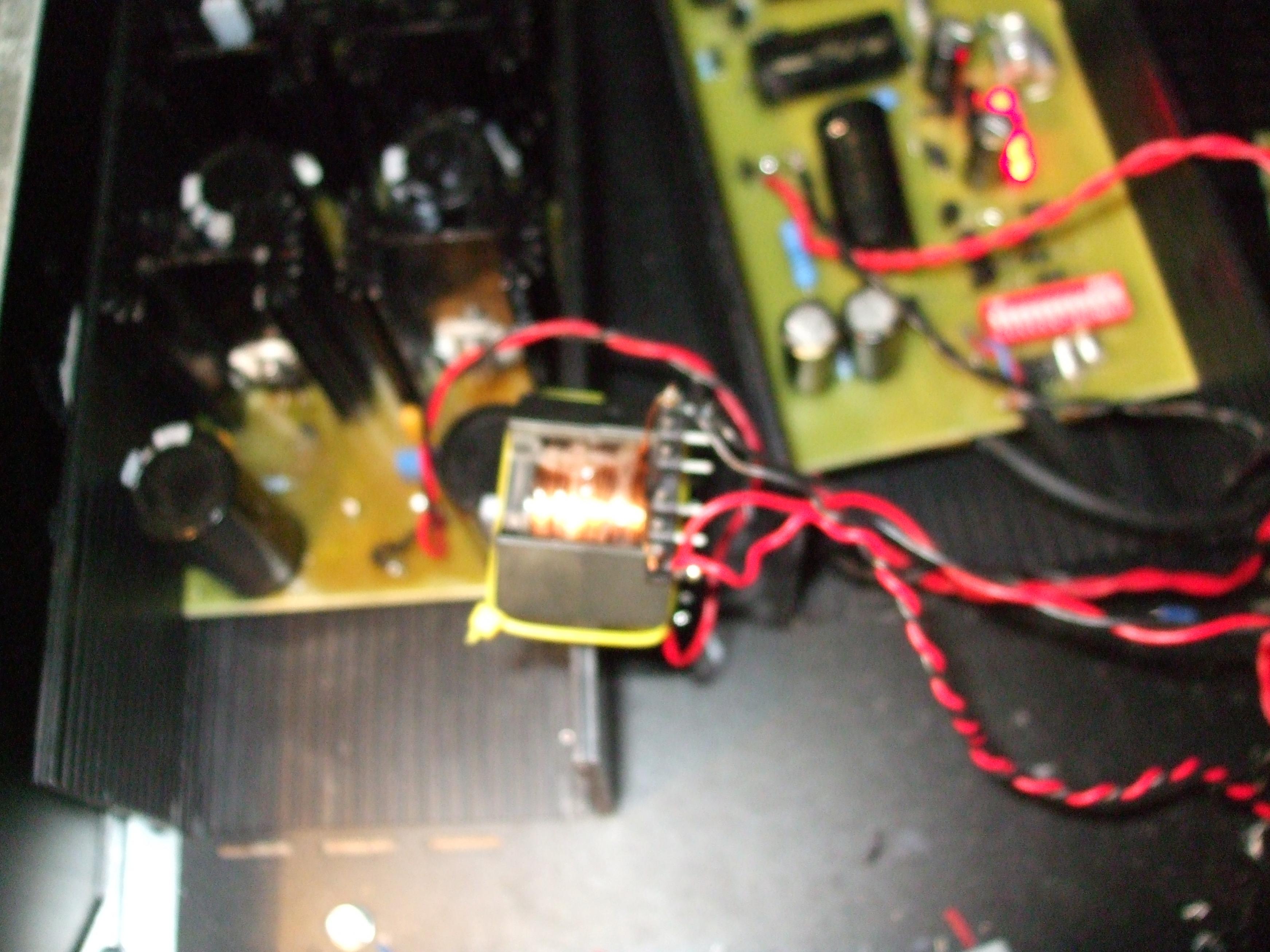

A Bit of progress on my side.
Maybe it shuld be on reflector tread ...
But the 2 go hand in hand so nicely
I just had same IRF640 and replaced the IRF610 on the reflectors.
Much much beter now much more stable.
I have also taken of the 1u MKS and changed them with same EVOX .68U they are a bit big so soldered on the botom of the board
Big difference there if you trow money at it start here
The sound stage is much more solid a bit brighter Hi frequency maybe.
A uge improvment.
I am now going to build the proper one but before I do that I will listen to a few traks while I write what is on post 7143 100 times .
I had same trubles whit the power suply before the Reflektors but got oround that with sometink I have seen on another tread.
I have fitted a common mode coke at the output of the 317 Regulator board.
Not ideal to start with a poor power suply but maybe it could help
