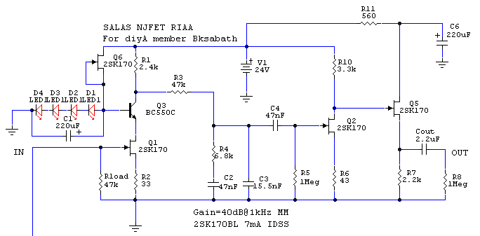

To put it in a nutshell, your needs are: 1. To use an existing 24V DC regulated supply. 2. To combine a pre pre and MM circuit if that can be the ticket for not exceeding the 24V supply limit. 3. To use LSK170 Linear Systems. Agreed?
If yes, tell me your cartridge and I will give you a schematic for MM at 24V supply to combine with the pre-pre from the PDF phono guide. You add a stage and a coupler, but you get 2 sensitivities as a bonus and you can use your 24V reg. Linear Systems parts are quite OK as I learn in the forum, me I never used any.
diyAudio Chief Moderator
Joined 2002
OK. Make this one attached and combine the pre-pre from the PDF guide, there is a link for the guide in post#1.

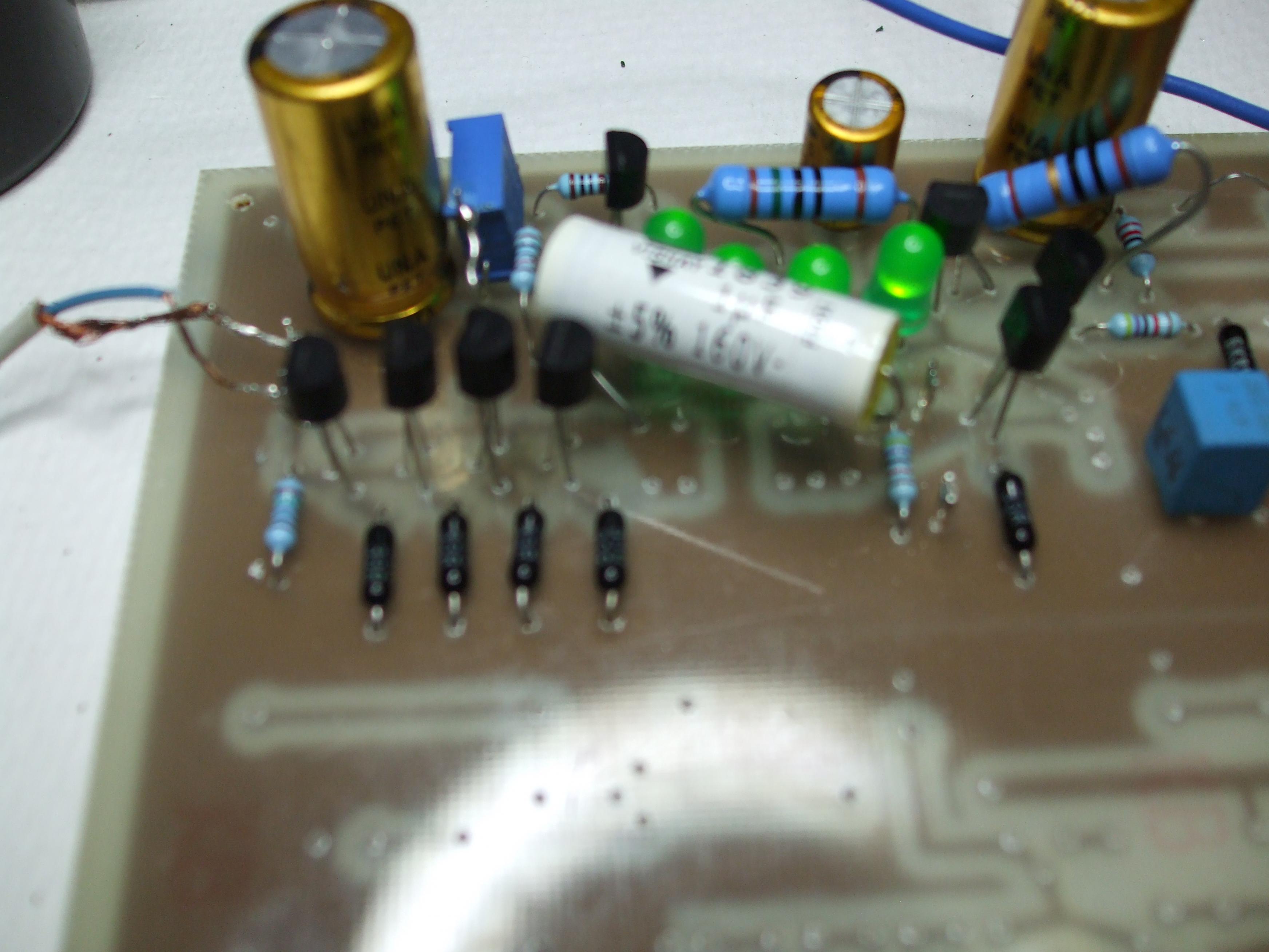

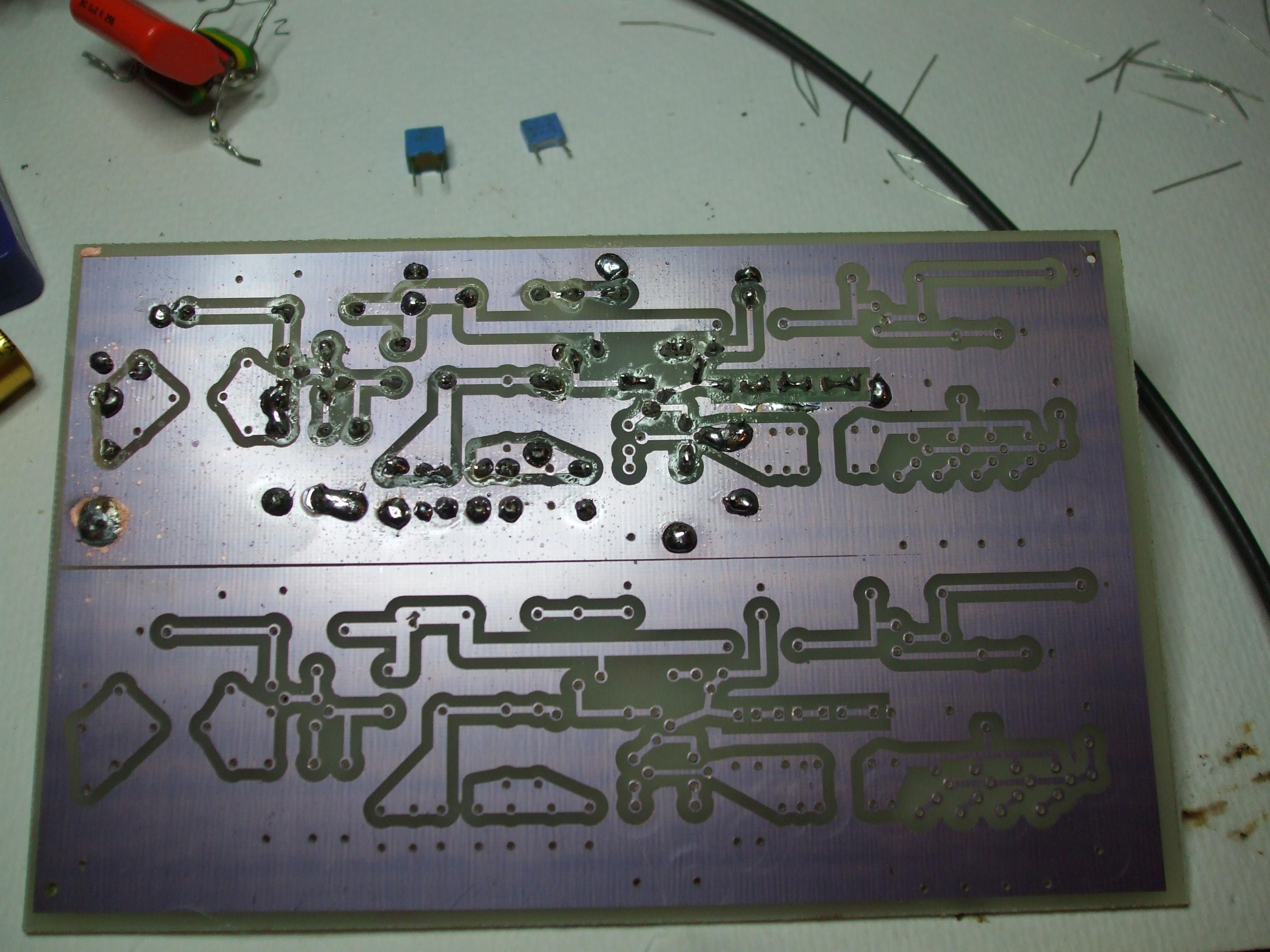

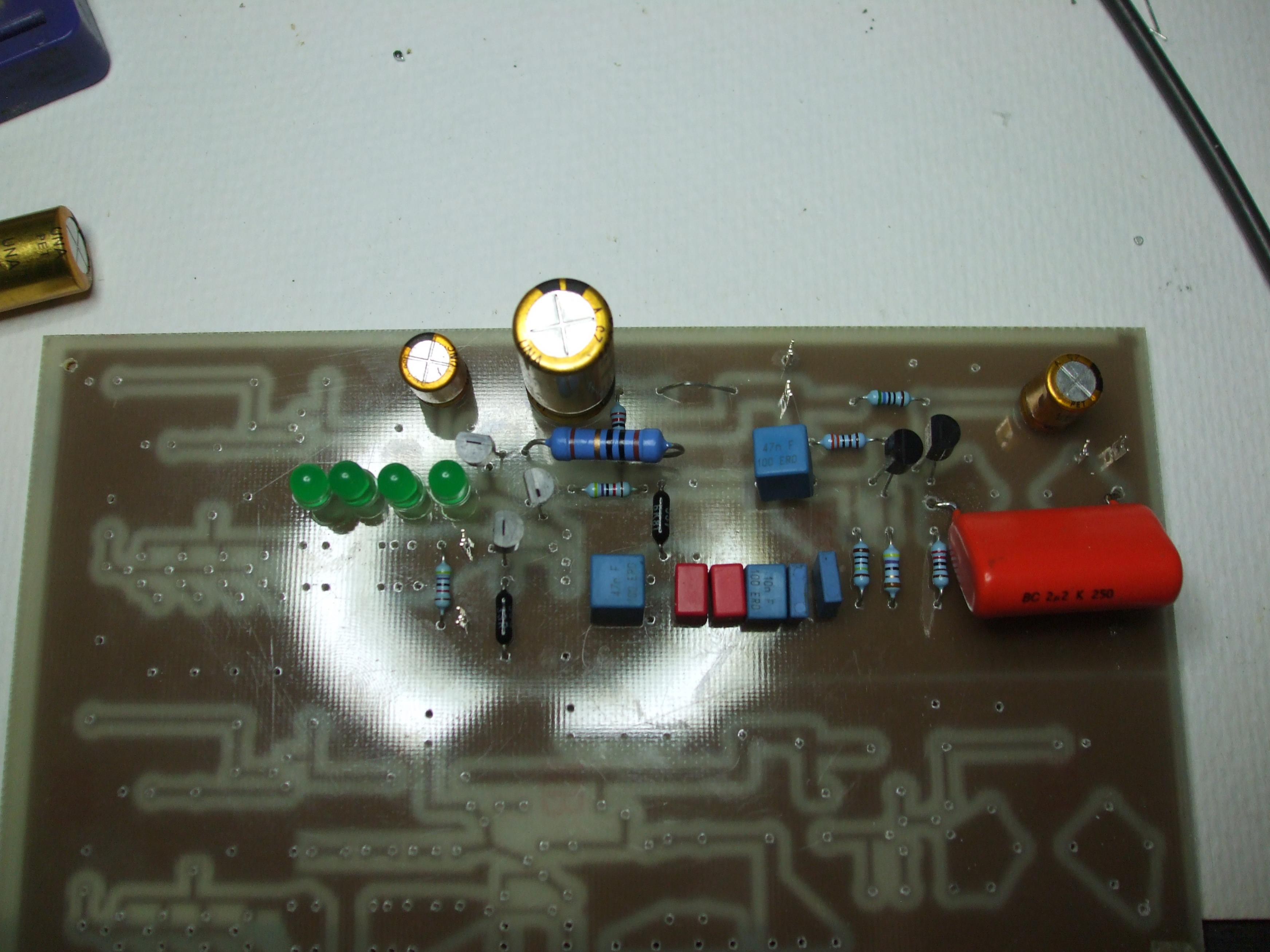

First draft of the PCB stuffed whit what I had available
No matching of measuring of any components apart from the RIAA caps
I have on the board extra space for the prepre and such
The board is built to fit what I have already size is 100 X 160 mm
2 channels on one PCB

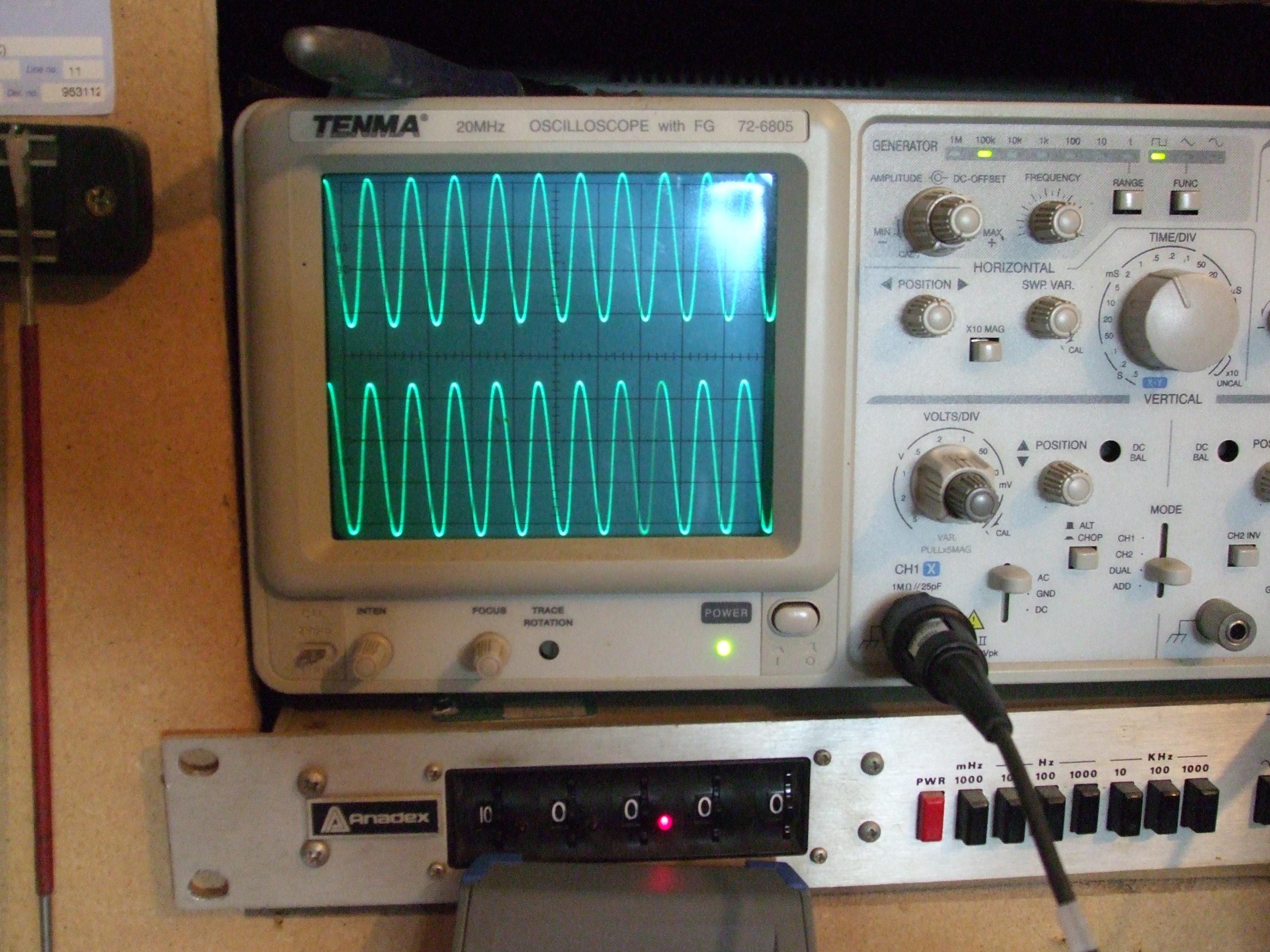

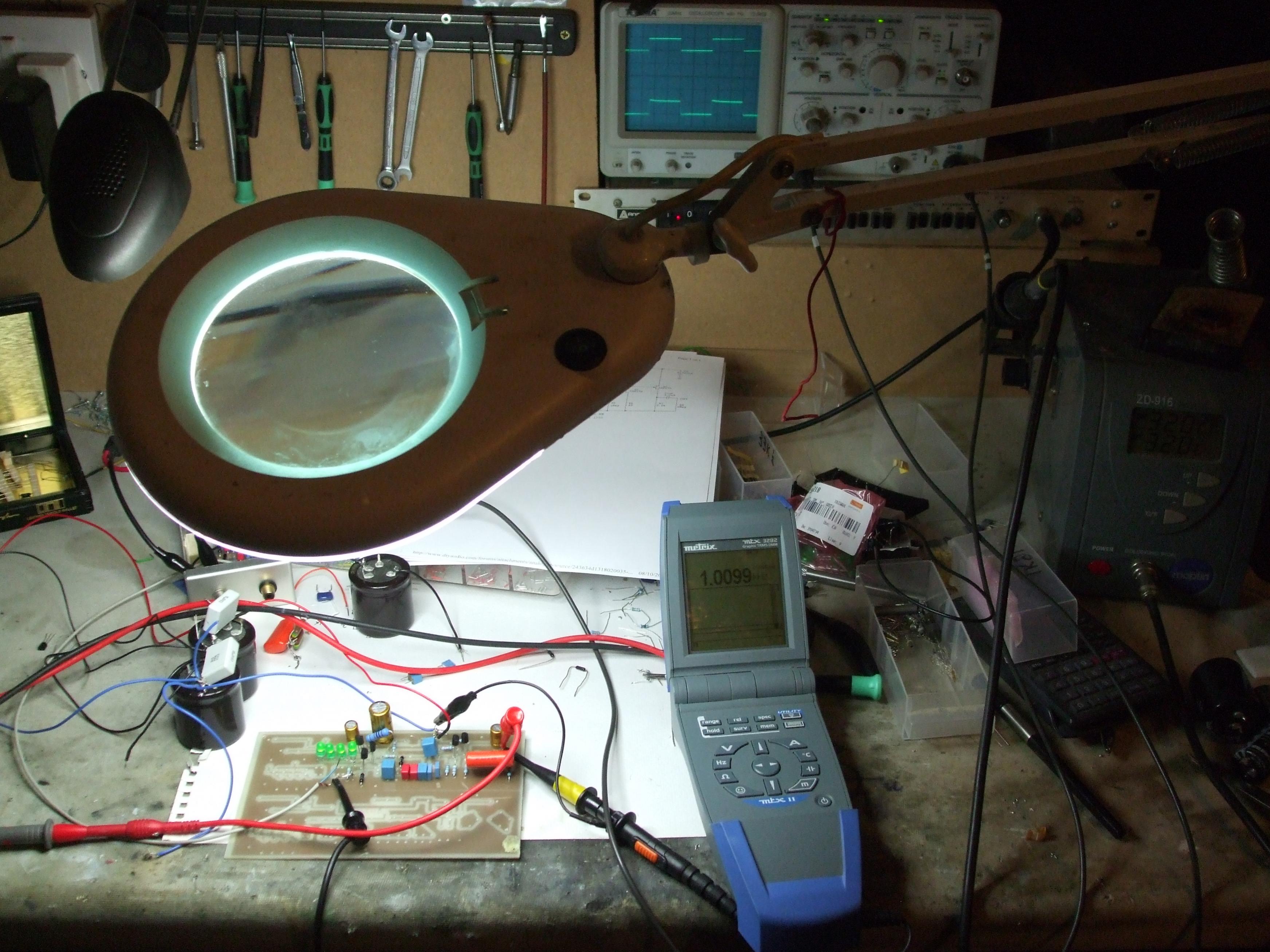

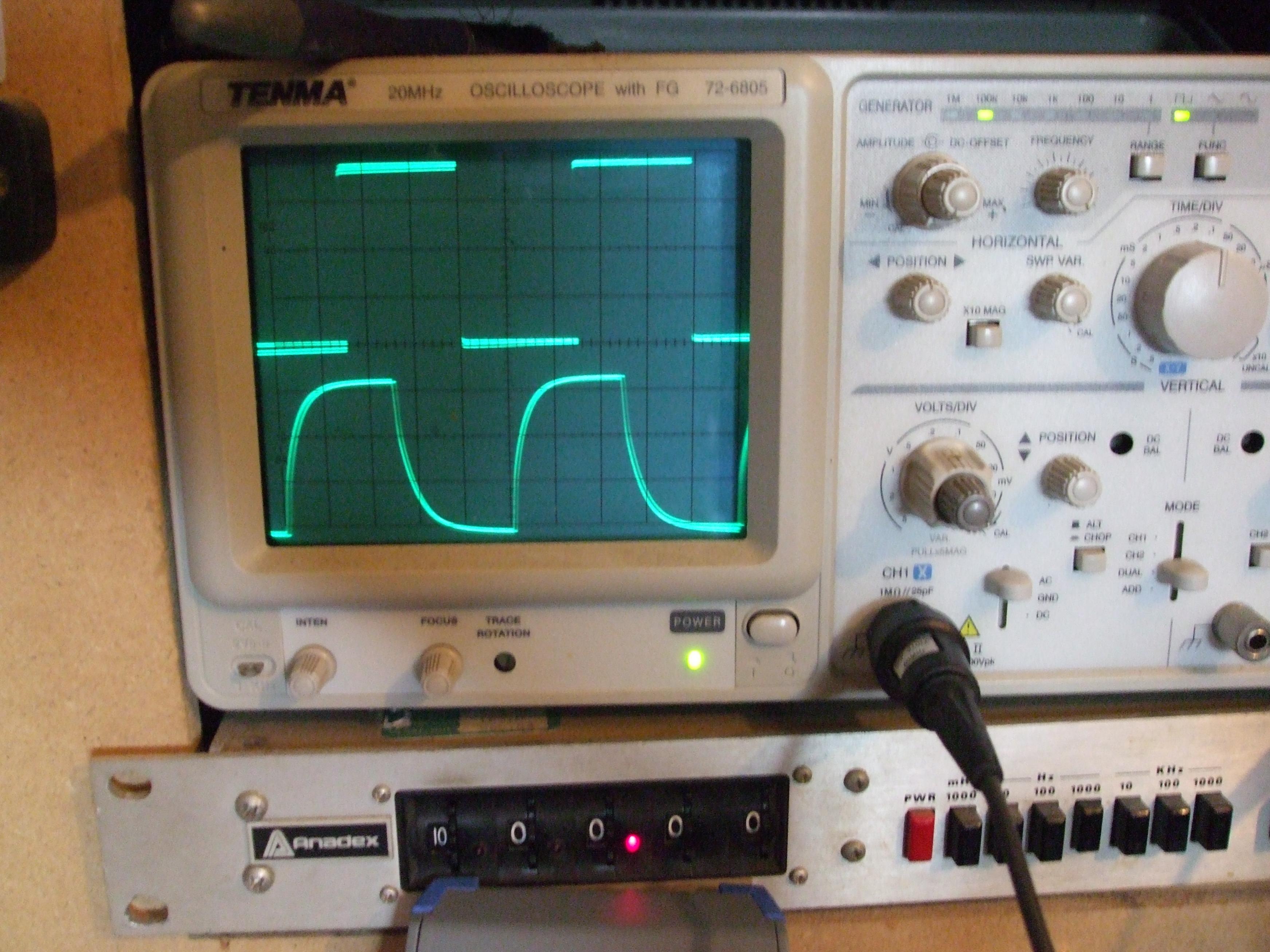

The circuit worked straight away is open on the bench and that magnifying lamp with is neon tube does not do any good to the signals
The supply is my little LM317 bench thing no think special
Same all for the anti RIAA filter just the open box no grounding just bits of wire and crocodile clips for now.

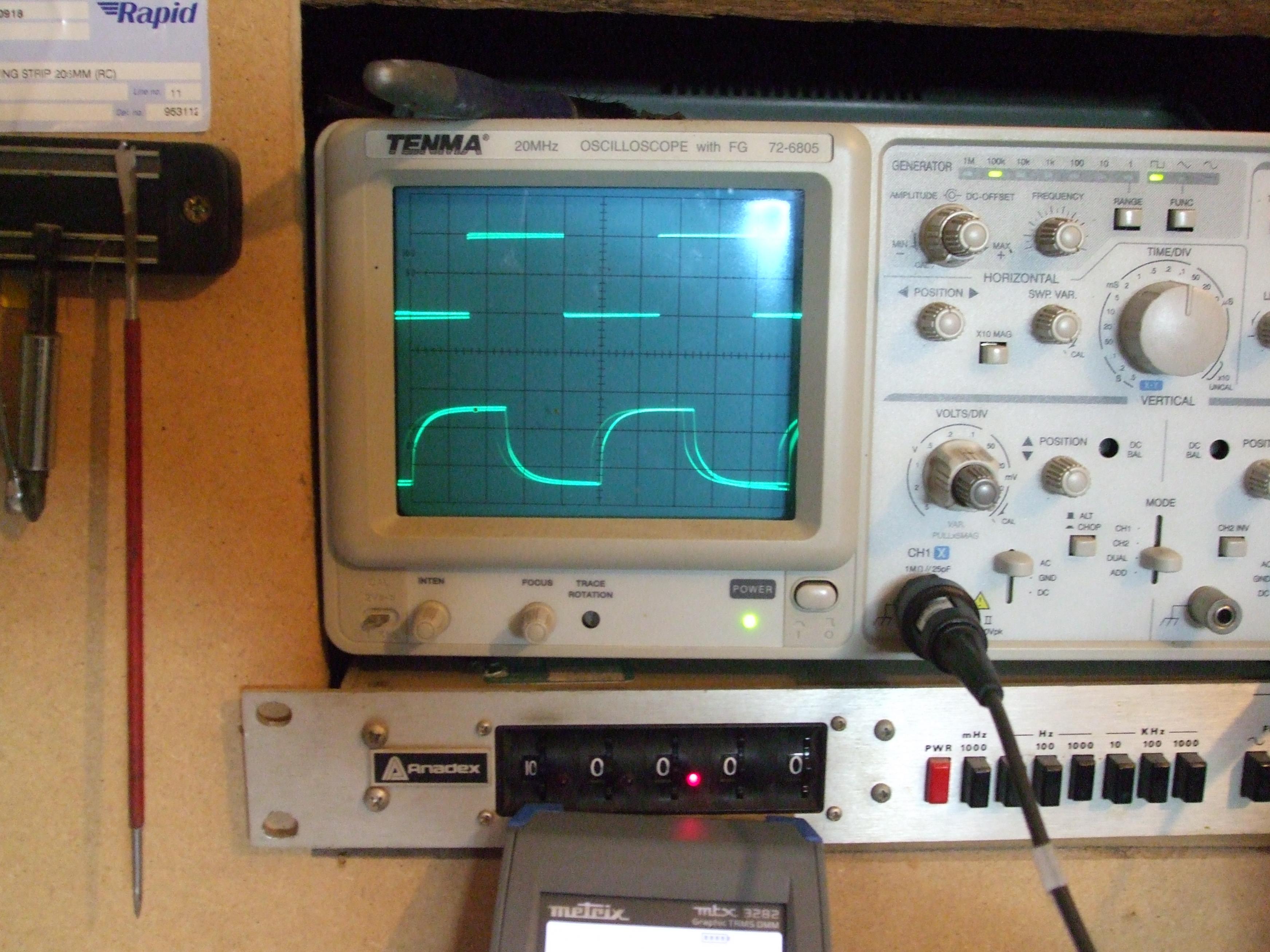

I share Joachim Gerhard opinion that if a square wave looks pretty the circuit should sound good
IMO In all honesty this one (not my effort nothing much there is all Salas merit)
Is one of the prettiest I have seen in a long time please do not forget is all open on the bench and the crapyscope look much beter than what camera and CRT combination shows.

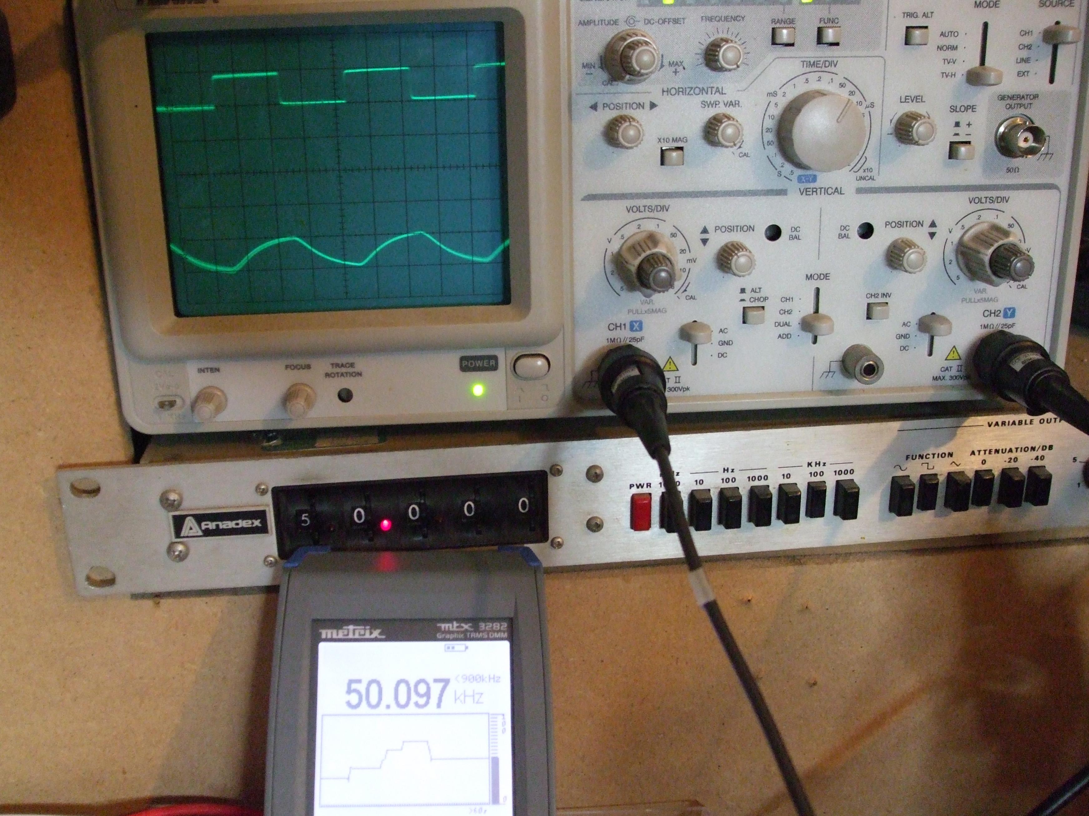

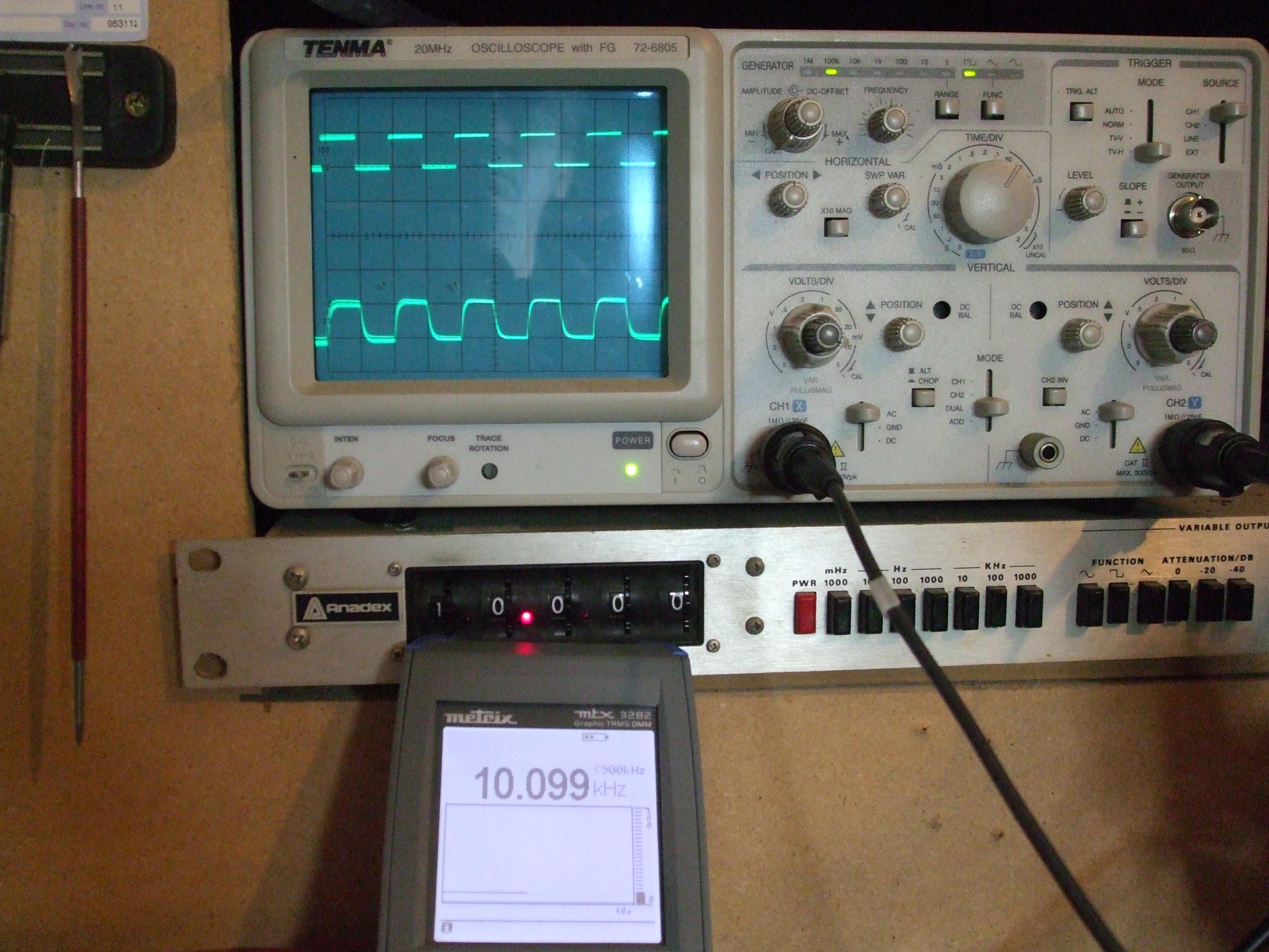

Top trace output from SigGen
Bottom out from Simplistic after signal has passed trough the anti RIAA filter
1 KHz 10 KHz and 50 KHz 1 V divisions

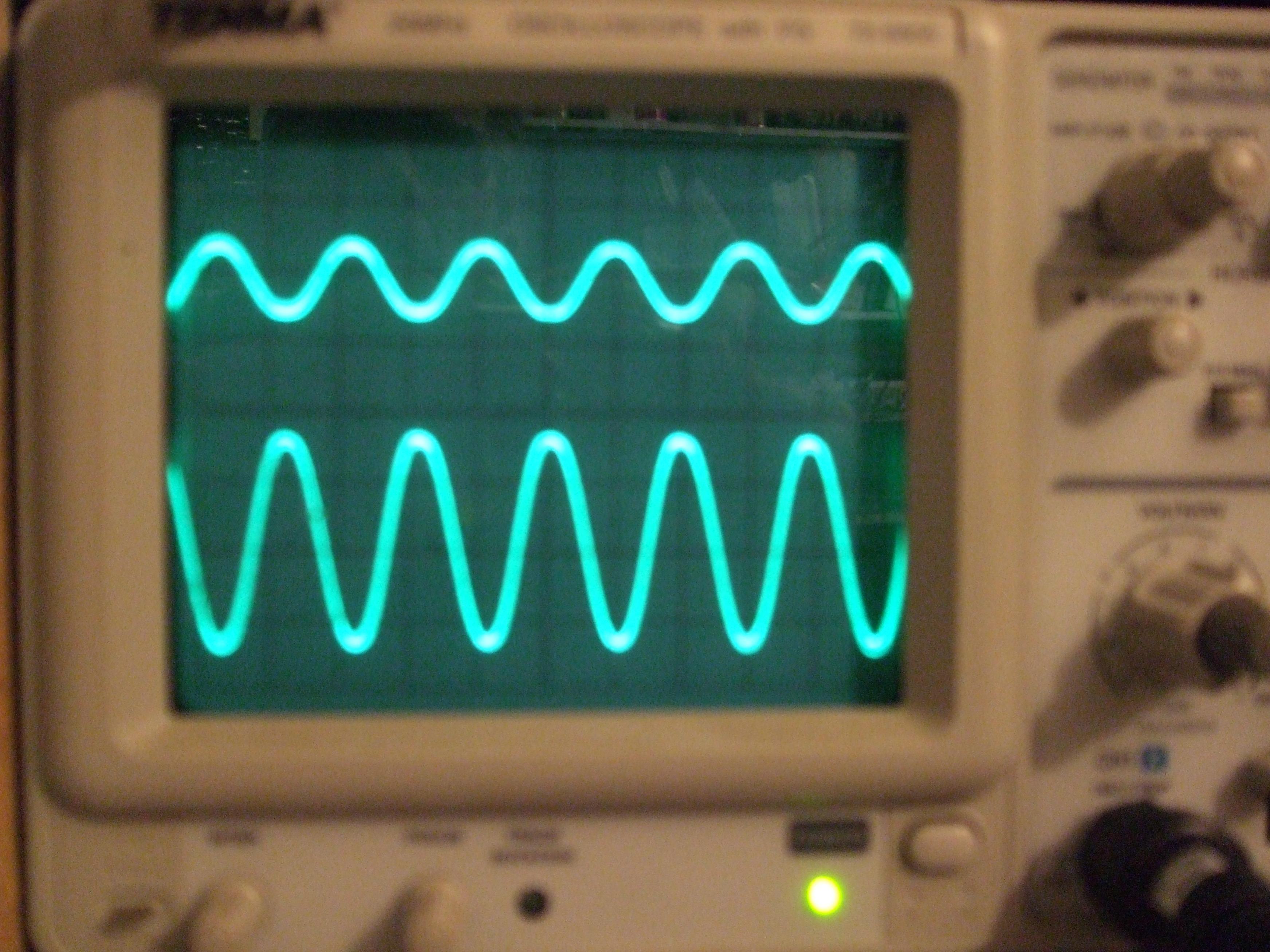

1 KHz sine and 1Khz Square at 5 volts division

Yes the sine is vell over 15 V peac to peac on a 24 V suply same for the Square
and last one is 10 V gosting duble immage is CRT and camera doing.
Must say I had a good look at a few more at about 100KhZ signall started to srink a bit
But 100 Hz look perfect (crapyscope no good for picture there)
IMO well worth spending same more time and maney for same fancy caps and proper red LED (sorry only had greens).

Pics from course of work are always nice. What circuit you measure exactly? The MM one posted above, or the different IDSS MM one from the PDF? Keep in mind we use straight Lipshitz in this one in case you got any extra time constant arrangement in your inverse Riaa.
Tanks Salas
I am measuring circuit as you kindly posted for me on 6832.
I will need to dig out Anti RIAA circuit.
OF top of my head it is the one with 1.91 K 511K 42sometink K 536R and 60R
MM input was taken at top of 536R MC at top of 60R 40 and 60 dB attenuation
Sorry I am so very untidy I had that in front of me for past 3 years and now that I need it again I can't find it
I will post exactly the circuit and source where I got it from as soon as I find it

I have stuffed the boards with the MC prepre components as on SCH attached.
I have tried to increase gain at first with extra 2SK170s and it did help a bit then placed a pot in series with R1.
It is all still on the bench unscreened and such some how I know already that this is going to stay in the box for a long time once finished.
The RIAA prepre page from your write up
On the board a 150R 3W instead of the 7809 supplied by the 24 V rail
Gain after passive RIAA attenuation (60 dB) with 4 parallel 2SKS R1 =200R
It was 180 on your drawing
And Gain with R1=750R (using a 10 turn 1 K pot)
The source resistors are 33R again is what I have at the movement
Please remember that (for all in general) that I do not have much of a clue on what I am doing so it is easier to put same extra track and holes on the PCB and get rid of it later.
The amazing thing is that it worked the first time.
